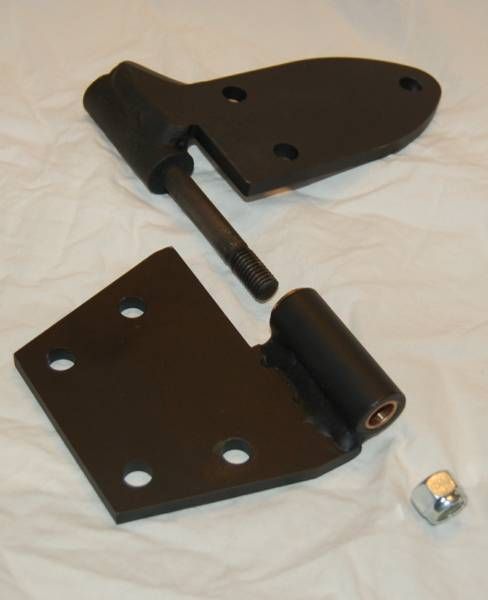

Are you planning to take your doors on and off a lot? One of the vendors (Mathew) came up with Quick Hinges which might be easier to make work. If they were something you’d want anyway, I’d switch... otherwise stick with what you have.
You have just taken my PITA job and made it simple. I am going to take the body side of the hinge and cut the two tubes off. I will get some new tubing and weld them back on raising them up 1/2'. I will order a set of brass bushings and that will also take care of my extremely worn out hinges at the same time. Thanks man. I owe you one.
I’ve used 3/8 OD x 5/16 ID ‘Oilite’ bushing to refresh my hinges. They work great and should never wear out.
