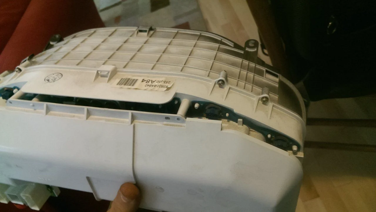

I started by tracking the beeping to the upper center area of the dash. I started removing things, the plastic skirt and the heat shield. This allowed me to determine that the noise was coming from someplace behind the instrument panel. I removed the panel and the beeping stopped. It made sense to me at this point, since I couldn't see anything in the area that would house a speaker, that the device was probably inside the panel itself.
I have to admit that I was starting to feel a little like the three stooges episode where they took the Generals car apart looking for the squeak.

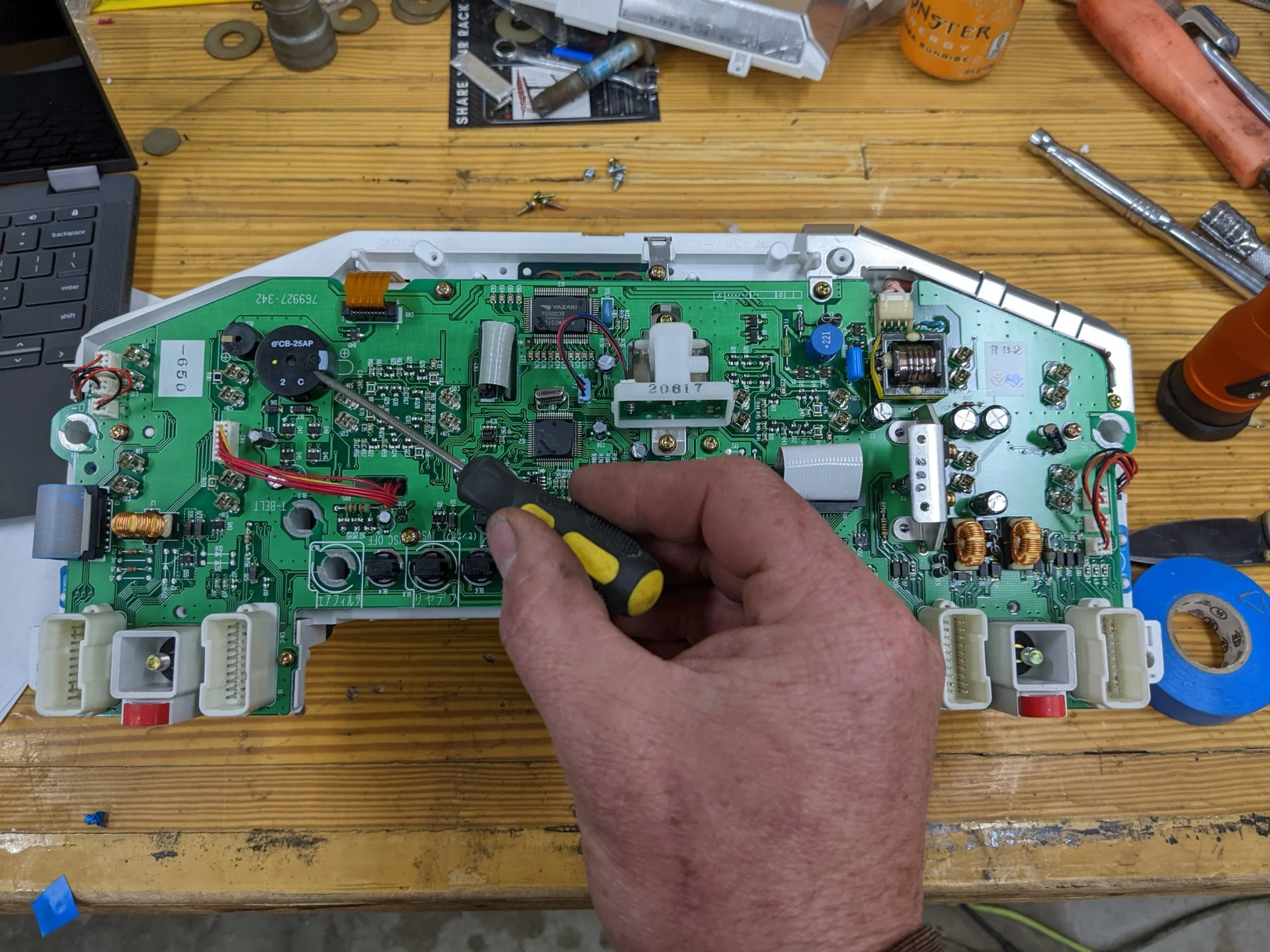

I pulled the back of the instrument panel off and the speaker was easy to identify.
I noticed a bunch electrical connections leading to this module and thought best to disable the sound making part of the speaker rather than trying to remove it completely from the board.

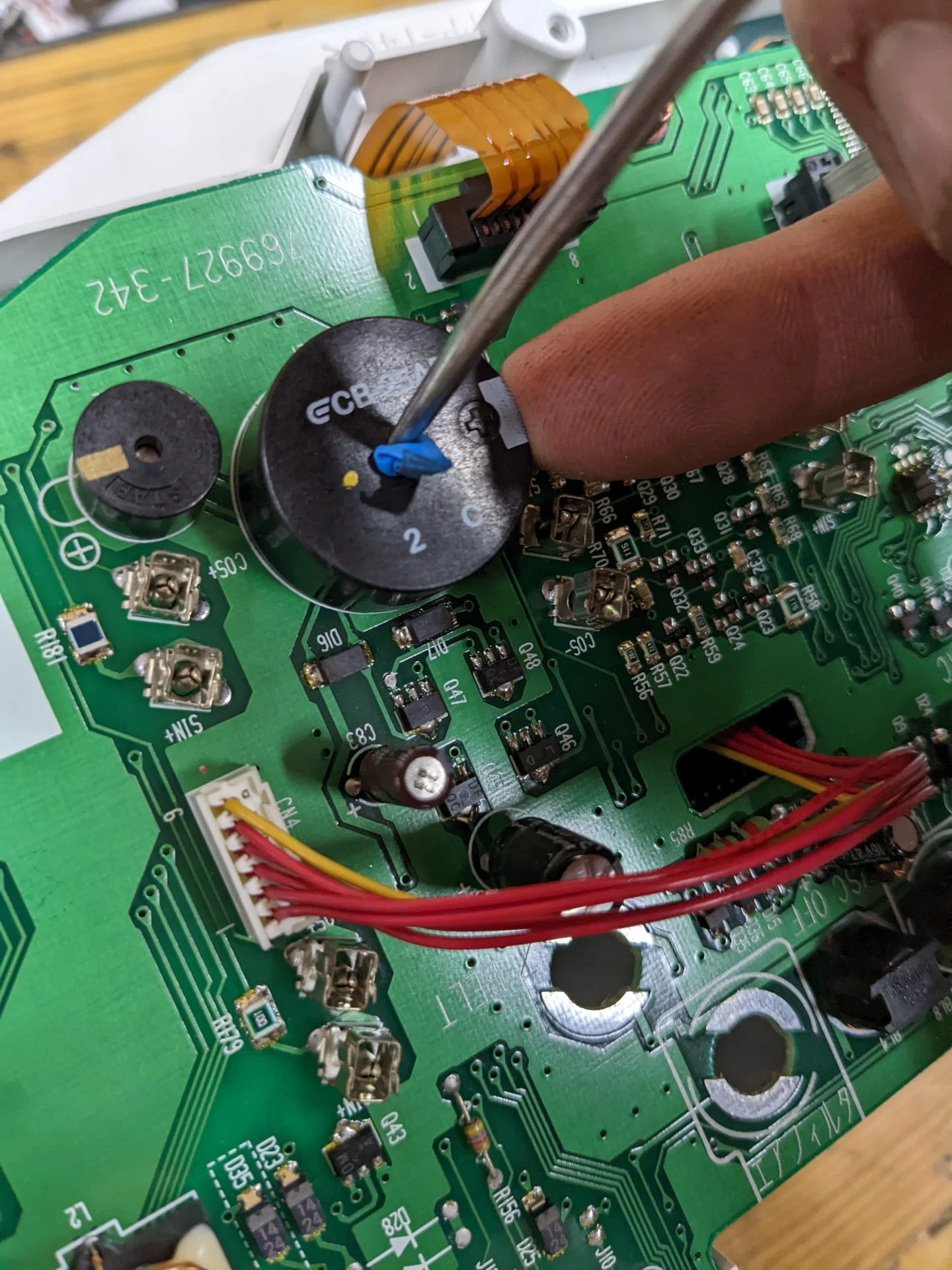

Using a pair of dikes, I cut away the plastic cover, exposing the metal speaker cone.
Then with a small flat head screw driver, I removed the metal cone, leaving the mechanical 'motor' part of the speaker intact.
Then put the back cover on the instrument panel and reinstall it. Success.

Thanks for this. The sweet silence of a dead door chime has been music to my ears over the last few days. As an FYI...it also works to yank the whole puck from the board with a pair of pliers.

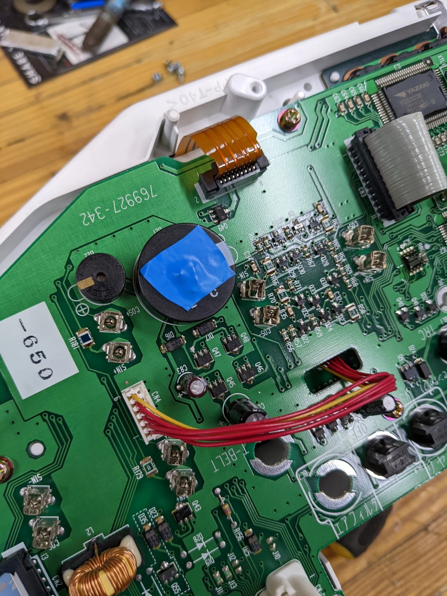

I have a 2002 LX470 the back of the instrument panel was a fuzz different so I thought I'd share. I also did not disable the speaker I just shoved a little wad of electrical tape down in the hole and covered the back with electrical tape. The beep is about 10% of what it used to be. Pretty easy fix and I won't go crazy every single time the keys in the ignition
