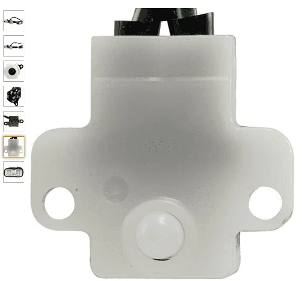

I had a similar issue on my IS300. I replaced the unlock warning switch on the ignition assembly and that solved the problem. The little clip that activates the switch was broken so the switch wouldn't activate. On the IS300 the switch could be replaced separately.
Looks like the same thing on the Landcruiser is 84450-60270, but don't take my word on this one. There are some good pictures on Amazon of an aftermarket part and the white piece with the little button looks similar to the IS300.

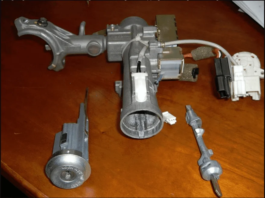

my question is, what triggers the chime when you insert the key? There are no electronics on the cylinder as far as what I can see from pictures in google.
I found this picture in the 100 series forum. It looks a lot like the IS300. The white piece on top with the two wires is the unlock sensor. There is a tab that extends into the ignition and when the key is inserted the switch is closed and the car knows the key is in the ignition.
My guess is that this piece on the 80 series ignition wiring does the same thing but not sure. If you remove the dash panel that covers the ignition switch you can probably look in a see what is there. It may have the same switch as above and I just couldn't find the part on Partsouq.
