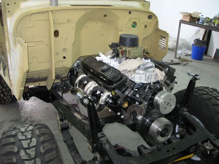

Donkey BUILD UP
more photos

All together, the drive train measures 37 3/4,
the Australia 5-speed + 3 1/2,
the Ranger Torque Splitter + 7 1/2,
in my case, I moved my transfer case 2" forward,
it means I have to shorten my front drive shaft.

,it is a new H55 Transmissione and a Ranger Torque Splitter (Overdrive),
I have moved the engine so far forward, the Water-Pump-Pulley
is there where normally the Radiator is,
I moved my transfer case 2" forward to, I almost run out of space,
