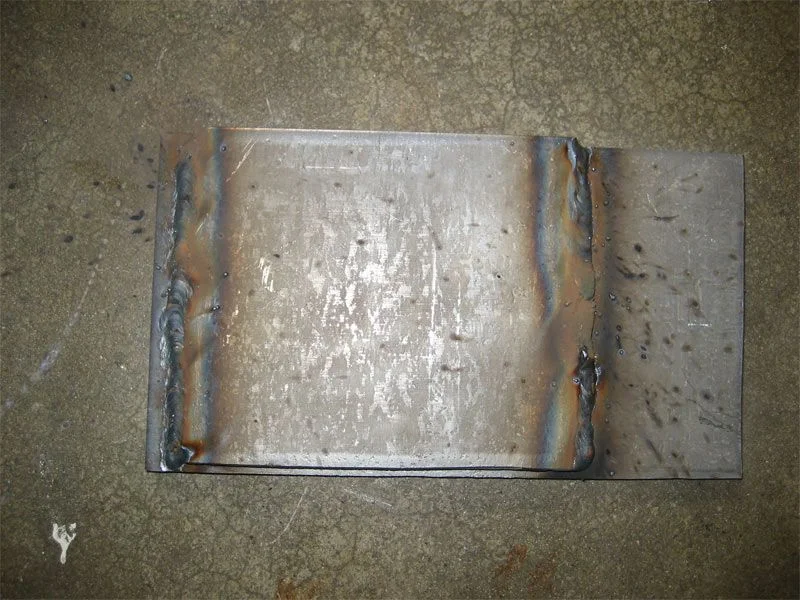

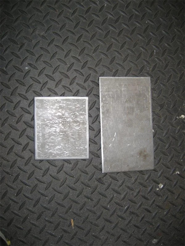

I started with 12x12 plates and measured the frame height and determined how long I wanted the plates to be. The drivers side needed to be twice as thick as the passenger side so I figured I would weld a second 1/4" plate (with a smaller footprint) to the first on that side...
After fabing the plates I clamped them into position and assured that the "L" brackets were properly spaced. They lined up well so I decided to weld them in place. Just as I finished I realized I had created a ton of extra work for myself. I had not marked the holes for the drivers side prior to welding the plate on. Now I was stuck lying under the rig with a small angle drill to make 4 holes through the double plates and frame. :doh:
Needless to say, this took some time and patience. I was cursing myself bigtime at this point but in the end this may have worked to my advantage. I was able to drill one hole at a time, and hold the "L" bracket in place to assure each hole came out perfectly. The "L" brackets hung down a little, so I drilled two new holes on the driver's side bracket to accomodate bolts that would pass through the frame. The holes on the left (rear) of the plates could go all the way through the frame and would end up just missing the running board bracket. The front holes would not be so lucky so I decided to tap threads through the two plates and frame and attach them with shorter grade 8's. I would have preferred to gone through on all four but after completing it I'm certain it will hold up with the two rears all the way through. Just to be sure I didn't screw up the threads I tapped one of the rear holes for practice before tapping the front two...

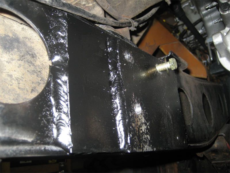

I forgot to take a few shots of the final tranny crossmember so here they are after the exhaust...
Drivers Side:
1. Rear of bracket bolts through bracket, plates, and frame...
2. Front of brackets threaded through the bracket, 2 plates and frame...
3. Backside of bracket (these holes lined up ok to pass through the frame).

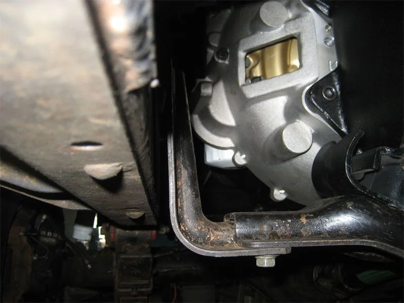

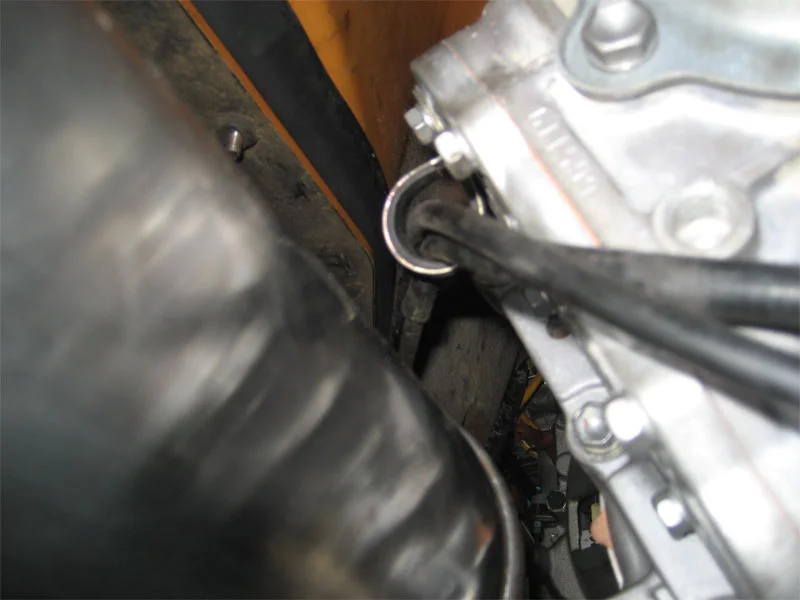

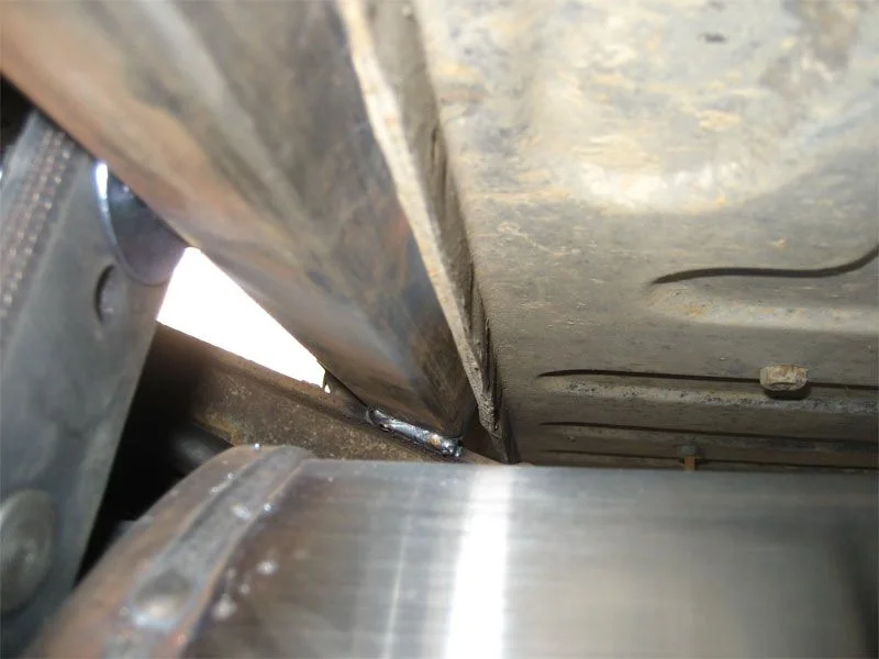

When I picked up the rig two days later we had definitely had to make some adjustments. There was not enough room with the fuel tank and air tank to put a quiet muffler in without making it look Ghetto and I didn't want to put the OBA air tank inside the rear passenger area. So Chad recommended cutting the rear crossmember (that I thought I was going to have to move anyway) and weld a small square tube crossbar near the top of the frame to control any minor flex. This gave him the room he needed to fit the type of muffler I wanted.
1 & 2. Exhaust from manifolds... (yes I need new plug boots)
3. Y pipe below oil pan...
I had Chad place the detachable flange near the drivers side tranny "L" bracket so I could remove the exhaust if needed to take out the bracket bolts...
After all was said and done it cost $420 for the exhaust, crossmember removal, welding in the tube crossmember and reinforcing a few welds that I needed more piece of mind from. Not cheap but solid work and I've accepted the fact that I have to pay for the things I have no clue how to do.
