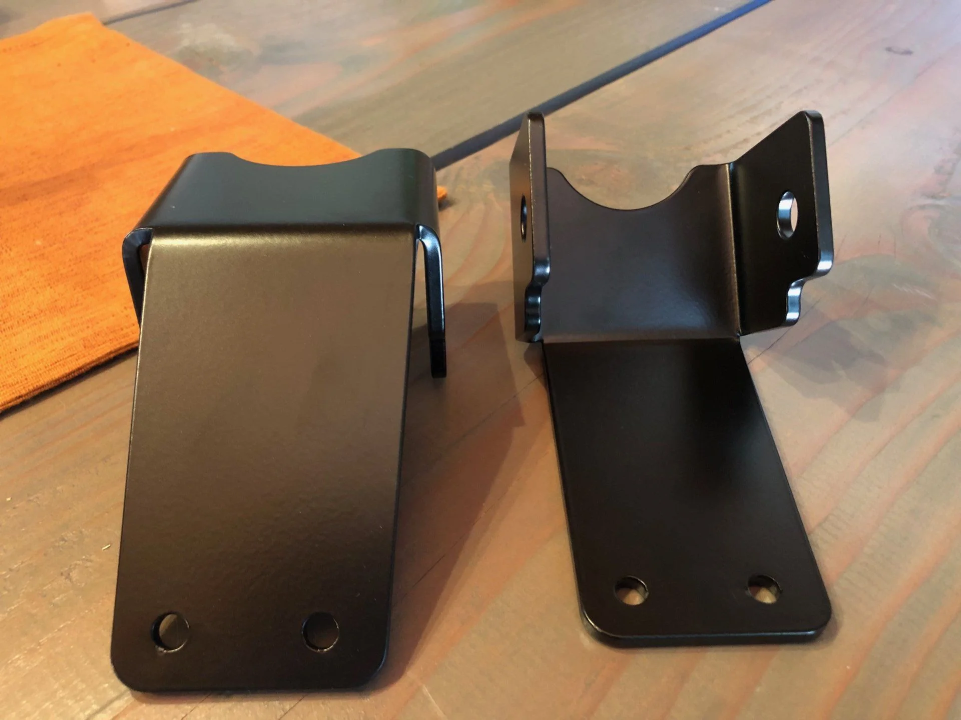

I just got a set in, and I'm trying to decide how to coat them. Paint, powder coat, electroless nickel... Has anyone installed them bare? I don't want a rusty mess, but have no experience with the HSLA that they're made of.

I just received a set today as well as a set of rear shock guards. I was planning on getting them powder coated in black.

rustoleum hammered or steel-it. They're for bashing, don't waste the money on powder coating. I used rustoleum on the shock guards but steel-it on the LCA mounts for ease in welding them on.
I used the rustoleum flat black that's supposed to be rust preventative. Didn't see the point in paying so much money to powder coat anything like that, for something I'm going to have to paint over and over again from scraping it
I have the rear LCA guards and the shock guards. They pretty hearty pieces of protection.
Krylon enamel is a good option. It’s a really good match to most fabricators’ matte powder coat. I’ve used it for a few years now, and is very resilient. As long as you do some prep (sand rust down and rub area with mineral spirits or alcohol) it bonds well.
Thanks for the advice. I will be painting them now.
I ended going with Powder Coated satin black. I sanded with 150 grit, degreased, primed, and sprayed with roll-bar black VHT. It ended up not adhering well. They look awesome, and the primary concern was eliminating rust propagating from the creases, folds, and unexposed areas. I can touch up with paint if they get scraped or chipped on the underside. It cost $31.05 after tax.
I also had bad luck with the VHT paint. It reacted poorly when I applied a 2nd coat to my bumper. It bubbled and wrinkled. I had to chemically strip the whole thing and start from scratch. BTW - The Majic Tractor Truck and implement spray paint from Tractor Supply is awesome stuff and matches a black powder coat in look and texture.
