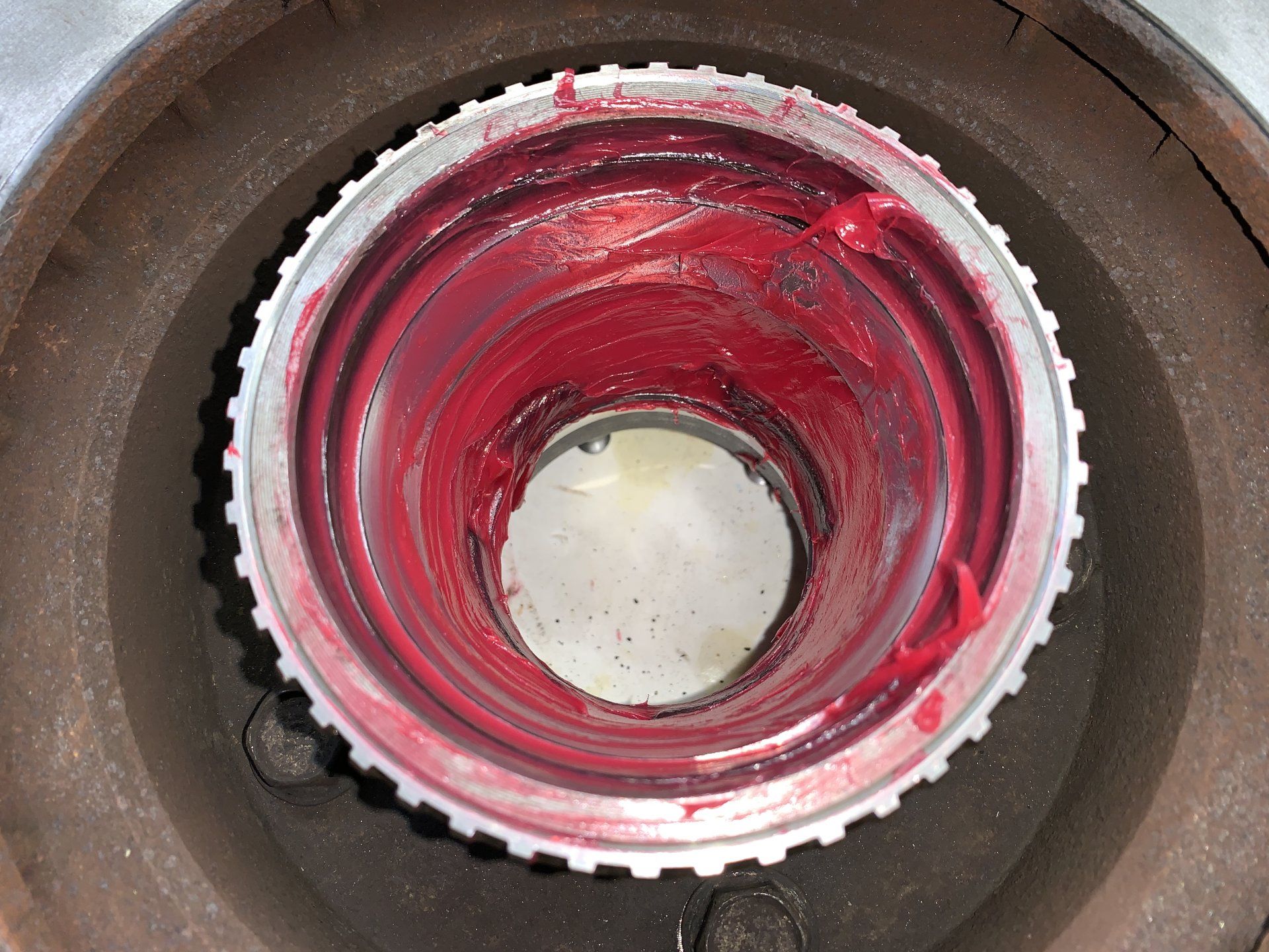

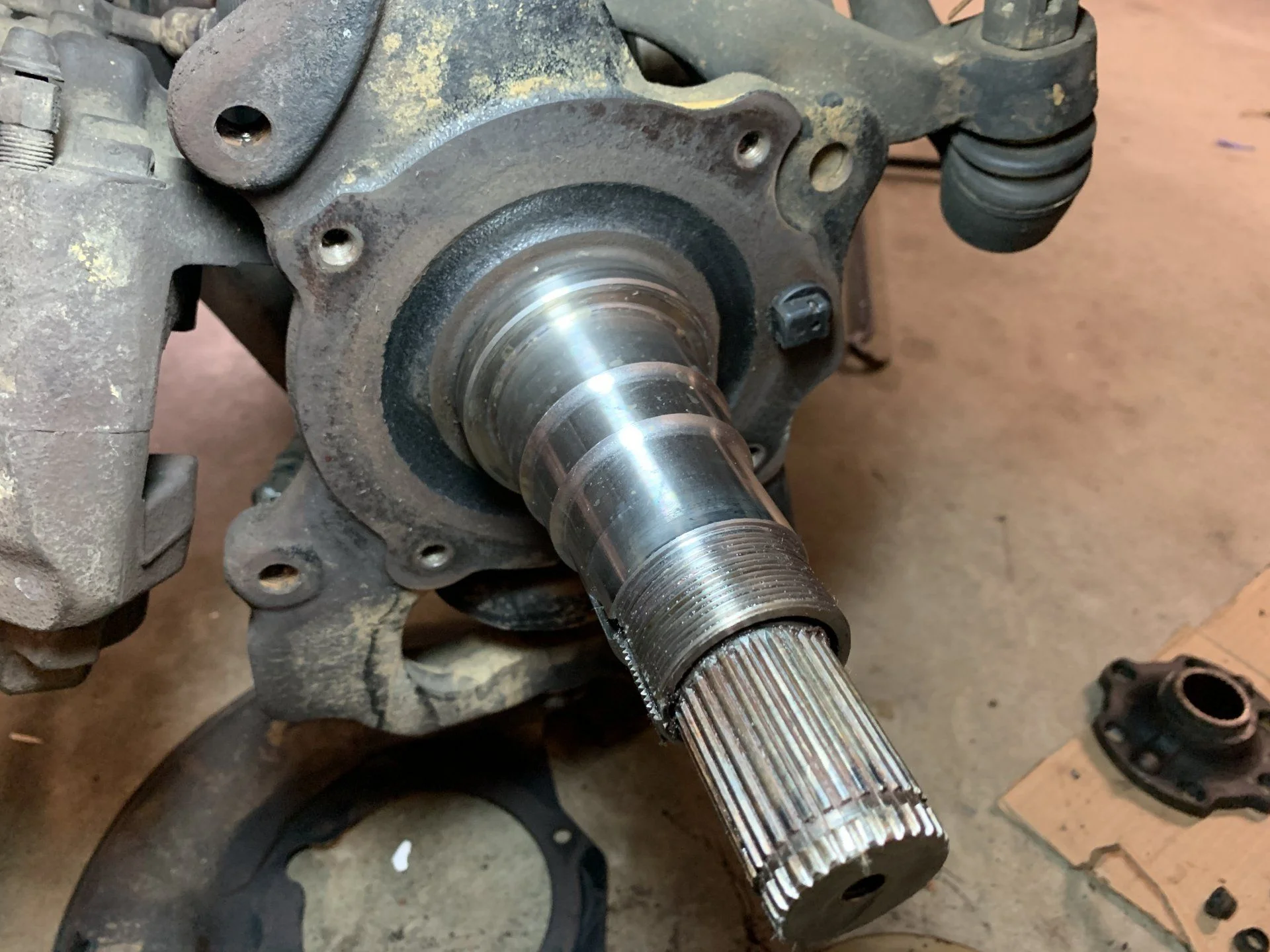

I have the typical VSC TRAC & VSC OFF lights on the dash of my 100 series. Narrowed it down to the front rear wheel speed sensors. I’ll be replacing my wheel bearings this Friday so I figured it would be a good time to possibly get this done as well. I really only need it to identify whether it’s the left or right front sensor. If someone happens to have Techstream already setup on a device that I could either borrow, or at least diagnose in your driveway it’d be much appreciated! Will pay in your currency of choice.
Bump. Tore down to the spindle for bearing replacement and cleaned both front sensors. They appear to be functioning normally and testing their resistance proved they were within proper spec. Now thinking it’s one of the rear sensors
