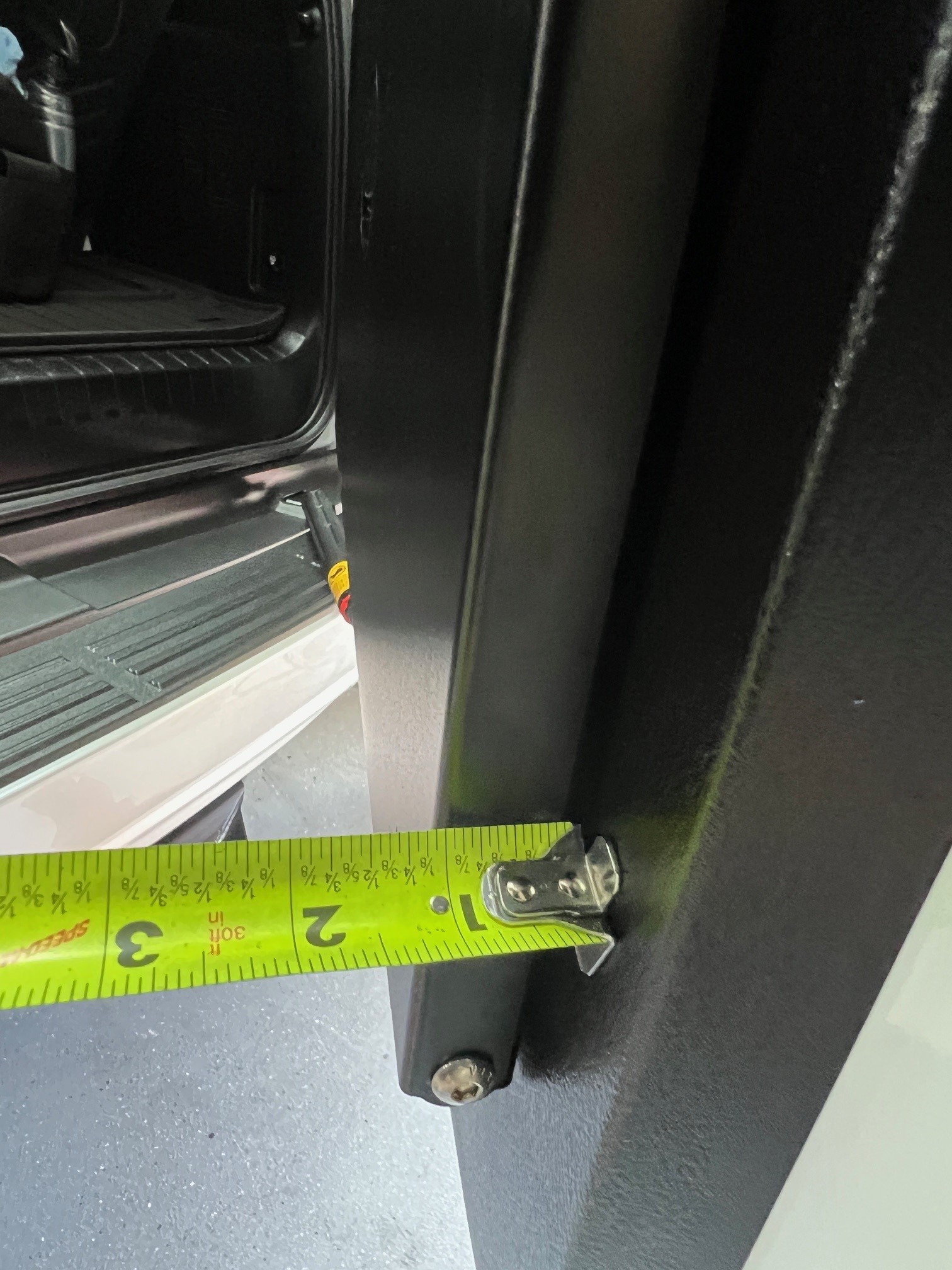

Here's what I have. Another member posted their rear door clearance -- the Big Country drawers will not fit with a rear door table installed.
Maybe I'll get lucky with the Dobinsons ......
Could anyone with a Dobinsons drawer system grab me some photos?

From what I can see, it should fit. The Kaon sticks out about half way over the bottom plastic trim piece but the dobinsons drawers sit fully behind it. This isn’t my photo… just one I found here on mud.

Even though the drawers look like they are set back, the issue would still be the sliding top, which stick out from the drawers.
Can't help ya with pictures as I no longer have the drawers but when I did the Dobinson's Drawer System and rear KAON Table fit in my GX460 w/o any issues.
