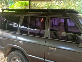

I finally got my rooftop tent setup this weekend! I've never liked the boxy nature of the RTT's I see around here, and I wanted something that I could put up and take down by myself with minimal hassle, so this is what I came up with.

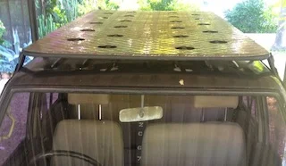

I had a friend make the custom roof rack about a year ago for roughly $600. It's designed to pretty much haul whatever the rain gutters will support weight-wise.

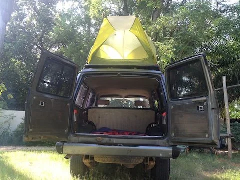

The tent I added is the one I always use when I camp, but now I can pitch it on the roof if I want, which means I can sleep 2 people on top and 2 people inside. That's pretty important to me when I've got my kids out in lion country. I used a couple of spare tent poles wedged into the rack pillars to provide the tension for the rain fly, which shelters the open back of the truck. And my favorite part of the design is that there's no rope needed to tie it to the ground, so no tripping over it in the middle of the night or after a few drinks.

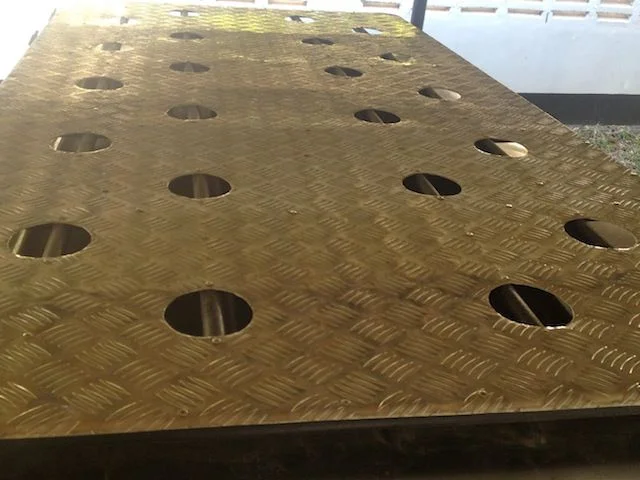

This design required no modification to the tent, and I only had to drill 4 small holes in the platform to accommodate the tent's corner poles. The tension on the poles locks the tent in place on the rack. If I wanted, I could drive around with the tent pitched, albeit slowly.

How long does it take to set up the tent and can
you do it in the dark without more than a single
flashlight?
I can set it up alone in about 10 minutes. I pop the tent on the ground, rain fly and all, then just lift it onto the roof rack and snap the pole ends into the holes I drilled in the rack. The poles for the fly just slide down the side of the car and hook into the tie-downs on the fly. Pretty simple really. All I need is a headlamp.
