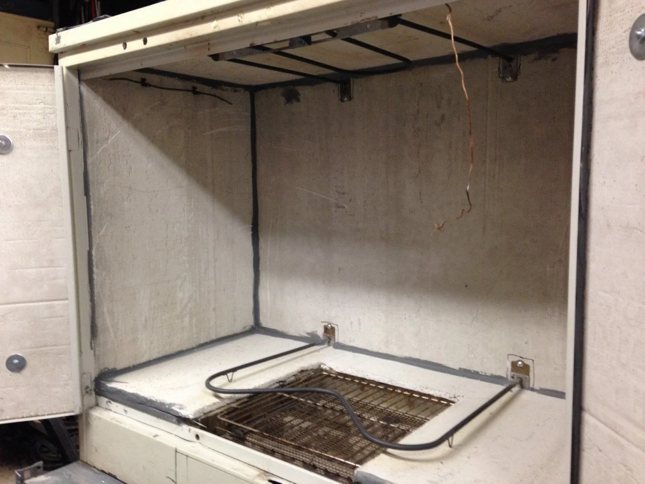

Not sure if this is the section for this but thought I would share.

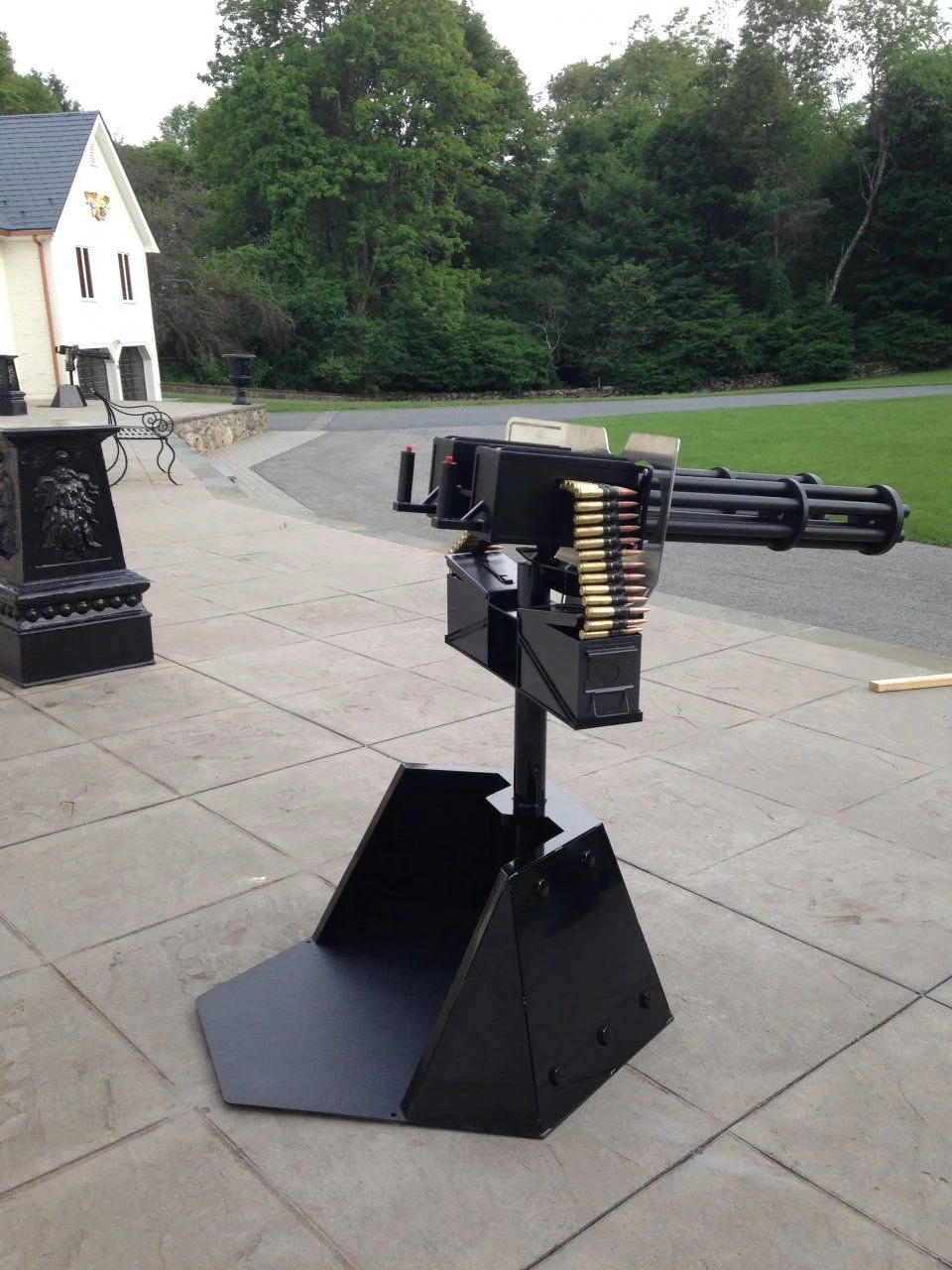

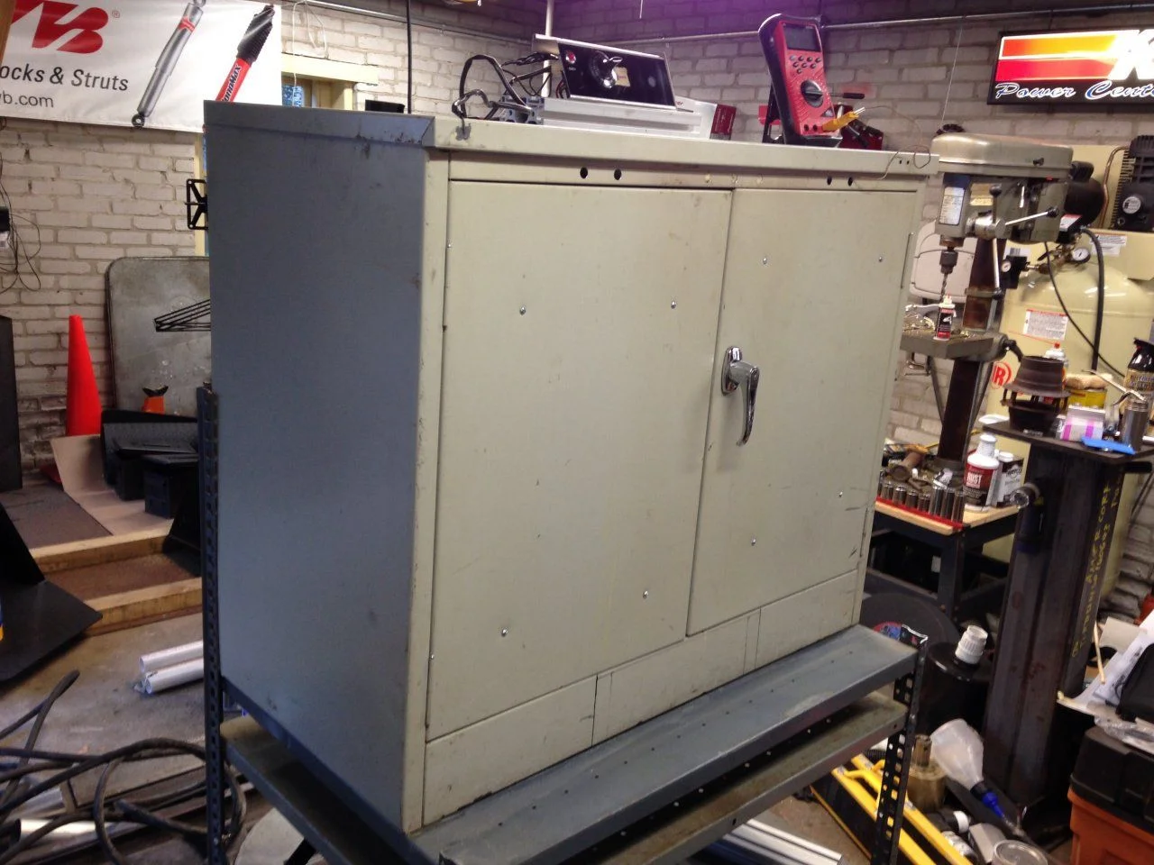

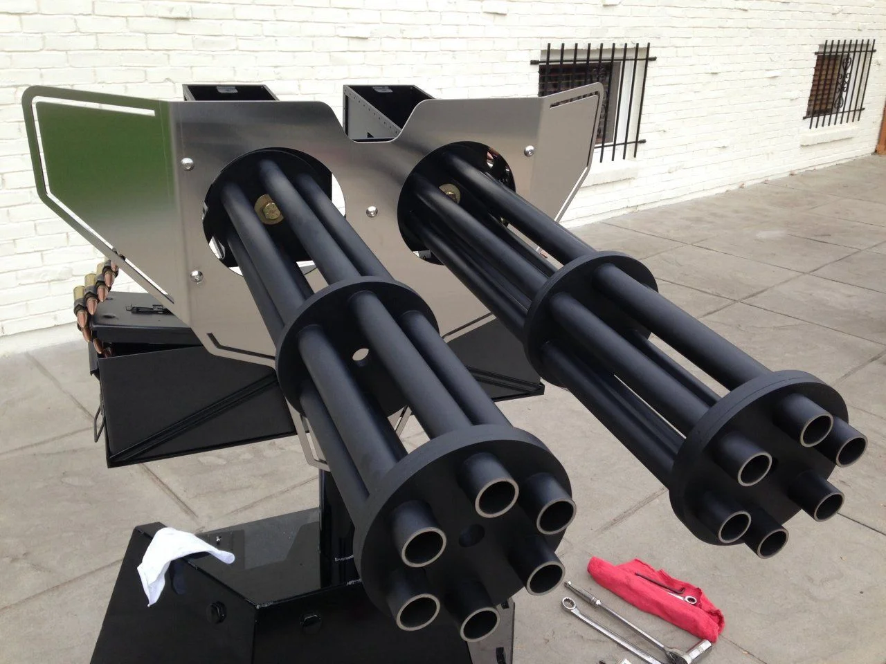

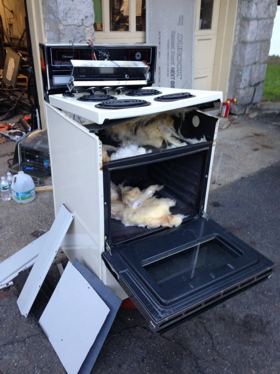

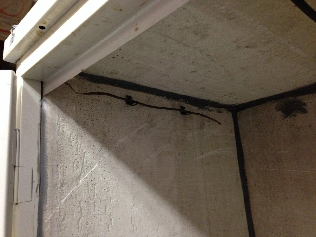

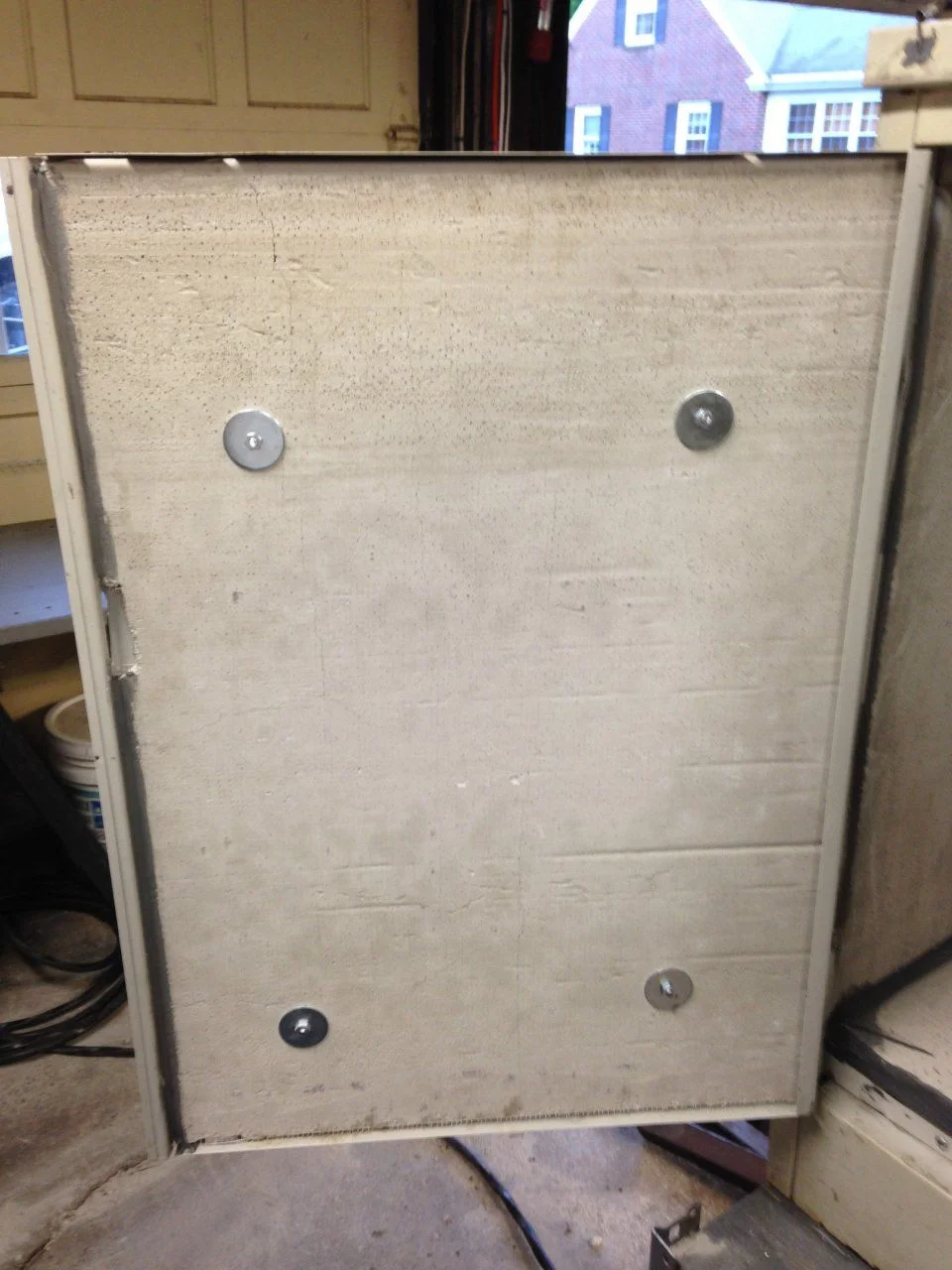

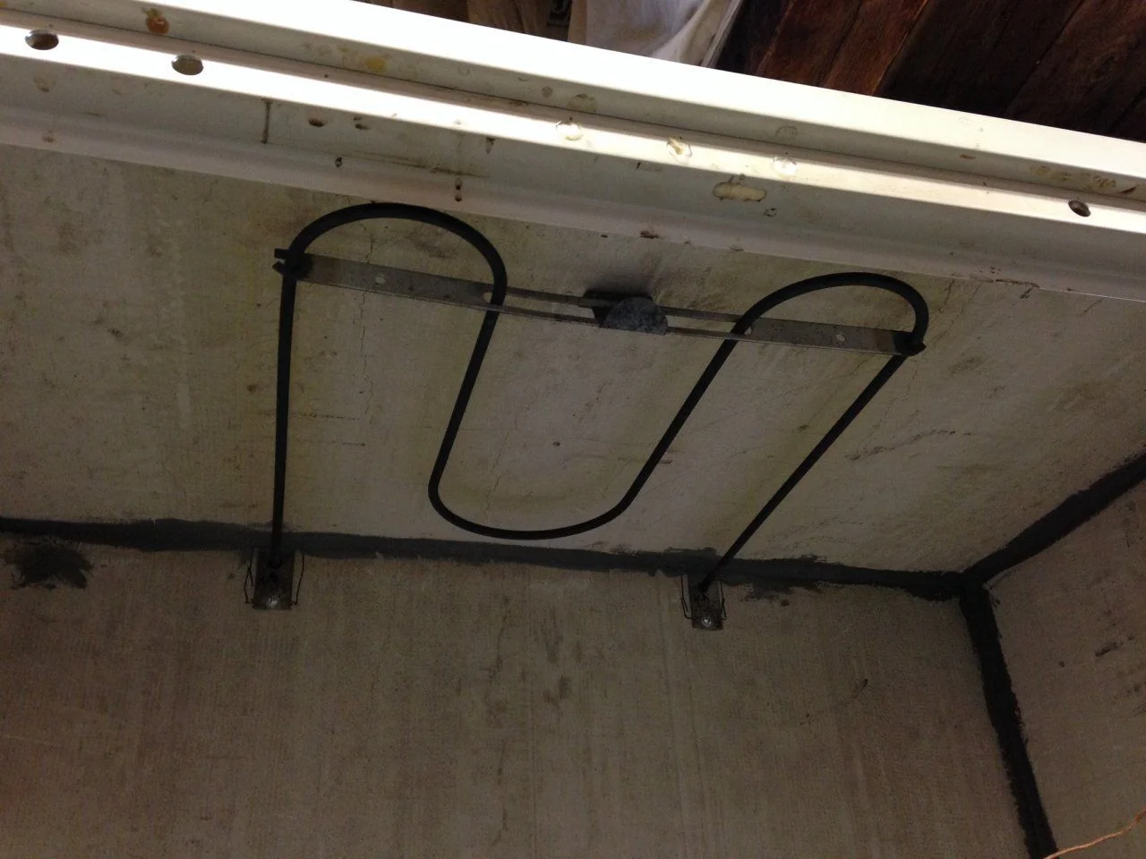

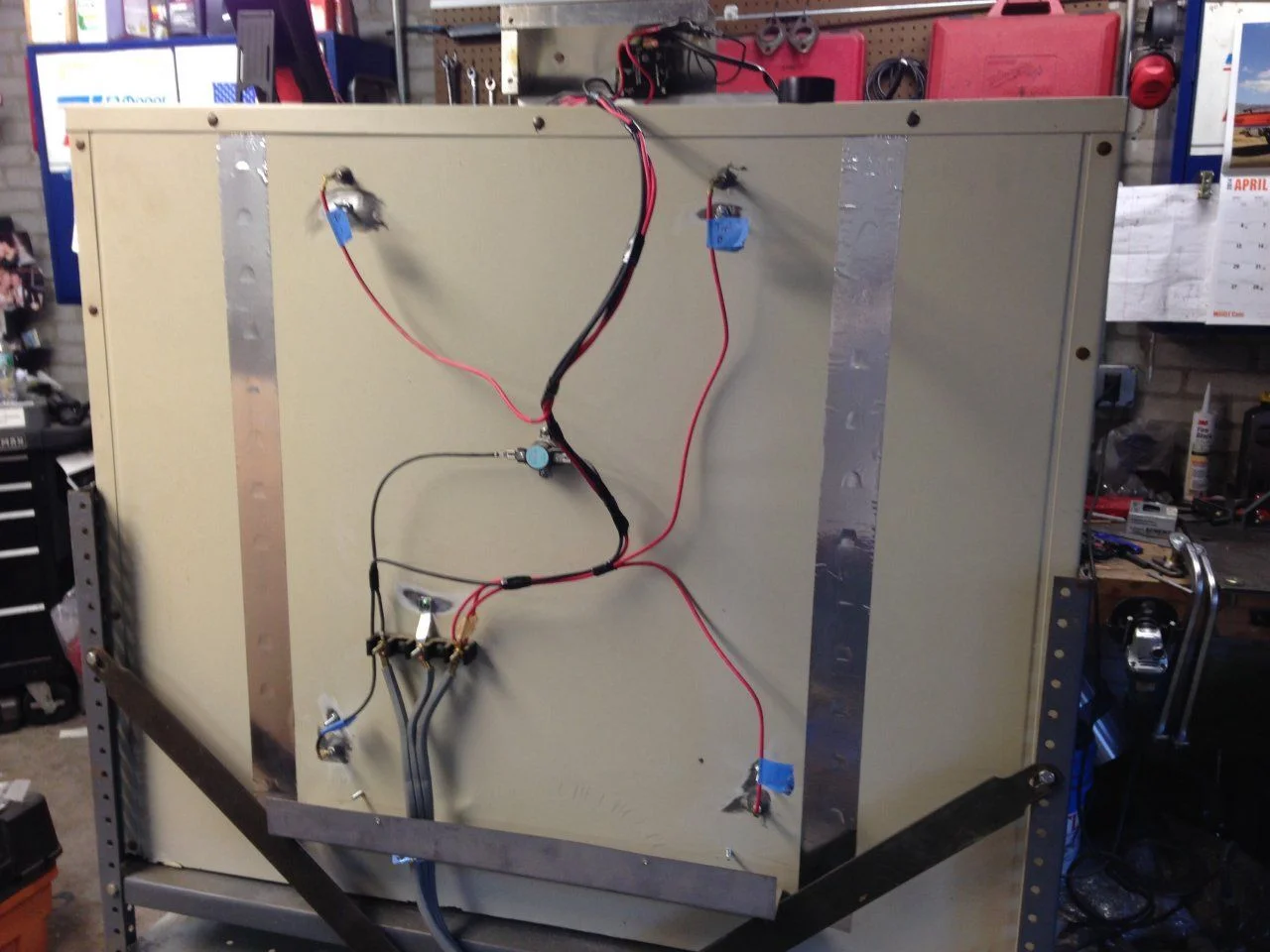

I made this a last year and has been working great since. I won't go into a ton of details but you'll get the idea and if you need more info feel free to ask. I made this oven for under 100 bucks. I got the metal cabinet out of the trash and the oven was a freebie from Craig's list if I picked it up. The only thing I bought was the stone board from Home Depot and fire caulk. I had the hardware. The stone board is double layered. It works great! And I use a thermal couple on my volt meter to monitor temps. The inside dimension is 34x18x24 roughly. Here are the pics. An old locker works good too on long skinny parts. Anyways it was way cheaper than buying a "real" powder oven. And is a very useable size. You can do rims too if you make a stand.
This went together pretty quick. Stripping the oven took the longest just to separate what I needed. The older the oven the easier it seems. I've made two other ovens since for friends. Good luck and enjoy. For the cost of the initial set up fee at a powder coater you can now do it yourself.

But ya the oven has held up and worked great. The only thing you might notice and take caution with the electrical Was at first bake the stone board released a lot of moisture. I was like what the hell is leaking?..lol
