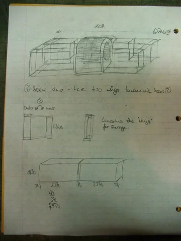

Because the blower sucks :hhmm:, and the inlet to the blower is in the sides, axially and then blown out the rectangular front, I need to enclose the blower in its own mini box. The sketch of which is below...
I will build another slightly larger frame that will sit in front of the filter box which makes up the front of the blower box and when taken apart, will allow the filter box to concertina in to the larger frame for storage. The sketch of which is shown in the middle.

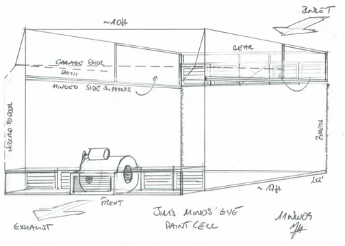

Mind's Eye Sketch
This is what I have in mind...
Maybe that's better, maybe I can't sketch. Oh well, hope to have it completed so I can take real pics.

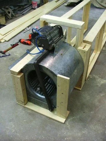

This last weekend, I got a little further and started on the front fan box panels (they allow the rear filter panel to nest inside for storage) and framing up the fan itself.
Here is a shot of the unfinished framing to the fan...
Adding the wood allows me to sheet the fan in poly and allow screwed fixing of the wings when in use to make up the air suction box at the front of the garage.

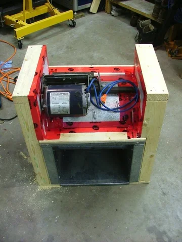

It maybe overkill, but one of the objectives of the exercise was to ensure that the evacuation fan motor was not in the paint fumes. I cannot guarantee that the dilution is sufficient to ensure that a combustible mixture doesn't ensue so better safe than sorry.
The issue with the fan I have is that it did not appear easy at first to be able to separate the motor from the belt assembly. What I did was cut a plastic washer fluid jug in half, down the sides and along the bottom, cutting off the top and then punching a hole for the motor pulley spindle, then a slot from the top to the jug half to the top of the punched hole. This jug half was then fed up between the pulley and motor using the slot to allow the plastic to fit upto the spindle. Once in place, the spindle spins in the punched hole and I taped up the slot.
With a lot more finessing of plastic parts and copious use of Tuck tape, I was able to create a barrier across the inside of the upper frame to be between the pulleys and the motor.
I chose the plastic from the washer fluid jugs because it seemed to be sturdy enough to hold form as well as flexible enough to mold around and cut. If I had time and this was a professional job, I'd have cut card templates, cut sheet steel or aluminum and welded a fancy barrier. That would take me even more time and I want to get wrenching.

I framed up the side opposite the pulleys the same as the pulley side. I didn't need to take quite the same approach to create a barrier on this side and used for the most part vapour barrier.
Finished extraction fan box
The final vapor barriered extraction fan box looks like this.

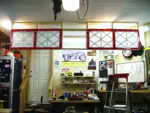

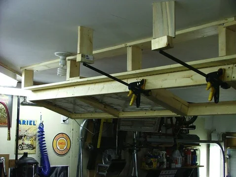

Yesterday I made a spacer bar to attach to the ceiling and tonight a spacer box to separate the two filter box wings. The latter three pieces were screwed together and a piano hinge attached to the upper edge.
The spacer bar was lag bolted to the ceiling and the filter box assembly clamped in place using squeeze bar clamps until I could screw in the other side of the piano hinge.
In the down position it looks like this...
I taped the four filters in and the spacer bar and centre spacer will be vapor barriered when I get motivated and before I finish.
The spacer bar is required because my back corner zips are only 7 foot long, the space I now exactly have under the bottom of the filter box in the down position. Also, when the paint cell side bars are swung up, they'll be at least 4 inches from the ceiling, and now the rear filter box will fold up last so that the sides and rear don't interfere. The spacer is 7" tall, so plenty of room to accommodate the 4" wide side bar folded up.
After seeing all this come together and knowing how much work has gone into it so far, it'd better bloody work and keep the fumes out of the house... I feel like the Master of Overkill.

Here is the rear filter box assembly folded partially up (no hooks in place yet).
When I have this all folded away, I'll staple paper over the filters to ensure that the don't collect dust whilst I'm doing other stuff in the garage. I hear and know from experience that plastic sheeting attracts dust electrostatically so I'll probably have more issues with the paint cell tenting than with dusty filters. Oh, well, we'll see.
