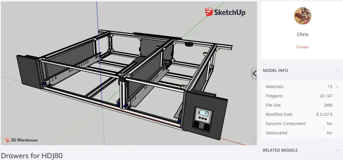

Hi mudders, for those who look for ideas how to build drawers into an 80 series trunk - I have uploaded my version for public use.
2001866
It is made from an aluminum profile base which can be screwed to the 3rd row seat mounts. Cover is made from plywood covered with carpet. Also, it features space for some electronics in the center and two batteries. If not needed, this space can be used to make the drawers even deeper.
I have covered this in my build thread: Build Thread: 80 Series Drawers
Location of the sketchup model: 3DWarehouse: Drawers for HDJ80
Have fun.
