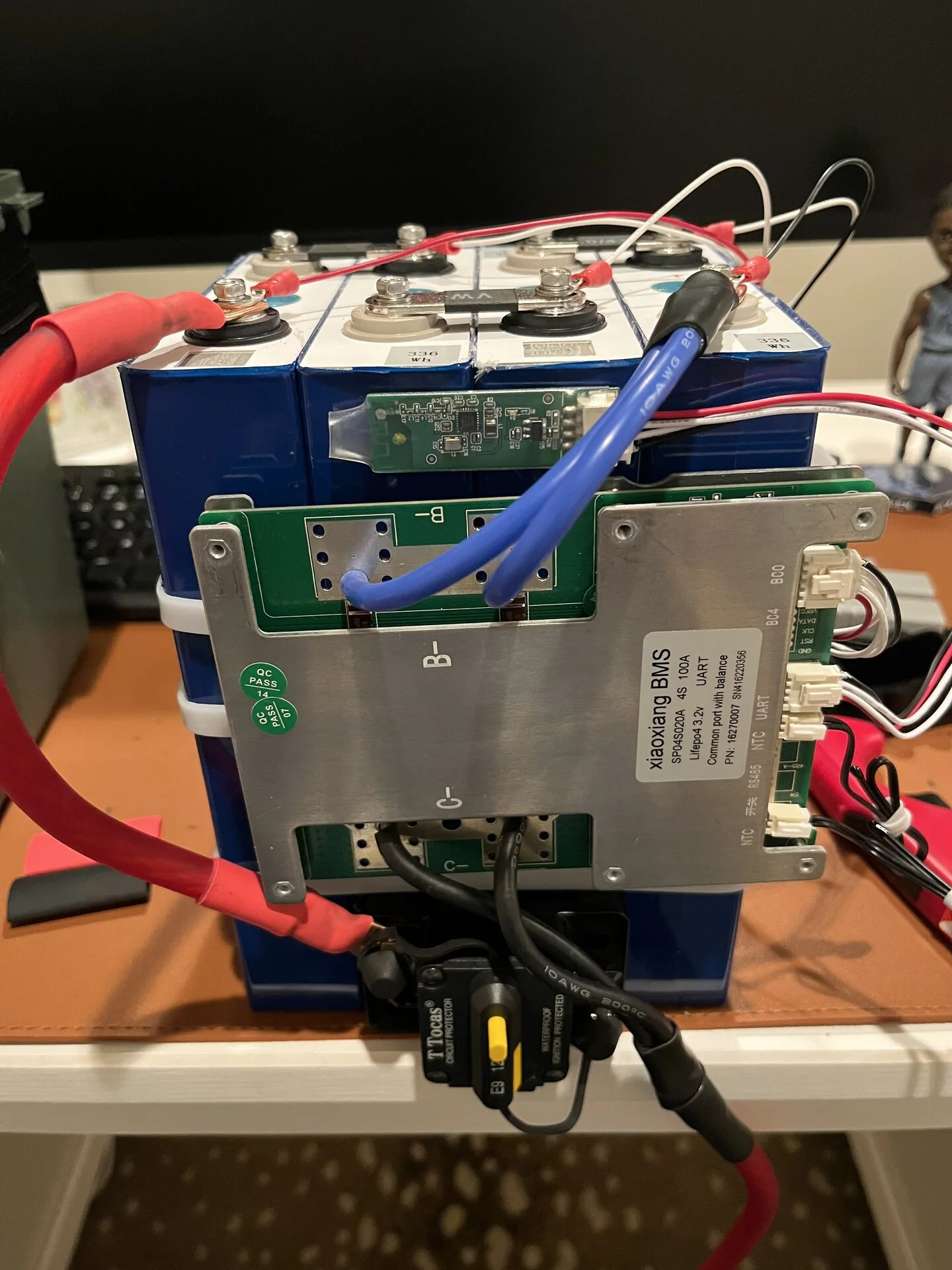

Starting my build and need some input.
I was going to place the cells in the same orientation as the OP. Just want to make sure that this does not damage them in anyway.

I've been running this setup for over two years. Batteries have been fine in this orientation with no issues.

Check the spec sheet on those cells. Prismatic cells generally like to be in the terminals up orientation, but some manufacturers are ok with laying them on the narrow side down. I think most all manufacturers do not want them laying on the wide side down.
And you will want to build some form of structure to put them under a little compression on the wide sides for maximum longevity.
Thanks for the replies, good to know that you have not had any issues.
I read the same thing, it should be ok with the narrow side down, just not the wide side down.
Will likely do the same as Otter and place large Zip ties around the 4 cells.
