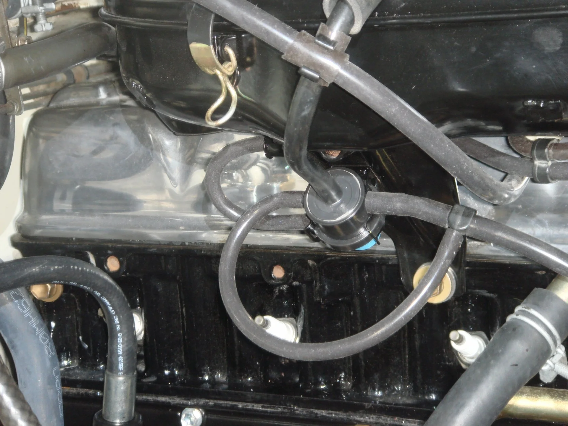

Big cap dizzy in a desmogged 85/60 I have the large line to the firewall for fresh air to the distributor. Threads say the other nipple in the cap is a vacuum line but...oem would have it going to the air cleaner...not the intake. There is vacuum in the air cleaner but not really much. I have no vcv in that line, and what does that do anyway in that line...If I go to the base of the carb or intake won't that be a big vacuum leak "just apullin that air thru there"? Waiting for the brain trust to help me out! and thank you..
The VCV snapped into the bottom of the air cleaner housing controls when the valve opens to the air cleaner. When vacuum from the manifold pulls on the vcv, a passageway inside it opens and air can flow.
That VCV is there to shut off the passageway from the air cleaner housing to the distributor cap.
When the engine shuts off, gasoline vapors evaporating out of the blazing hot float bowl migrate up and out into the air cleaner housing ... and then migrate down into any attached hose - including an open vent hose to the distributor.
Without that VCV blocking off the flow when the engine is off, gasoline vapors HAVE migrated down into the distributor cap and HAVE caused it to explode the next time the engine is cranked over.
Venting the distributor is important. An unventilated unit will corrode away relatively quickly due to the nitric acid created inside it from the ozone reacting with water vapor.
The FZJ80 VCV is still (or was recently) available. It's the same thing as the FJ60 2F unit but with reversed pipes. Rig one up if you can get one.
OK, I knew someone had the low down. I was planning on venting it just did not know how much vacuum was needed. So essentially there is a fairly passive negative airflow from the distributor but only when it is present opening the one way valve. Don't know for sure what filter housing I am going with but I'll make it work. Thx for the info.
