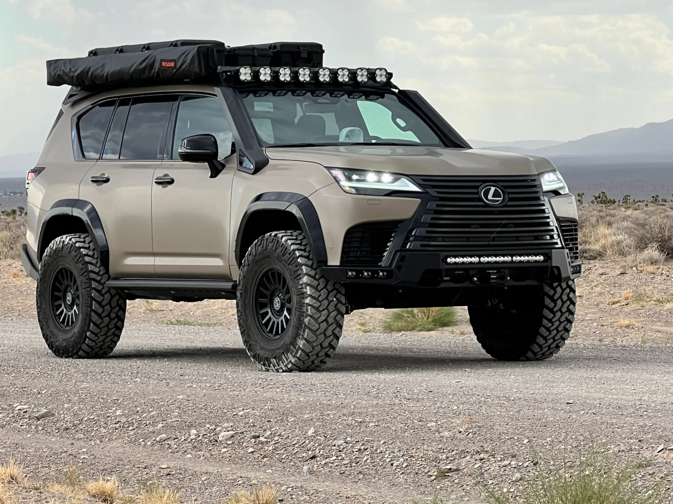

Hey guys. It’s been crazy busy with events but finally finding the time for a build thread. I am super excited about this one and we already have put 9k miles since the build.

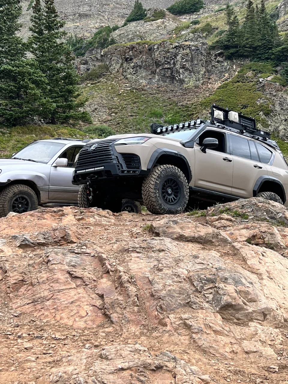

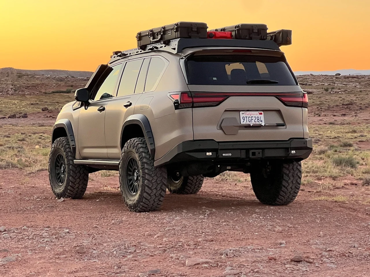

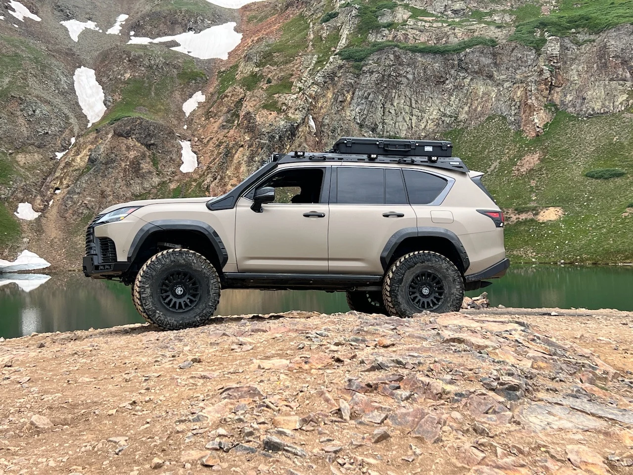

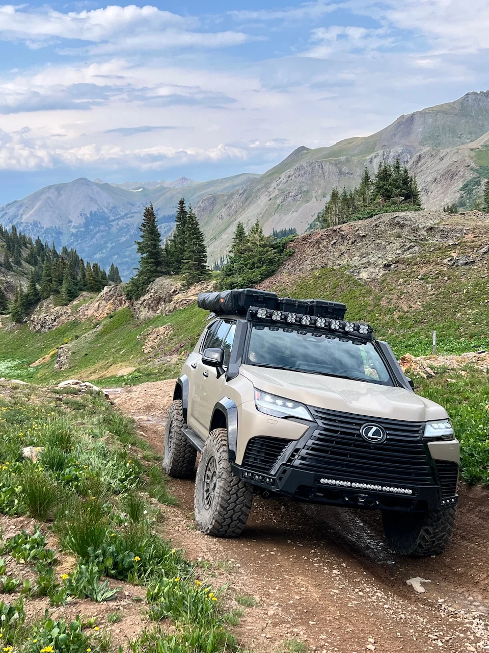

This is the first ever lx700h on 74weld portals!
Here is a list of what we have done so far. Let me know your thoughts! We are also offering full custom builds so reach out if we can help.
2025 lx700h in earth.
Full satin ppf wrap done by beyond wraps.

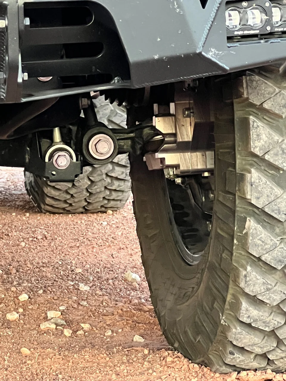

74weld portals that provide 3.88” of lift at the hub and a 22% gear reduction. All the factory ahc is fully functional and all steering and suspension geometry is as it was from the factory. These add 2.77” of width to each corner so we are running a plus 40 icon recon wheel in gloss and a 37x12.5r18 Nitto trail grappler. To cover the tires we added a gloss carbon fender flare that is plus 50mm coverage which gives a nice flush fittment. Because the portals lift at the hub clearing the 37” tires was actually very easy and we did not have to limit the travel.
We added some billet front icon upper control arms and rear lowers. We have our armor all the way around and we went with the low profile bumper for this build.

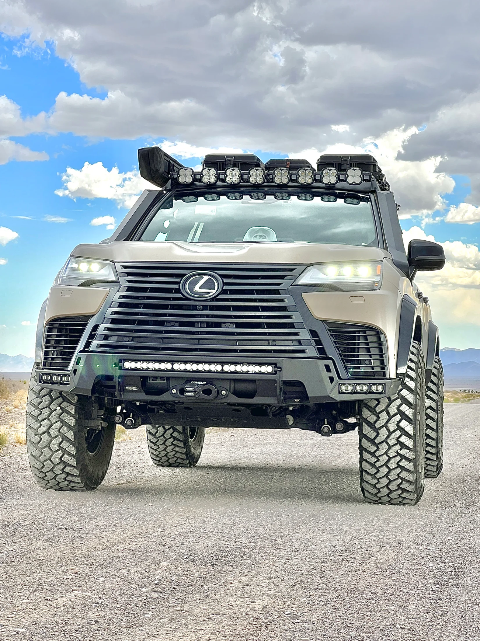

For lighting we went with the Baja designs linkable light bar and some s2 scene lights for the side. In the front bumper we have a comeup solo 12.5 , Baja designs s2 triple fog light kit to match the factory triple projector head lights and a Baja designs onx6 30” bar. We custom coated the agency 6 handles, winch shackle and our logo badges in a gloss black to match the gloss wheels.
We also built a custom set of fully fabricated twin snorkels and added some gloss accents to those as well. Here is a link to a video walk around.
I still have to get the interior dialed in so will keep you all posted on what we do there. Hope you guys enjoy!
