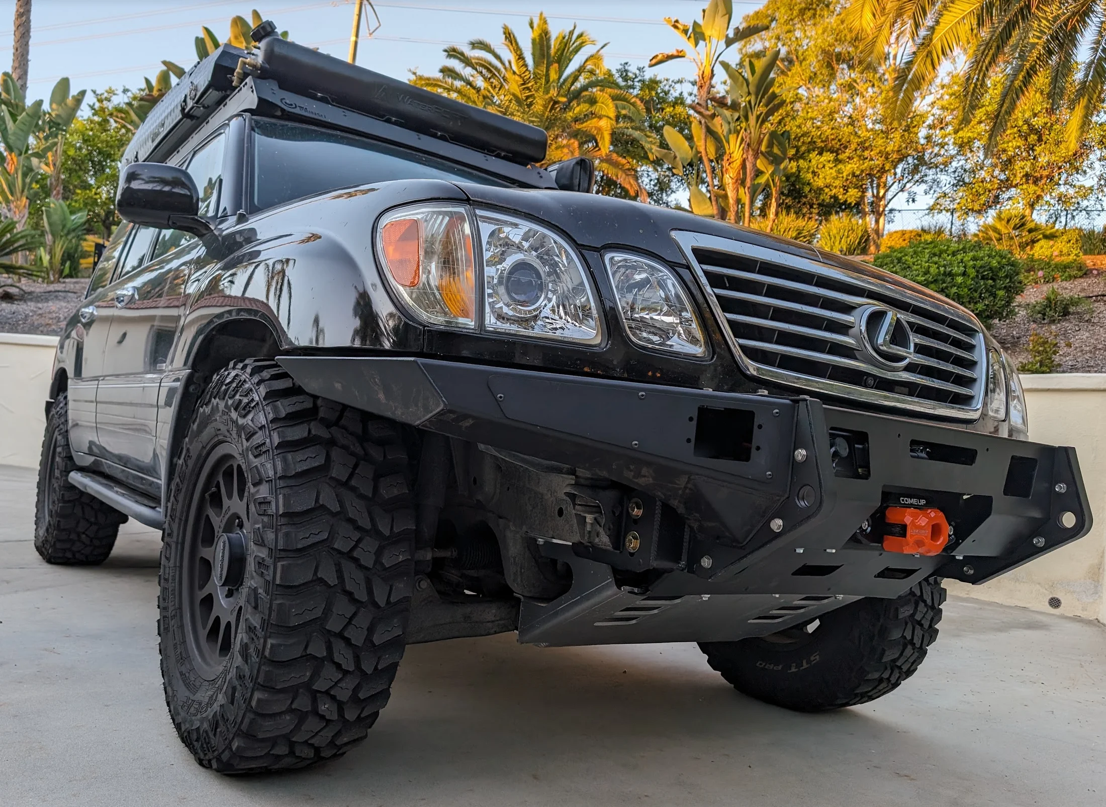

I ordered around Black Friday and had to wait 8 months to receive my bumper. It’s a ridiculously long wait but it is what it is with a specialized product like Dissent. For those of you that like the look, now is the time to get it as they have a couple in stock.
Control arms, axles and steering rack are not exposed anymore than they are with any other bumper.
Weight of this steel bumper is only 80lbs. The additional weight is not huge as the OEM bumper AND the crash bar will need to be removed. I can weigh them if anyone is interested.
I have installed a few bumpers in the past and this is probably the easiest install of them all. You’ll have to cut off the horns though, just like you would have to do for an ARB bumper.

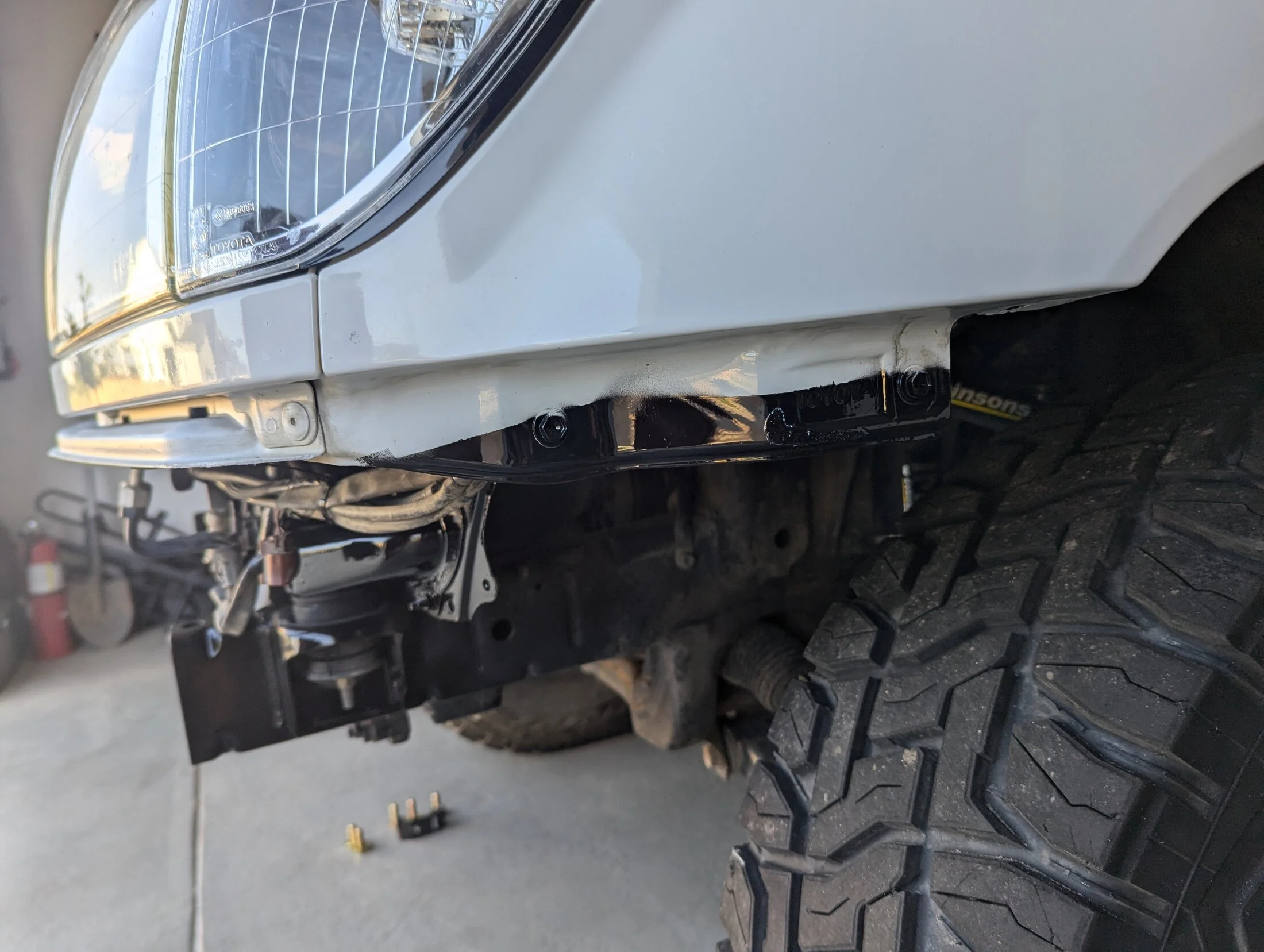

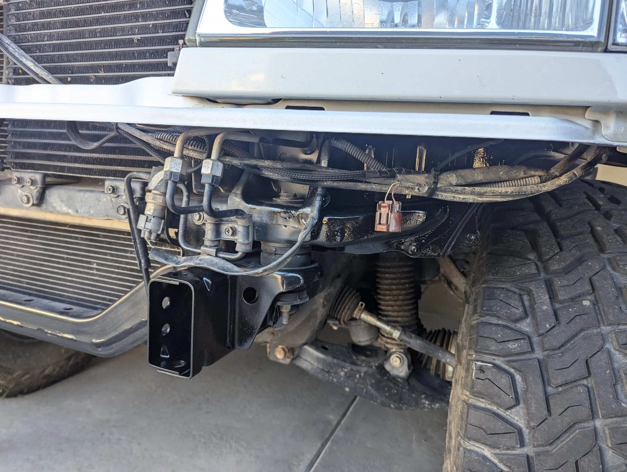

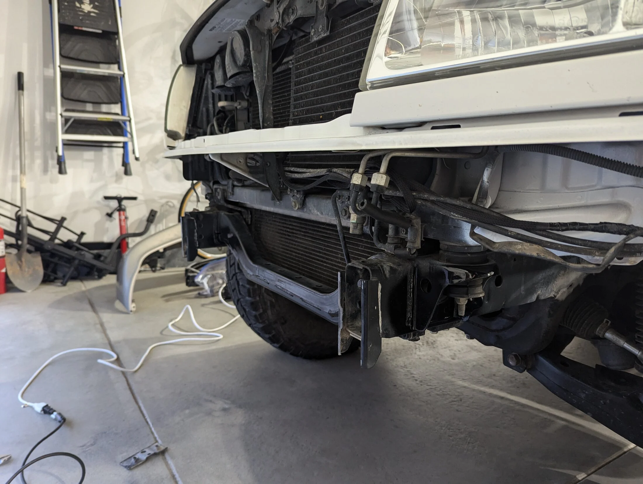

Here's a few tips for anyone on the ropes on purchasing this bumper: Install is super easy compared to what I've done in the past. Ben recommends taking off the grille, and so do I. If your grille is the same as mine, you'll want to touch it up with paint anyway (or, depending on your winch, may need to cut)

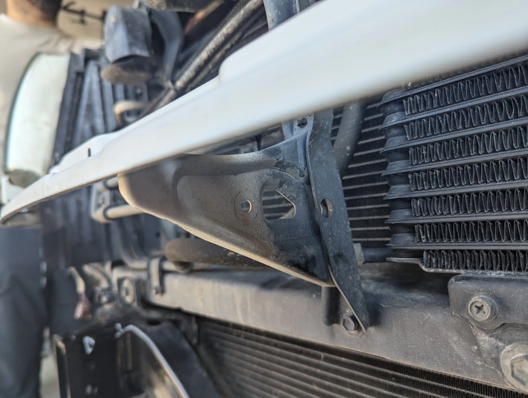

Next cut like all their other bumpers. It was easy for me to cut like shown in the picture and then play with the depth in the weld and wiggle them back and forth.
Once the frame is open, clean the sides so they're flush. Don't forget to remove any burrs - even the slightest burr will be a pain in the ass when putting this on (depending on your coating options, you may have tight tolerances)
Paint what you've cut and cleaned and then paint these areas below since they will become very obvious when you finish installing your bumper.
You can see where I taped off, don't need to go much higher unless you want to.
The whole back area here (shiny coat) will also help improve looks
pt 2 below

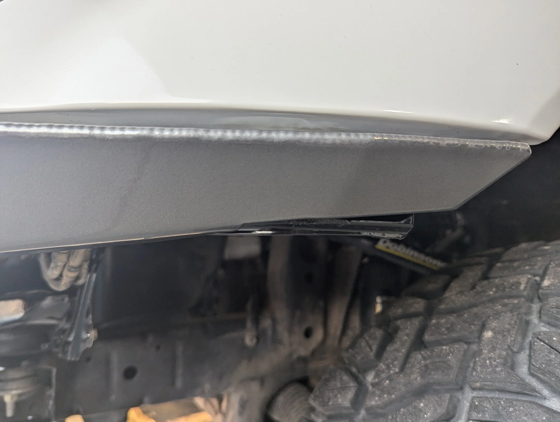

Here's why you want to paint: Unless you trim, part of your body will show through the bumper.

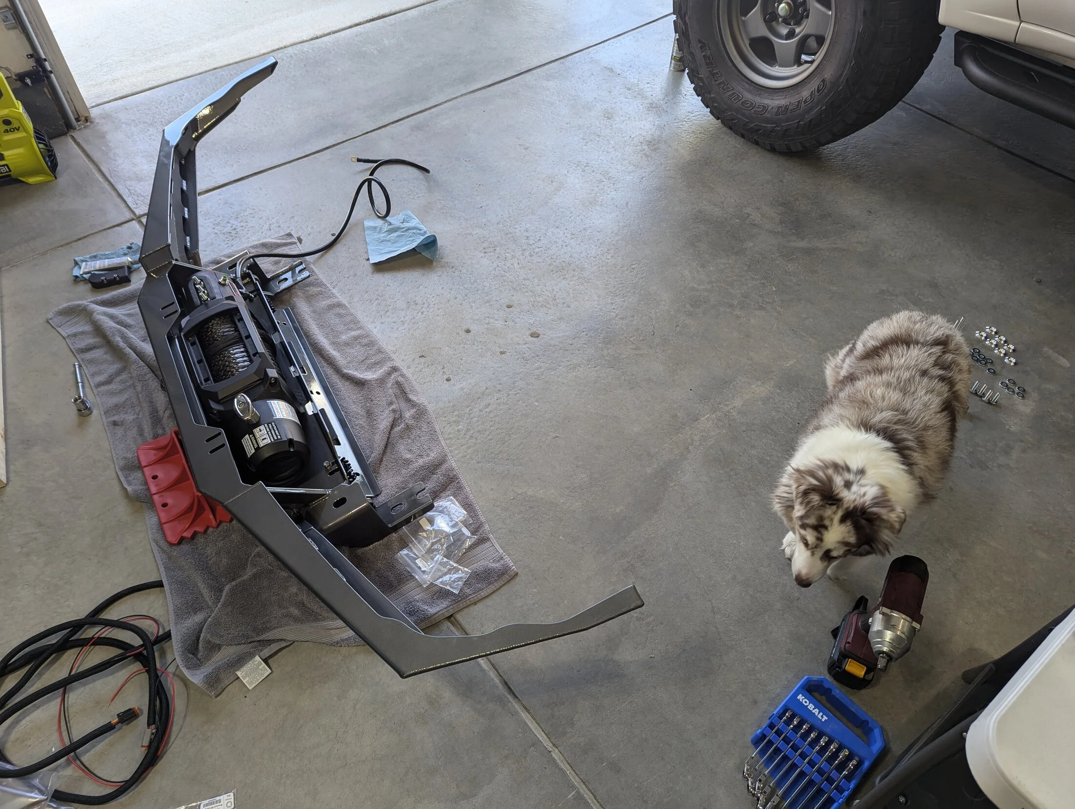

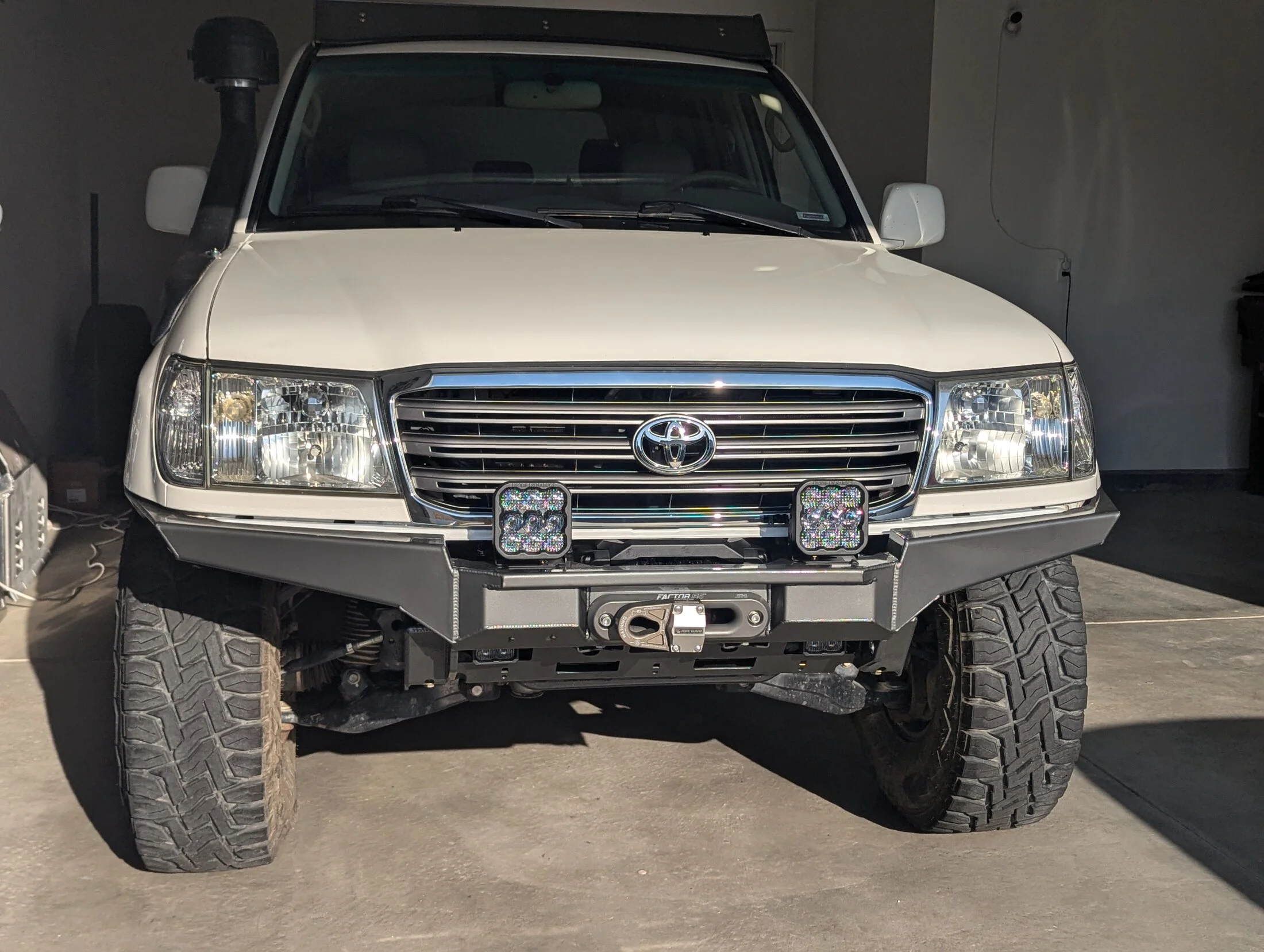

Next: Dry mount your bumper a few times and get familiar with mounting it. If you go no winch, this part might be ok, any winch, you may need to cut and remove a few parts up front. I went with the comeup 12.5 and a relocation kit.
Hardware comes with brackets that you will use - no additional holes to drill anywhere which was nice!
Mount your winch and rotate anything you need to make sure you have clearance. I also recommend attaching the winch lights in advance if going with a winch since space will be tight once you mount it.
If I think of anything else, I'll be sure to add it, if not - if anyone has any questions or wants to see other photos of my set up, just DM or let me know - happy to help!
