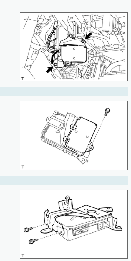

No idea what effect this would have on the vehicle but you could try disconnecting the telematics transceiver
Smaller box is the Mayday Battery that allows for callout if SOS is needed in a crash and transceiver is to the left.
Shark fin antenna is also used for these services. This is in area left of glovebox.

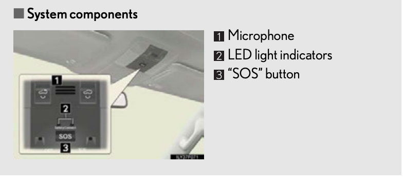

I just wish they didn't put the "SOS" button right next to the garage door opener. I fat-finger that sucker all the time in the dark...
Oh wow! So much connectivity today... Thats the one thing I wish these cars had less of...
You could go with a 2018 and earlier as telematics unit will no longer be able to communicate after the 3G Enform shutdown 10.31.2022
It took me a second... as I had forgotten Homelink was in that area for 2010-2011.
2012+ it went to the rear view mirror

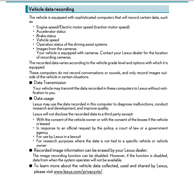

Funny, this is exactly what I dont want... If my GX gets stolen, I want to make the cops earn their pay the old fashion way... Besides, as long as I get my CCR tape back, I'm good!
I do have a paid Safety Connect subscription on mine but that will sunset after 10/31 this year.

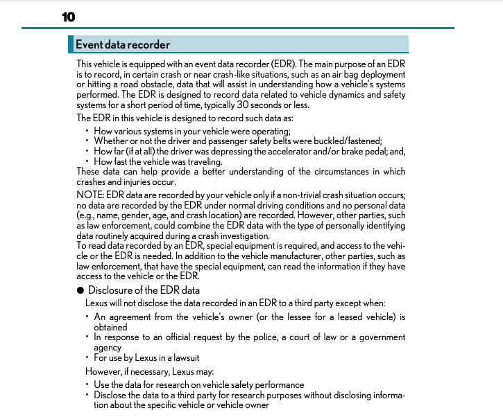

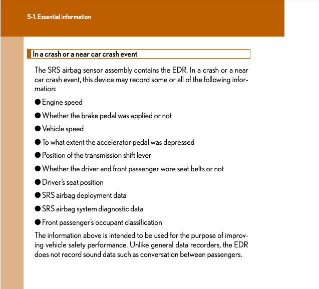

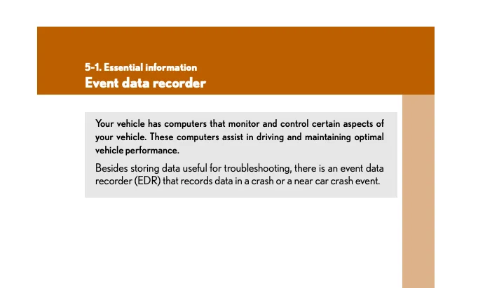

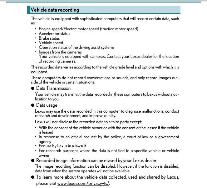

Of course you will still have the EDR :)
View attachment 2904564View attachment 2904566
Above is EDR for a 2022...but here is what a 2010 captures
View attachment 2904571View attachment 2904572
I totally get the EDR and have no problems with the EDR at all. Just dont want Toyota tracking my every move... Its bad enough that the cell companies do that. ;-)
On the 460... options really are to pick up a 10-18 or experiment with disconnecting transceiver components on a '19+ to see the side effects. A 16-18 basically has the same functionality as '19+ but the 3G goes away in October.
