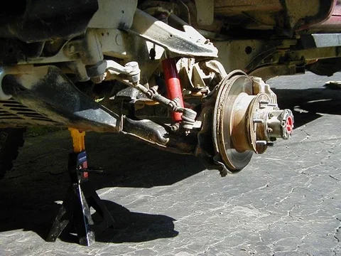

Here is a pic of IFS at what I believe to be full droop judging by the jack placement. I assume the 90 is similar to what appears to be a late 80s. You can see there are a lot of items that start to bind up that are not correctable on a budget. I hope people do not think I am trying to say a 4runner will not flex I am only saying there are a few things that may bind up prior to getting to your goal so try it first prior to taking the front sway off.
