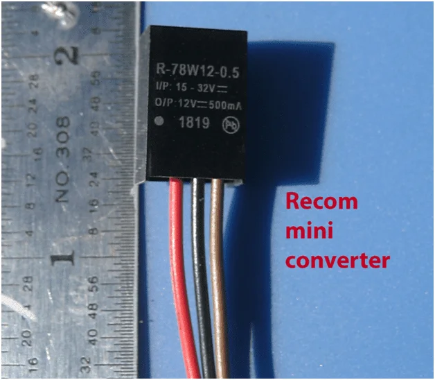

By combining a tiny 500ma converter with some diodes the stereo works as it would in a 12V car.
If you know how to solder and have heat shrink tubing, you should be able to do this.
I think I spent about $40 for all the bits.

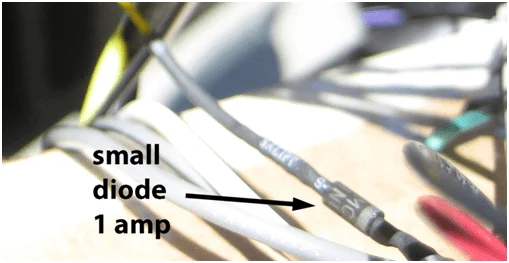

1N4007 diode 1 amp
Amazon product ASIN B0068AEU0W
Recom 78W12-0.5
R-78W12-0.5 Recom Power | Power Supplies - External/Internal (Off-Board) | DigiKey

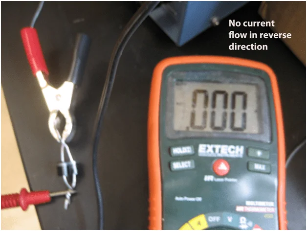

I tested the diodes and found that they work well as long as the current is not too high.
I think my cheap Jensen mech-less stereo uses about 4 amps most of the time.

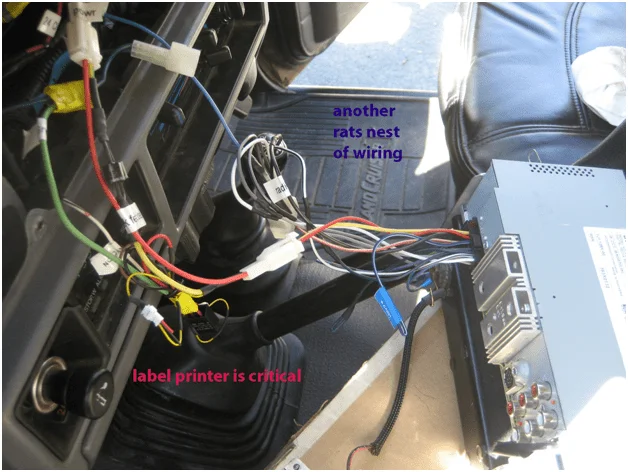

As usually happens with me and wiring, I left the wires too long and made a spaghetti mess.
Using this setup I feel like I could buy a 12V unit with back-up camera for my BJ74 and run it with no problems.

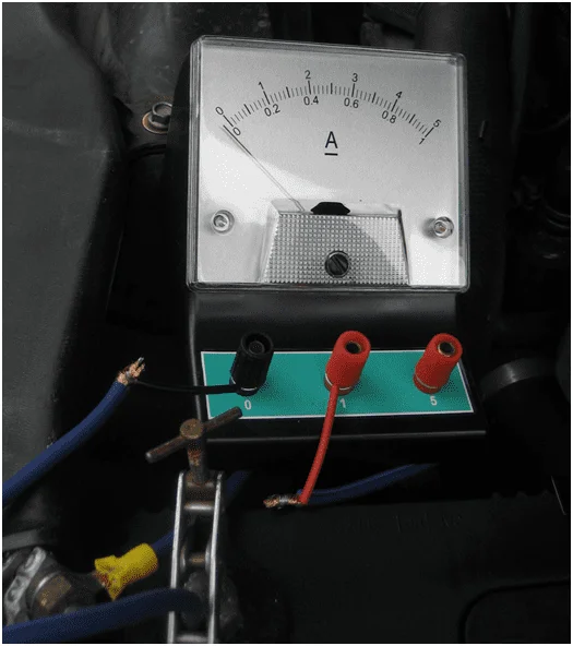

I plan to get a non digital ammeter from our schools science dep’t... measures 0-1 amp I think.
I’ll update with results.
Student-quality analog ammeter was useless.

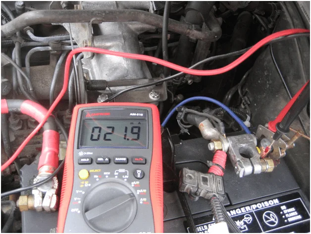

More expensive digital self-ranging multi-meter showed a low draw as expected.
Digital ammeter at first showed a spike up to 175 ma, then a decline to 70ma, settling out at just under 22 ma.
I re-tested many times. Final answer was always just under 22 ma.
