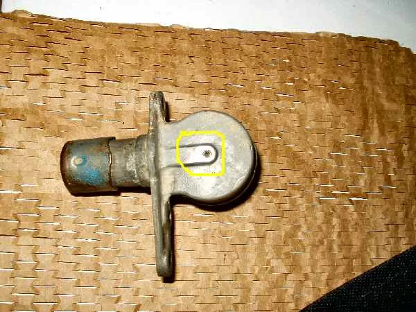

I gave it a quick blast with the sand blaster then tried to figure out how to get into it. It is of course pot metal. The switch guts are held in placed by a lip that was pressed inward to hold them. The Dremel with a cut off wheel made short work of the lip. Pic #2.

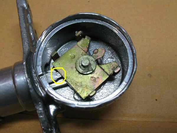

My switch would 'hang' between high and low, due to wear on the switch plate, and the little tab shown in Pic# 7 had lost it's original shape. I used the Dremel with a sand paper disk to dress the gouges on the switch plate (Pic #8) and bent the tab back into shape. I then put some dielectric grease everywhere I saw wear and put the switch plate back in.
Pic #9 shows a critical view. See the circled area? The switch plate is actually two plates with a space between them, that little arm MUST go between the plates AND to the left side. Any other way and it won't ratchet correctly!
