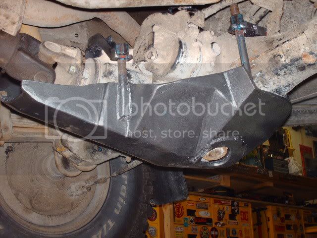

I built this thing for my taco elocker axle a while back. It extends past the pinion flange and protects the elocker motor.
I do like the looks of that TG front protector and it looks fairly simple to make yourself. Could be handy for a guy (me) who's used to wheeling an ifs rig and not having to worry about a front pumpkin
Any pointers for welding something like that on? Will the heat f anything up?
D
How you do all the bends???:hhmm:BTW... Awesome job!
Lol, thanks.
There are only 2 bent pieces, the plate that follows the contours on the bottom of the axle housing and the 1" thick "bumper" strip along the rear. The rest is cut and welded then ground smooth. Cut down u bolts/top plates hold it on either side of the pumpkin and a bracket and 2 studs make up the pinion mount.
