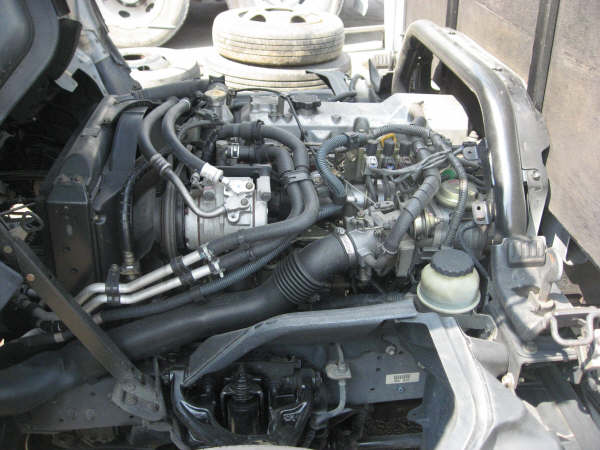

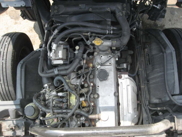

I'm adding a few pics, Of the pump itself and of the engine already in place.
That looks like a mechanical injection pump to me. Although it does have a throttle position sensor, and what looks like an electric cold start advance. The other connector is the fuel shut off solenoid. I think these are all probably just for emissions control or maybe to control the cold start advance. Can you post up a picture of the injection pump part number plate?
There is NO number plate on the pump :( on the first two pics you can see the two holes where it used to be, so that makes it harder. I know the engine runs, just not sure if it will actually perform well or if it will give all of its power.
The electric cold start advance that you mention should be the one in the bottom of the pump right? do you know how it works? voltages and so on? (it came from a 24V truck)

The lower sensor on the pump is a timing advance module, as said above, but I think it is more complex than just for emissions control on startup. That is usually done on the port above it with an ACSD (thermo wax) which just advances the roller ring directly. You can just take it off and replace with pieces from a similar pump, though you'll probably need to get a diesel specialist to check the injection advance and set it (fully manual pumps have a threaded stud and nut to set injection advance by tensioning a spring in that lower bore which dictates the rate of injection advance as internal pump pressure increases - i.e. with engine load).
The other thing I think you can just ignore or take off.

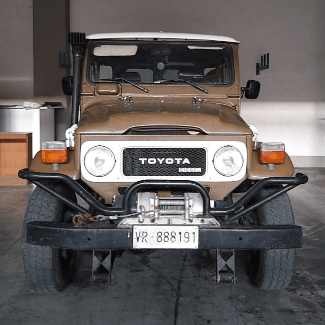

Hi all, avid reader here, first time I ask something though....sort of realted to this thread....have a BJ42 from 1984 with a 3B engine. As I need to overhaul the engine was wondering if with minor modifications you could put a 14B or 14BT head on top of the stock 3B block...is that crazy? scuse my ignorance.
Hi all, avid reader here, first time I ask something though....sort of realted to this thread....have a BJ42 from 1984 with a 3B engine. As I need to overhaul the engine was wondering if with minor modifications you could put a 14B or 14BT head on top of the stock 3B block...is that crazy? scuse my ignorance.View attachment 2544346
Piston designs are totally different between indirect injection engines (e.g. 3B) and direct injection engine (e.g. 14B) so the compression ratio would be way off. Bolt pattern is also different I believe.
A definite no.
Thanks for the quick answer! Since I cannot change the block what would you suggest I do to turn this 3B into an engine that gives me a bit more power? Thanks again
Some people turbo the 3B but you're cutting short its lifespan by doing so. Indirect injection engines don't really handle forced induction very well from what I see, even factory turbo engines like the 2L-T and 1KZ-T are weak.

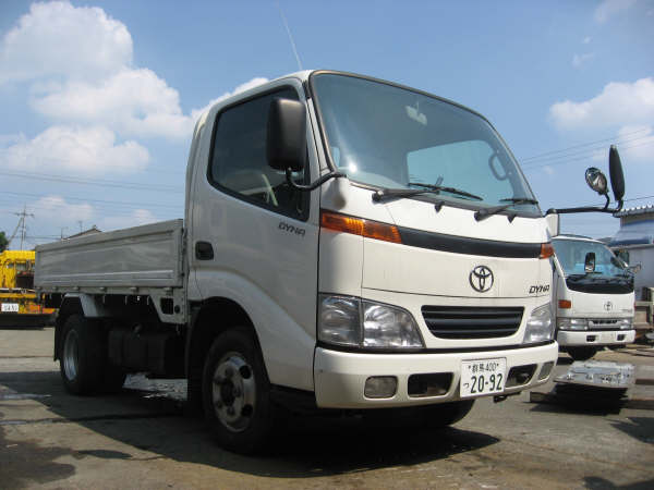

These trucks are the source for the venerable 4B.
3,7 litres engine, 98bhp, 24 Nm of torque (like the 2H)...

It seems that there is another JDM donor for these engines, e.g. this 2004 Toyo Dyna/Hino minibus...
I think there were two platforms, the Quick Delivery/Urban (which gets an interesting Wikipedia page):
And the Dyna/ToyoAce. I think the Dyna and Toyoace were the same thing, just available from different dealers, and came as a single cab or double cab truck with single or dual rear wheels, or even a Hiace-like van as shown in the previous post.
