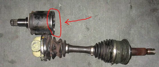

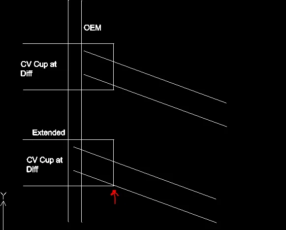

I would think with what you've changed it would be "better" driving normally with the diff drop but the compressed/droop binding could be worse. This is assuming both CVs are not the issue due to wear/tear.
Reason on the compressed/droop is the diff spacer is pulling the relation of the diff output to LCA down which changes the CV angle relative to the LCA and increases the CV plunge as it cycles through the travel. Angles will be better in droop naturally but but are you binding on the outer due to angle or is the shaft hitting the cup? I can see having an extended shaft and diff drop making the cup contact worse by pushing the cv shaft further towards the cup. (Drawing not to scale... but shows the theory.)
...All that to say droop is likely the problem. Things already get tight at stock width with "mid" travel coilovers allowing more droop and your 1in spacer makes that even worse.
