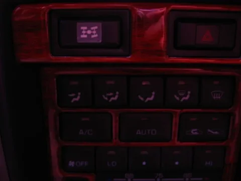

The graphic was copied from Dgranth's post and cleaned up. I had Kinko's print a black surround on a overhead projector sheet, because they couldn't print the white graphic with a black surround. Then I painted the back of it with white out. It does allow light through the icon at night from the dimmable backlight.
The overall appearance is not as nice as a factory graphic because it is sitting behind a lense that has been buffed clean with 600 grit sandpaper. Dgranth's picture above shows what it looks like in the daylight. This might be overcome by placing the decal over the top of the switch and covering it with some high quality clear tape.
#1- Installed
#2- Installed with backlight at maximum intensity
#3- Uninstalled
