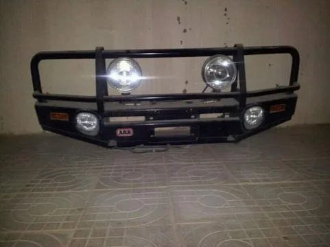

Well i guess I'm half way there with Arb cuz i managed to pick a compressor and a Arb front bumper of this guy who totaled his car and they are in mint condition for a total of 520 us dollars the car used to belong to a fetid before he left the country so I'm shouting what a bargain
Clap
