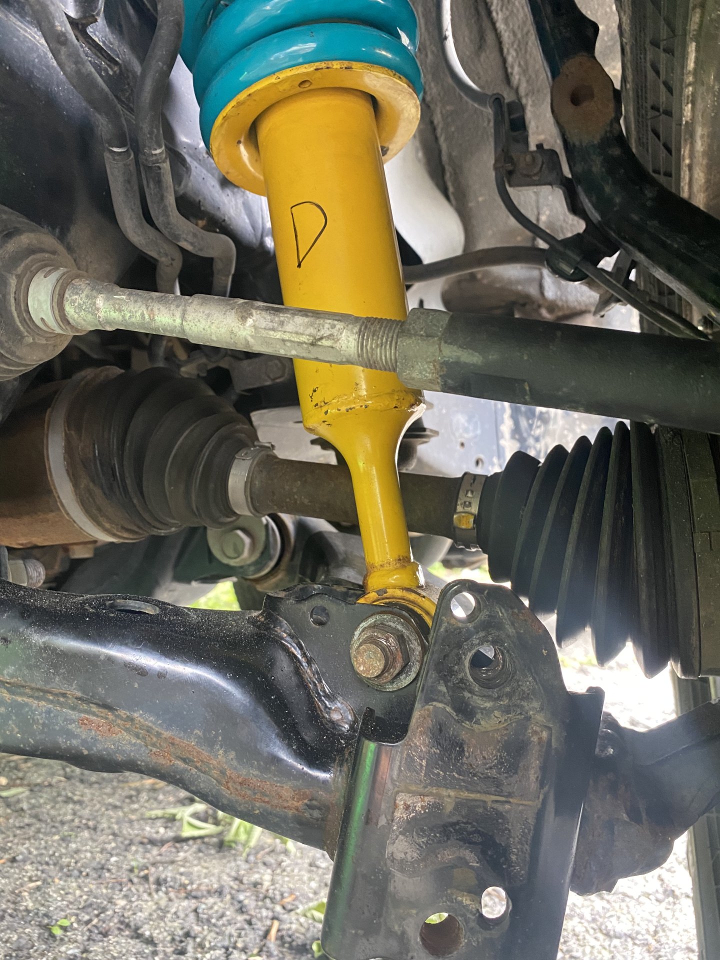

Just installed my front struts from ironman FCP...my 2.5" lift ended up giving me 4" on driver side and 3.5" on passenger....go to install diff drop but see these bolts and bracket attached to the driver side diff mount. What is it? And if anyone did a diff drop what did they do about?

Thank you everyone for responding, it appears the top portion is just rubber, and it butts up against the crossmember, so I think the diff drop should be OK, but tbh I still don't know why it's there, but I will hold off on the diff drop for now, just found out my passenger side's camber/caster bolt is seized.... but it's not too far out, 1 degree.
Reviving old thread. I just went to install the diff drop and came across the same bracket. Has anyone gotten confirmation about it? IMO it feels like it won’t let the diff drop at all because of the center stus?

Might have answered my own question with this picture I found on the Exit offroad website:
Looks to me they take that bracket off?

Where did your sway bar go??
Lol I removed it to install the front coil overs.. stupidly I pulled it from the lca which means pulling it off completely to align it back in. Pro tip, just remove the sway bar from the clam shells… not the LCA
