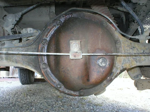

Diff cover seal
I would use a gasket with three bond glue. Honda Yamaha Locktight or whatever you have in the shed. Best be safe then stripping out again for a oil weep.
Same stuff they use on the engine sump would be ok. I dont think synth needs special gaskets. I like using the paper gasket with permatex, always worked for me
There's no diff cover on these 70 series, but if you mean the gasket between the 3rd member and housing then this is the part # 42181-36010. If your cruiser is pre 90s, this gasket is used in the front also. If you have the smaller 8" hi pinion front like post 90s 70 series, it won't work.
On the late 80s BJ74 there is a removable cover on the rear diff, I'm not referring to the 3rd member gasket,
but you're right, the front cover is not removable, that's my mistake for assuming the front was the same.
What is the part number for the rear diff cover gasket?

Semi-float axles. Year model does not matter. Semi-float has a cover, full-float does not.
Full float axles have a spindle on the end of the housing and the hub is running on two bearings like the front axle. The axle shaft does not support the weight of the vehicle and can be removed without removing the hub. This is like a heavy 3/4 or one ton pickup.
Cruiser semi floating shafts are held in by clips at the diff end hence the need for an inspection cover so that the clip can be removed in order to remove the shaft. Full float shafts are not clipped so there is no need for a removable cover.
Full float axles generally are more robust (two bearings versus one) and the axle shaft's only job is to rotate without bearing vehicle weight.
