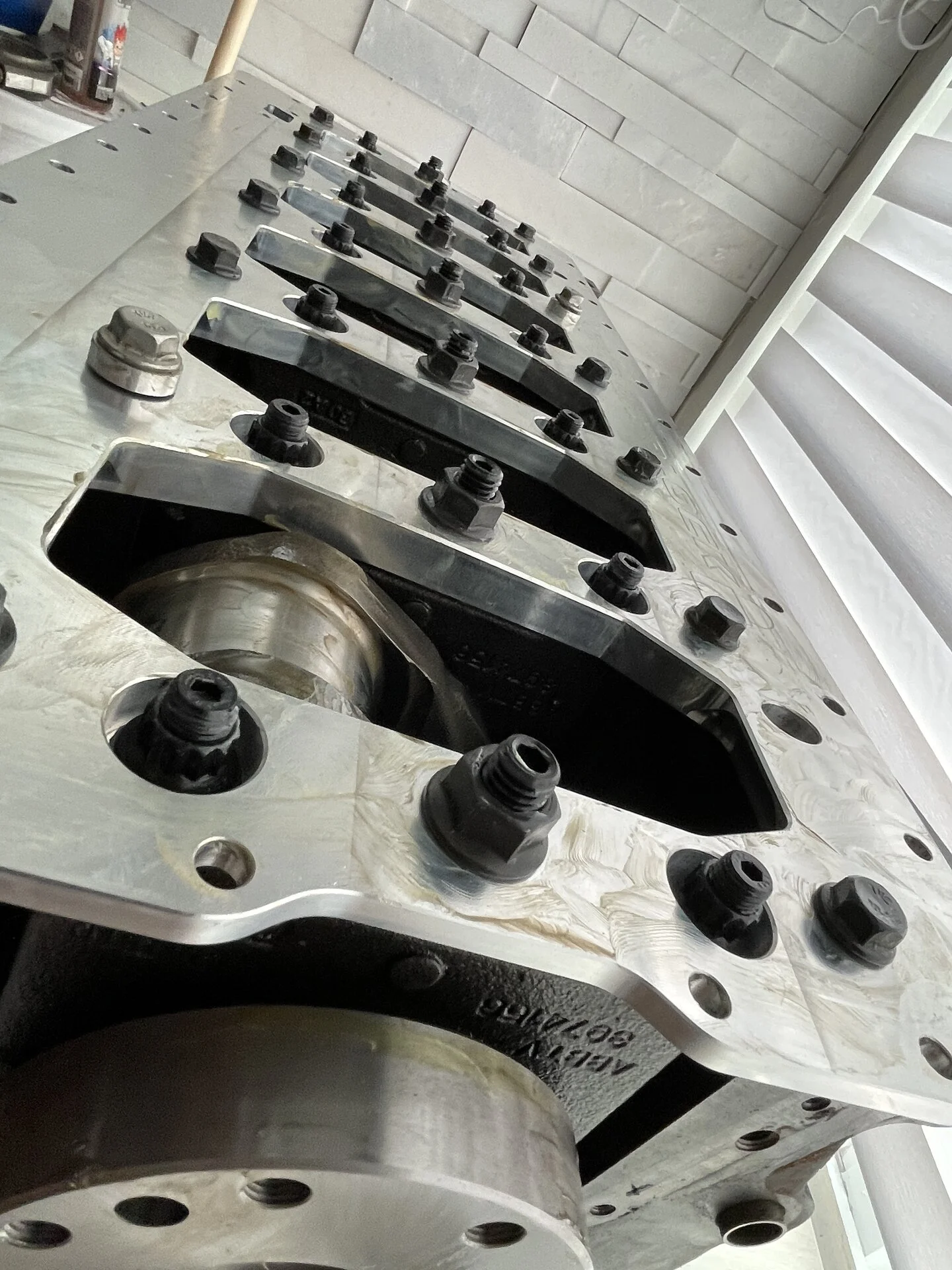

I am building a 6.7L 2016 block currently with Hamilton Race crank and Carrillo hybrid rods/pistons - shaving almost 42lbs of recipe mass :).... not sure if I will make enough power to justify conversion to P-Pump but I love that simplicity of the all gear timing and almost ZERO sensors.... not sure If I will convert the 6.7L to p-pump or keep as CP3 and compounds .... end game is ultra-quick spool and low/mid torque responsive monster.... it's going my tow-pig (Fummins)... target 650-700hp
I love the 6cyl cummins and you are right to call out that it can be handled in many more applications than peeps think... I just tend to "over-do" the fab work and when an engine bay is clear/open I like to add or reinforce the factory frame rails ... what's 50-100lbs of added steel frame support going to hurt :)

singing my language!! yeah, I am very on the fence... as I built the bottom end like it's a sled-puller but don't want that power or smoke... just insane quick spool... and slight concern that I will out ski my ski's (knowledge) of injector, timing, bowl etc as you said... I won't basically a 650hp tuned quick spool tow monster 6.7L p-pump 48v. LOL... guess we will see (I'll up load some engine pics) :)
At the risk of hijacking, my own thread… 😝… who can resist Cummins engine pics??
What cam are you running necessitating those valve reliefs? Compression ratio? That looks like a high RPM build, not so much a grunt DD setup at all?
I've enjoyed the Colt stage 2 grind for DD/towing. I tried the stage 3 Colt and hated it. Lost all the grunt under 1500 and gained nothing until 2500+. Smoked all the time down low. Not good. I've also run 15.5:1 CR on the street and that was another poor choice. Smoked the neighborhood out at every start, but hey, it was an animal from 40-80 PSI lol. There's always a trade off it seems. Regardless of what the folks selling the parts say. I've gone back to the stock camshaft and making the power with careful head port work, good injectors and tuning/turbo for the application.
Maybe I shouldn't say this as I know how things take longer than I expect. I bought a Froude waterbrake turbodiesel dyno cell to test and break in my Cummins engine builds. I'm starting with 12 valves. I'm currently working on the best CNC port/bowl design for the street. All the stuff out there is way over the top for a 5.9 on the street. But a stock head needs a lot of cleanup and has a lot of inconsistency from one cylinder to the next and from one head to the next varies a lot. Especially the new casting heads. They kinda suck.
I've done dozens of Cummins engine builds and found the ones that really put the biggest smile on my face are the ones with the widest powerband. With really nice manners at the bottom, no smoke, but wicked throttle response and mid-top end power. I bought the dyno because I want consistency and the ability to quantify everything is the only way to do that. Plus I hate trying to track and fix leaks in the vehicle and it's a PITA to properly break in rings when you have a un-tuned Allison or other fresh drivetrain parts you are unsure of during the test drive. Also, when you put a Cummins in a 4000 LB early 2wd pickup it's not really possible to load the engine when it accelerates as fast as it revs.
Not gotten there yet on the Cam but had built the last 12v with the Hamilton Cams 178/208 "towing" Cam. Really enjoyed that power band... but to answer your question - have not gotten to Cam selection yet and really appreciate any insight.
Definitely built the bottom end for RPM but that was mainly for my enjoyment from time to time to spin up to 4k on the on-ramps etc or rev matched downshifts and engine brrrrrraaaaapppppp braking. But she has no plans of being high Rev for long periods of time.
"Target" is crazy spooling broad power band with LOW EGT and typical towing load is 10k-12K ... but absolute blast to drive (low smoke) when not towing/loaded.... looking at a professionally Ported or worked Head (open to your ideas here too:)
thx.
