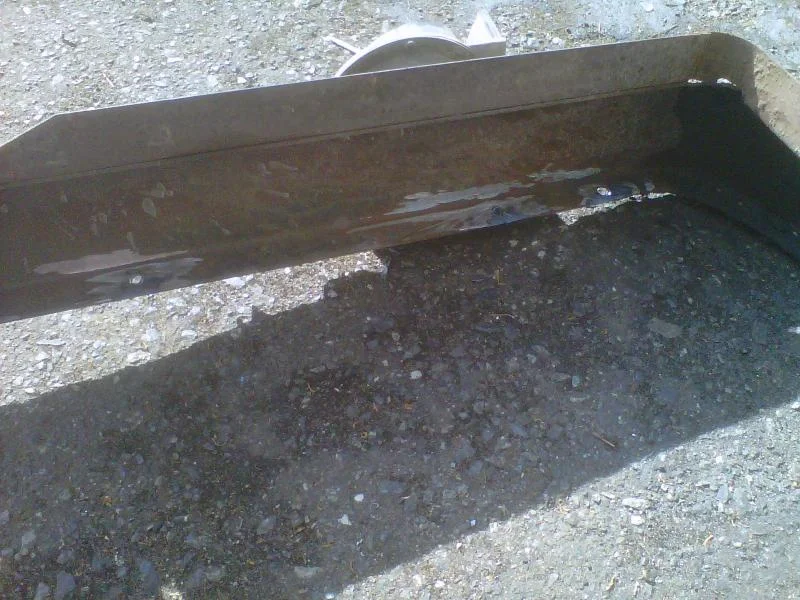

nah, I didn't forget, just didn't realize the damn thing needed such a big bump in it. Wee bit of zipcutting cleared the problem for me. :hillbilly:
the 5 speed crossmembers when you see them do have a big dip, unlike the 4 speeds.
if you have a double cardan shaft it helps to clear it.

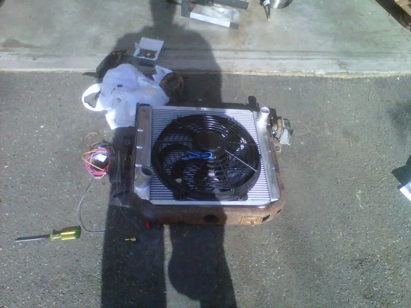

Well its getting closer... I have the fuel lines all plumbed up, the coolent lines are half done and I got my new rad today!
I will have to run 1 cross pipe but thats ok... at less then 1/3 of the cost I'm not too concerned about a pipe.
I decided to have the bottom port on the rad on the correct side and run the top from the right/left
If you have a 40 series with a 2F it would be an easy replacement rad as they have one with the same dimensions but the ports swapped from mine...
To get the rad mounted I ground out the 6 or so set nuts that where on the inside of the old rad holder and trimmed the edges a little as shown in the pictures. Then it just slipped right into the original rad mount. I think I'll add a couple of straps and maybe a couple of random energy suspension bushings I have kicking around to help cushion it a bit and stop it from moving around.
I also went for an electric fan and an automatic fan controller that screws into where the original stock thermostat went (i'm going to a manual set of gauges)

that rad does seem to fit pretty well, where'd you get it?
ah, it's probably ok if you already have them, in theory it causes electrolysis.
it's a big no no on boats, the aluminum rots out around the brass.
it's not great on cars but not as bad. hard to find ones that arent brass.
