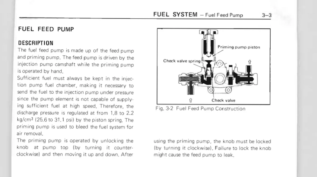

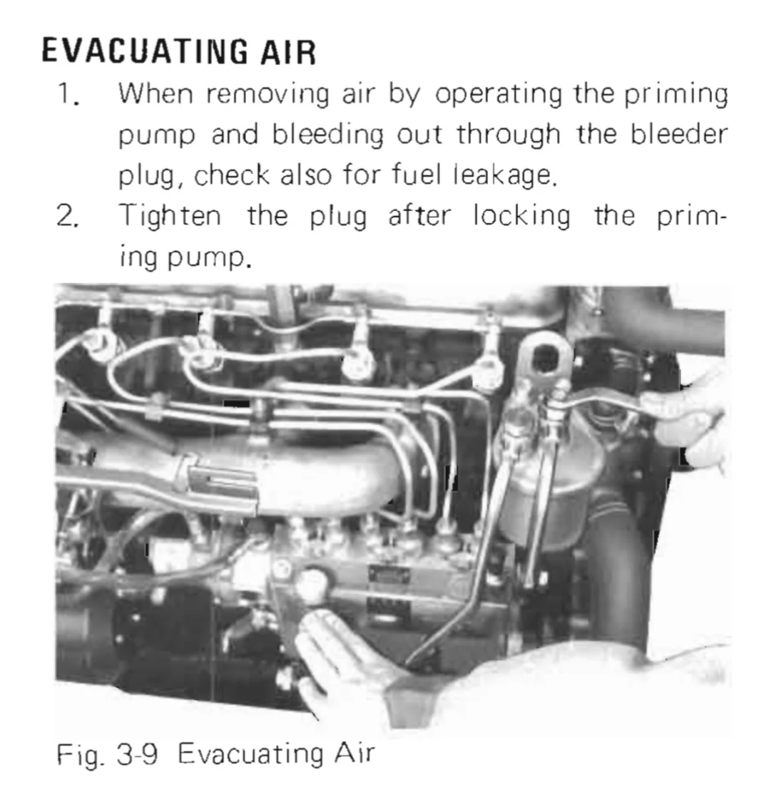

This is from the manual for my H motor. Not sure which engine you have..
Basically you unlock the pump knob, pump it with the bleed screw open, and then relock it as I understand.
I never actually did this so interested to learn more...

Bleeding the fuel filter: get a spare hose and plastic pop bottle, start pumping the manual pump allowing fluid from the filter via hose and loosening the connection. There should be a bleed nipple on the out put hose connection. Bleed the fluid into the bottle, when the bubbles stop and is only just fuel going in then lock off the bleeder valve where the hose is connected and your done. should take about 30 - 90 pumps. If there are still bubbles then you have an air leak somewhere in the line. Make sure your injectors are not loose and any other connections. Over tightening can result in very poor milage.
Let me see if the manual reflects the vehicle, as you know they don’t always look the same, anymore. If so, I’ll go step by step and report back. I didn’t have these pages, which manual did this come from? Looking from my phone at the moment, thanks
Well, I found my H Manual and I also found the page that describes the process. LOL not much to be seen however, thank god for Youtube:
