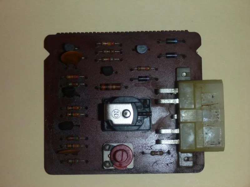

I am using a 12v diesel AC amplifier from a HJ or BJ60 I sourced in Canada.
Recently, I was having an intermittent AC issue and found the AC amplifier connection was loose...easy fix.
But while I was there I removed the AC amp board and cleaned all the connections. That is when I saw the Red Knob! I remember seeing this when I did my swap, but promptly forgot about it.
What does this knob do? Mine is adjusted about 75-85% towards the clockwise stop.
Any advice? Does it work the same a gas model for compressor clutch engagement rpm adjustment?
Thanks
Doug
AC amplifiers are just thermostat control to stop the AC evaporator icing up. I'm guessing that's a temperature adjustment, it may be fine adjust or it could have a decent range.
I'd stick a thermometer in a vent, run the ac on full noise and see what impact the adjuster has. Mark it's original position with a paint pen first.

Here's what the gas version does, but no mention of the red dial.
The chassis manual has a nice section on the AC system, even diagrams the circuit for you. the "magic blue knob" does exactly as mentioned, adjusts when the amp will let the clutch engage in regards to RPMs.
Clockwise=lower RPM
CCW=higher rpm required to run the AC.
The amp gets a signal from the coil, same wire as the tach, that it reads for RPM.
Thermister and pressure switch functions are also controlled in the AMP, it all come down to telling the compressor when to run and when to shut off.
Just remember that to bypass the entire amp just jump the yellow wire to the black with white wire and the clutch will engage when the AC button is pushed, disengage when the button is out.

FIXED MY AC!
I checked things out again today and had the same problem, it worked a few minutes, then the compressor clutch wont engage. While messing around the with the plug to AC amplifier, it made the clutch lock up, but I could not keep it that way.
Well, I decided to go see my AC guy to see what he thought the problem was. We checked all the switches and electrical - all worked right, correct pressures, no bubbles, etc.
Then he started to check the amplifier and the clutch kicked in? Could it be a bad amplifier? Yes bad plug from a corroded used diesel amplifier I bought on mud! It looked kind of corroded when I opened the box, but I was assured it worked...NOT!
Believe it or not, my AC guy had a Toyota AC amplifier board at his shop! It was a little longer than the 60 board and it was from a gas model, but the plug was the same, so we plugged it in...Oh Yes, everything worked perfect, 32 degree air at the vent, compressor cycles as it should, start - stop and it keeps working perfectly!
The amplifier as I said is a gas model from something Toyota with the idle up feature, which is not supposed to work without a coil signal, but it does and I found out why!
I used the stock 2f coil signal wire to connect the hall effect injection pump sensor on the 4BD2
to run my tach with a Dakota Digital signal convertor. This sensor must mimic the coil signal and make the gas amplifier work.
This may be good news for other 4BD2 swappers who choose to the Isuzu IP rpm sensor on their 60's.
Long story, but a cold happy ending for me.
Doug
PS - The new board has the same red knob as the diesel board and has the idle knob on top! Original question...What does the red knob do?

On the 40 series that themostat adjustment is on the left side of the control box, with a hole to adjust. it shows on a sticker to turn it clockwise for cold. At 32 Deg. at the vent you might need to turn it counter clockwise to prevent it freezing up. It controls how long the clutch is engaged on the compressor. That compressor is better than the stock Toyota unit, the adjustment would have to be adjusted all the way clockwise with 60 deg ambient temperature outside for me to get close to that.
Well it still works like a champ! Palm Springs was not near as hot as expected...It was only 98f!
The AC worked great, in fact I never ran the fan above the middle position all day. No freeze ups, the compressor cycled like it is supposed to, so I'm leaving well enough alone!
VooDoo, thanks for the info on the red knob, If issues come up I know what to do now. Funny the FSM does not show that knob?
