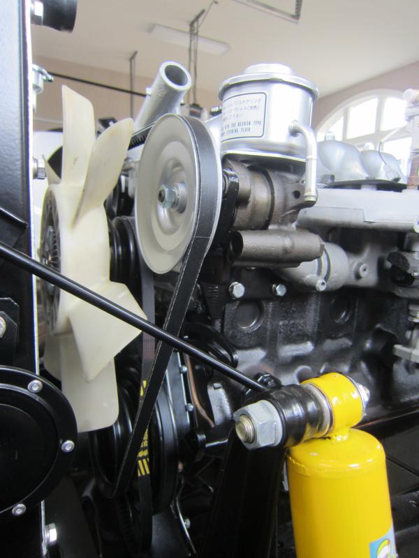

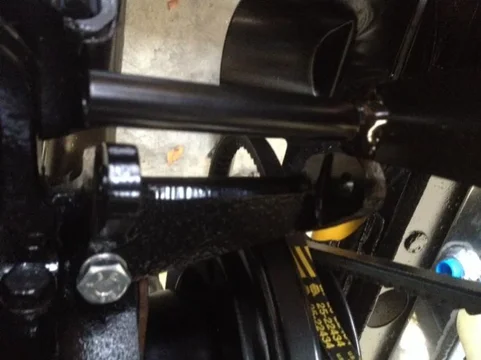

Jim, the adjuster is the original adjuster from the 1980 smog pump - bolts to the lower bolt on water pump. The power steering setup was purchased from a guy here on Mud from his FJ40 part out, think it was an 81, but not sure. Got the steering box, pump, mount, hose, etc. Here are a few pics if that helps. The adjuster is loose at this point. Thanks for your help. Greg
OK, I see what you're doing. The OEM setup substituted the WP mounted AP adjuster arm for an adjuster arm bolted to 2 M8 bolts on the bottom of the PS pump bracket.
FWIW, the adjuster arm should have a spacer sleeve behind it and a longer bolt.

So the big question is will the adjuster arm swivel upward enough to hit the top hole on the idler, and not hit the bottom of the PS bracket? If you think it will, then cut the lower sleeve to length to drop into the bottom bracket.
LMK what you think...:cheers:
Jim, I stuck the pulley in upside down to test the height. It does fit. When pulled to tighten the belt, I have about 1/4" clearance to the bottom of the PS bracket.
I can't see the pic you posted above, but I will order the spacer & longer bolt. Should I try to get the adjuster arm also, or do you think I'm fine with the adjuster I have? Like I said, it's close, but does not touch when tension is on the belt.
Excellent work! Yes, you can just trim the lower sleeve to drop into the bracket, then use the original 75-80 AP adjuster.
