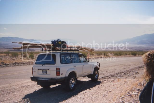

I made a roof rack from aluminium with a floor from aluminum diamond plate. I sized it so it would fit the black diamond lighthouse/bibler ahwahnee tent. I picked that tent because of it's single wall construction and side entry. The picture below is with the roof rack, but with an REI tent on top (I hadn't purchased the BD tent, yet). Unfortunately, my 110V mig welder couldn't do a good job with the aluminum, and some of the welds have since started to break...It was OK sleeping on top, but a pain to get up in the middle of the night because of a full bladder.

Here's a link to more pictures of my homemade roof rack. http://new.photos.yahoo.com/2mbb@sbcglobal.net/album/576460762310066530
