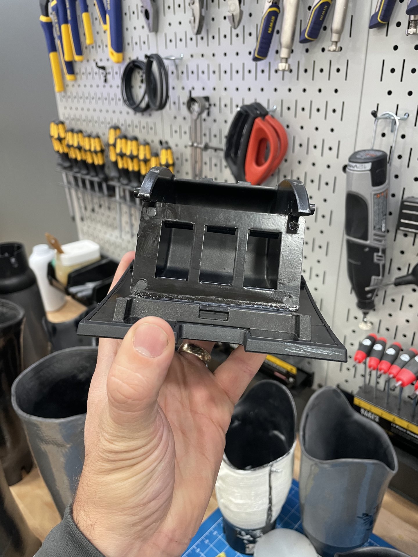

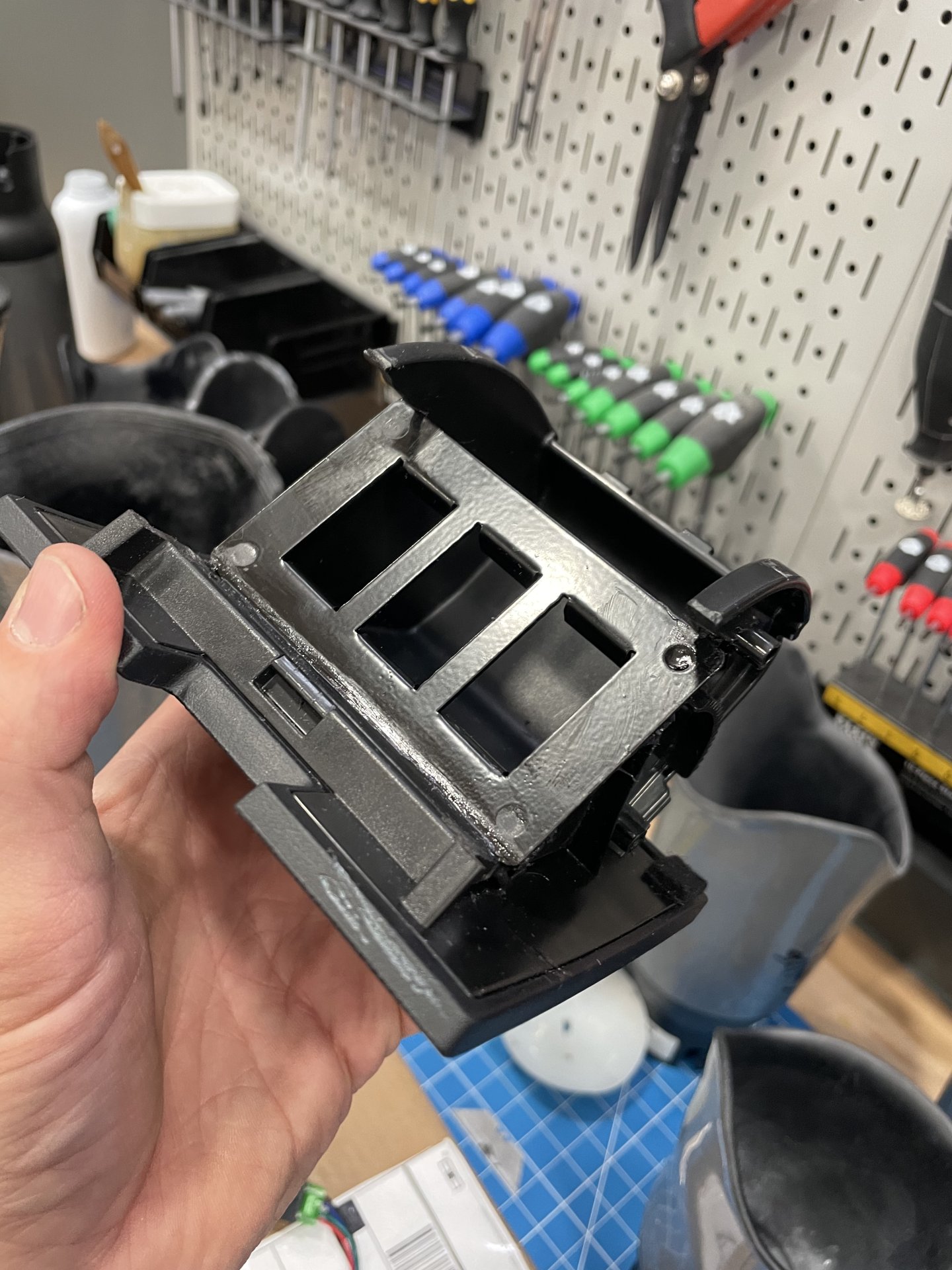

I wasn't sure where or how I would mount it because the dash of the LX is a very busy place and there are buttons and other things in every conceivable location and not really any open space. But I had been thinking about the little pop out pocket drawer thing (I will call it the pocket drawer bc I don't know what else to call it) to the left of the steering wheel. I do actually use that thing to store cash and change but it was really the best option available and it was right next to the firewall passthrough that my wires were coming in from. I took apart the dash and eventually go the drawer out of there, although it was a pain in the ass and I couldn't figure out how to get the whole unit out.
The pocket drawer is absolutely perfect for switches. It holds three across and has the perfect depth for the switches and wiring. And the way it swivels open allows for wires to easily pass through the back of it with out getting jammed on anything. I cut the sides of the drawer out till the brakes sat flush and there was room for the top of the buttons to clear. I mostly used a dremel tool. I was planning on using the screw holes in the bracket as the holes lined up nearly perfect with the walls of the pocket drawer. I thought that I could just add some additional material that way the screws had some thing to bit into. I use a 2 part urethane adhesive (built for plastics) at work all the time that I am convinced is as useful as duct tape. It is thick and sets up in 90 secs so it is good for building up plastic. I started tacking down the bracket and then it occurred to me that I didn't even need to use metal screws at all. I just used the adhesive as if I was welding the bracket in place. It looks damn good in person, even better than the pictures.
The inside of the cabin looks completely stock and the switches are convenient, properly labeled and hidden. I really liked this little mod.

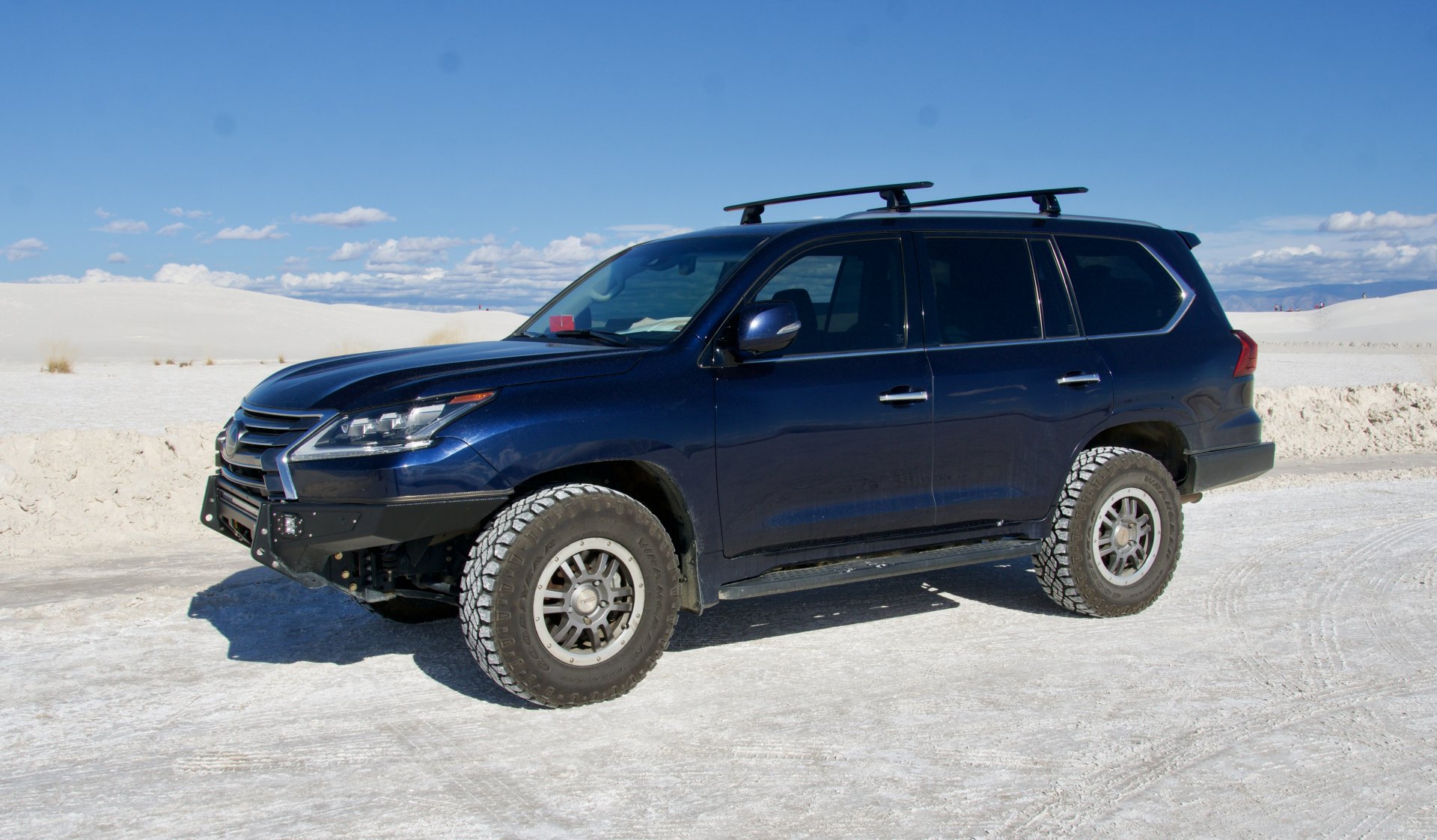

It is a 2016 LX570 in Nightfall Mica with the Cabernet interior. I bought it in 2019 with 28k miles and it currently has ~65k. It has what I consider the perfect options list. I has the Heads up display, the luxury package, Mark Lev sound, wireless charger, and heated steering wheel. However it does not have the rear seat screens and the Cool Box, both of which I really did not want.
I have been driving Land Cruisers for over 15 years and honestly there isn't another vehicle that meets my needs. I road trip constantly so its got to be comfortable and have a lot of cargo room. I tow a trailer thousands of miles a year, mostly in Colorado, so it needs to be powerful (4 runners are too weak). I Offroad consistently (other full size SUV's cannot really Offroad) I live in downtown Denver and work at hospitals so a full size truck is difficult to park (I really thought about a raptor but they literally don't fit in the parking lot at my office or hospital). I take clients out and the Lexus impresses. I can't think of another vehicle that does all that.
