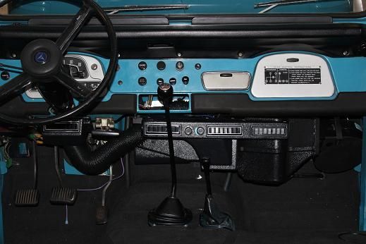

I started on the evaporator installation today and made decent progress. I had to modify the location of the front evaporator bracket by using an existing hole in the glovebox and then hammering the bracket straight (and bending to accomodate the angle).

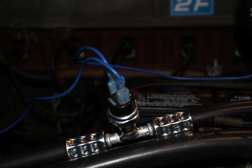

I ran both heater hoses (inflow and outflow) as well as the high pressure hoses to the compressor and drier unit. My brother came over to hang out while I started on the electrical. Most of the connections were common sense but there were one or two that we had to think about for a while. We solved one quickly as we realized that there was a safety switch that came from the cab to the compressor unit. The one remaining question is; what ignition source do we tap the lane line into?
I finished up the night with tinkering with the pull nobs that mount with the dash. I think I may have to grind out the existing holes to accomodate the new ones.
Back to it tomorrow...

I was up late working on the cruiser. Here is what I took care of:
I applied press tape to all exposed metal connectors on the rear side of the evaporator unit to eliminate the condensation inside the cruiser. I drilled a 5/8th hole thru the firewall and installed a drain line from the unit.
I completed the mounting of the unit and installed all of the vents and pull knobs. I had to expand the size of two of the holes to accomodate the new Vintage Air knobs
I need to install the Dayco V-belt (#DAC 22590), connect the heater hoses and connect the remaining VA power line to a ignition source and I will be ready to get the AC charged up.

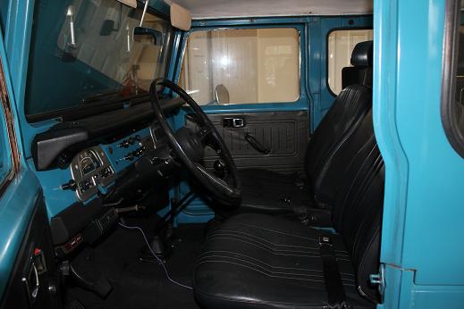

On Saturday I added antifreeze, checked my new v-belt, and double checked for leaks. All systems go. She started up quickly and was ready to roll out of the garage. I drove her up and down the easement next to my house without issue. The bucket seating was a bit rough (home depot 5 gallon bucket) but it got the job done.
I cleaned up the driver's side engine block and headers and put on some high heat paint. Paint, run at idle, second coat, run at idle, knock off the :censor: clip from the oil sending unit etc... It looks decent enough.
Today I put the seats back in the cruiser. She's ready for the carpet (which should be here next week). I checked a few items off of the list but I have alot to do before she's my daily driver.
I will be in Ohio all of next week on business so I will not be able to work on the cruiser. Well, maybe I can get my punch list more organized.
Here are some photos from this weekend.

I finally got an answer to the VA electrical question. It was pretty simple and my lack of electrical knowledge is pretty evident.
The keyed ignition source i was looking for was located, drum roll please, in the fuse box panel. :doh:. A simple plug and play operation and the Vintage Air system was getting power. Now to get it charged and I am done.
Ok, so I was itching to take Big Blue on the road for a proper test drive. I had a heck of a time starting her up but finally got her going.
Minus the front right fender and front grill assembly I drove her around the neighborhood. I got up to 3rd gear without issue on my first test drive. I picked up a passenger for my second spin around the neighborhood. My daughter and I conversed during the trip and I was able to hear her pip-squeek voice over the noise. I am hoping that the carpet and jute backing add to the noise reduction. Overall I am please with the sound dampening aspect of the project.

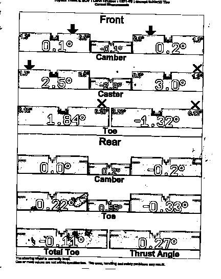

Big Blue was dropped off at Goodyear for a front end allignment, A/C evacuating/charging and quick check on the timing. The initial report on her visit was that there was a bolt missing on a engine mount and that the nut holding the pitman arm was loose. Chalk one up for rookie mistakes. I should be getting her back today with a detailed report of what was done.

Allignment - I posted a picture of the allignment report from the shop. As you can see, they weren't able to get the allignment 100% correct but they were able to resolve the death wobble. I will have ACC in Atlanta take a closer look next week when I drop her off.
