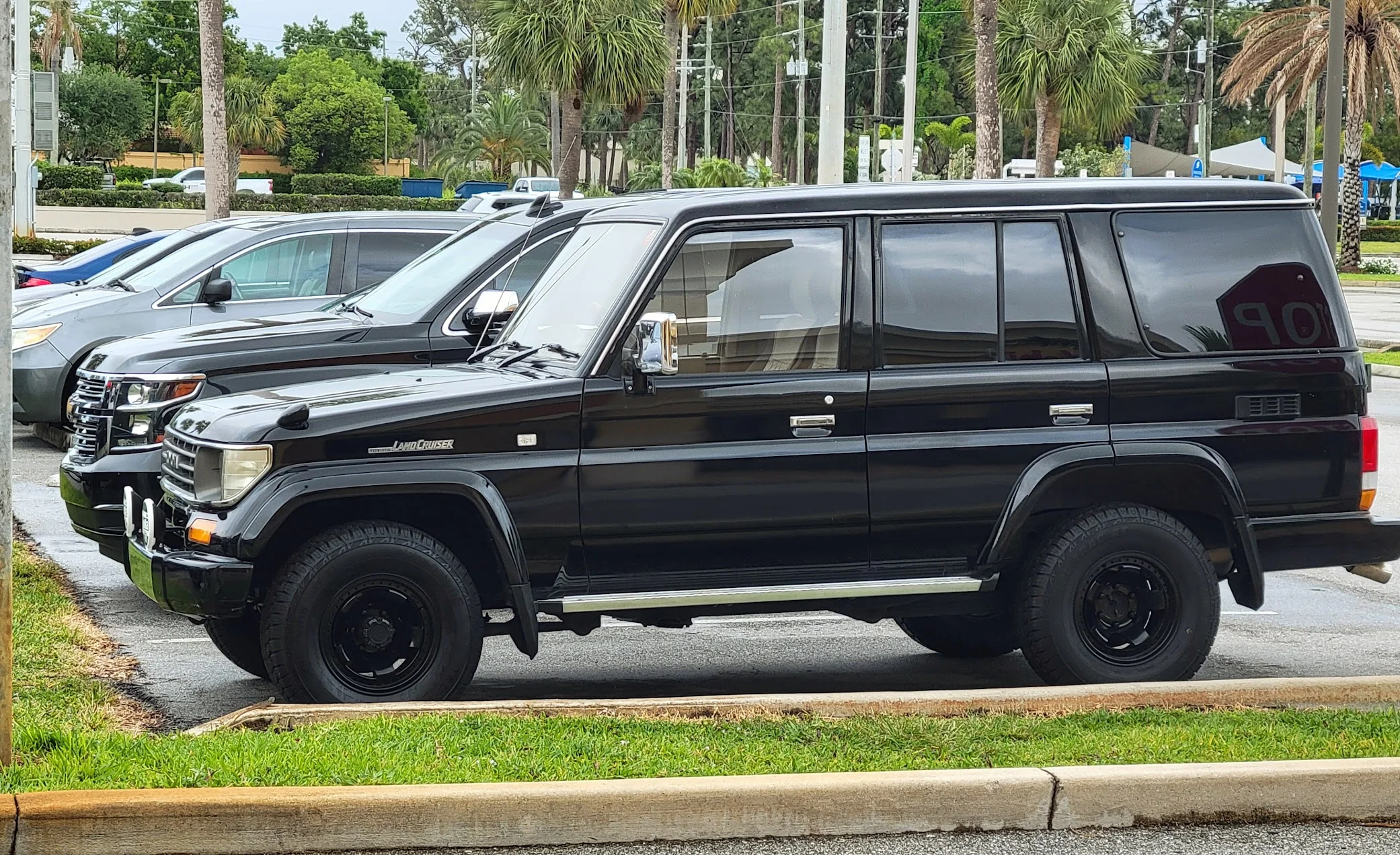

Recently imported KZJ78....took it for a test-drive on Day1 and noticed a steering-wheel shaking vibration around 30mph. Tire date codes dated them to 14 years old.
Installed new (stock size 265/70/15) tires and had them speed balanced. Wheels are not stock and have a little more outward offset than stock. No lifts or suspension mods. Everything (with the exception of the wheels) is stock.
Although the "death wobble" seems to have disappeared @ 30mph, I still get a slight wobble at random intervals, with no obvious cause (e.g. smooth, flat road).
I lifted the front end off the ground and everything seems tight...no wheel bearing play, no tie rod play, etc.
Is this issue indicative of a bad steering damper? The installed unit looks stock/original as far as I can tell.

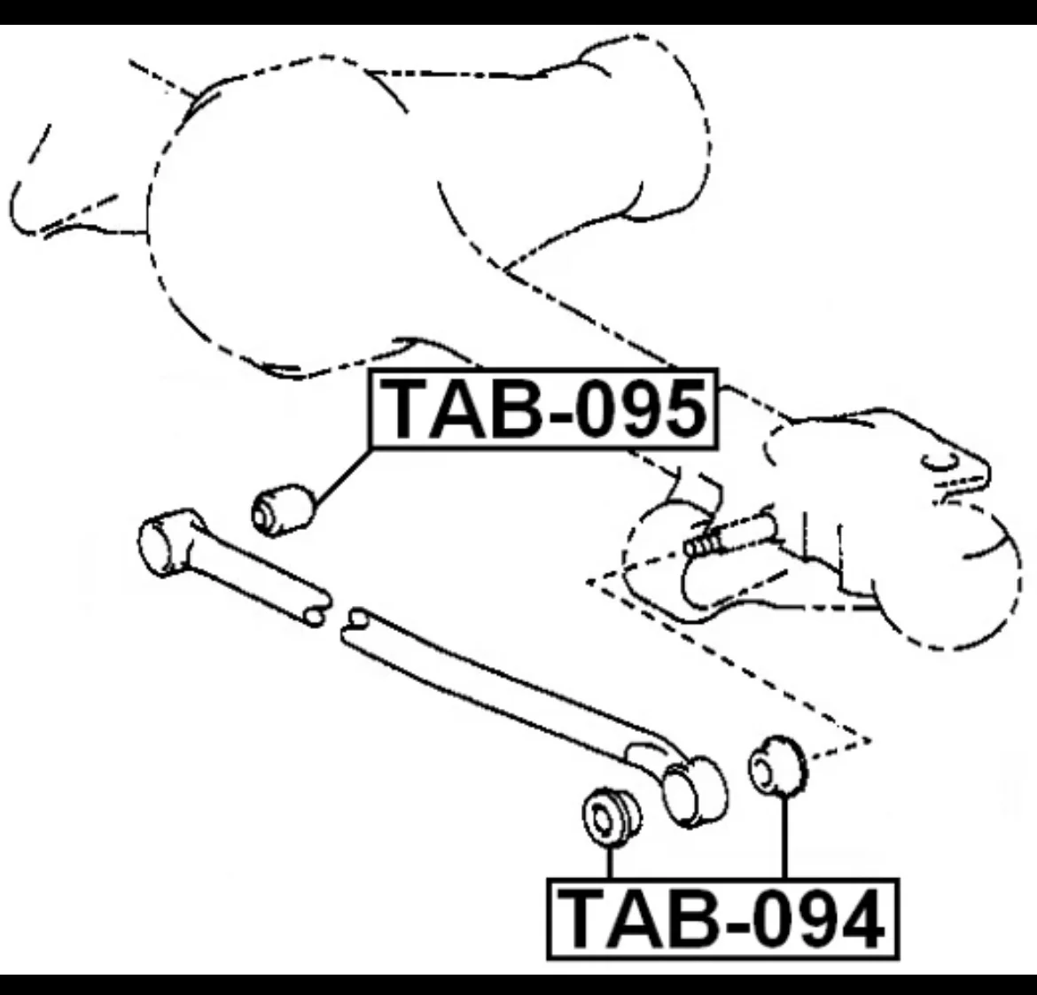

Before you replace the damper, take a took at the bushing on the track bar up front. Mine had the same wobble and turns out the bushing was toast.
Reference Tab94 in this photo. Have someone turn the steering wheel back and forth as you lay in the ground to see if this bar has play. If so, they are really easy to remove and replace. No press needed.
Edit: forgot to mention you need to order two bushings for that one side
bushings bushing bushings...
they are the first parts to change in order to deal with the death wobble in my opinion.
i changed the bushings in my panhard rod, stabilizer and side arms and the death wobble is gone.
I had really bad death wobble in my LJ78 checked al the bushes and they all seemed ok (replaced the arm bushes as the weren’t the best) even did a front axle knuckle rebuild, bought a new damper and destroyed it in a couple of weeks. Turned out someone (not me) had not put the larger washer on the back of the pan hard rod bush (TAB-094) sorted that and we are all good.
