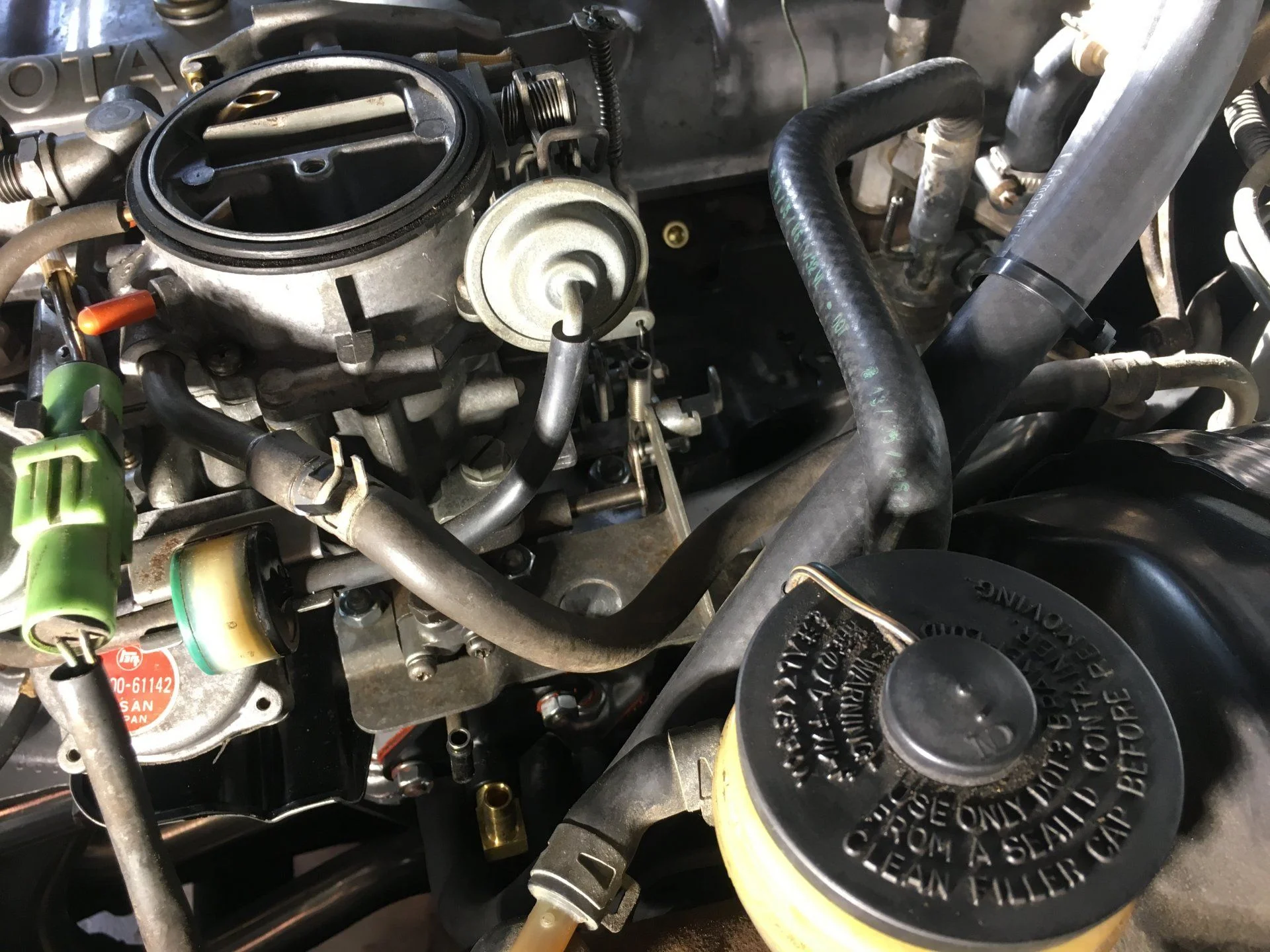

Ok back in the weeds!
A couple questions-
Is the hose off the firewall to the large port to the right of the the green electrical connection correct?

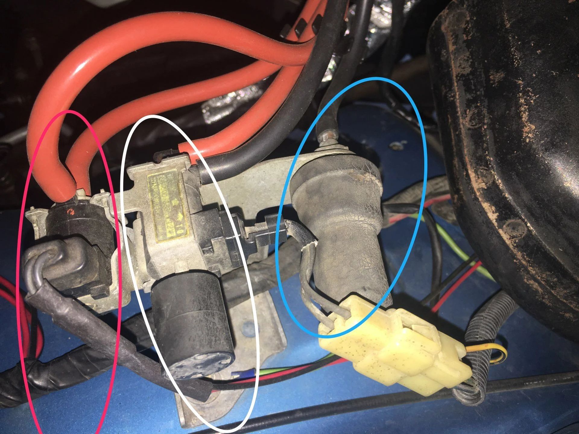

Then I cannot figure out which of the switches on the drivers fender is the AC idle-up, there are 4 that look the same to me. Then do I need the other 3?

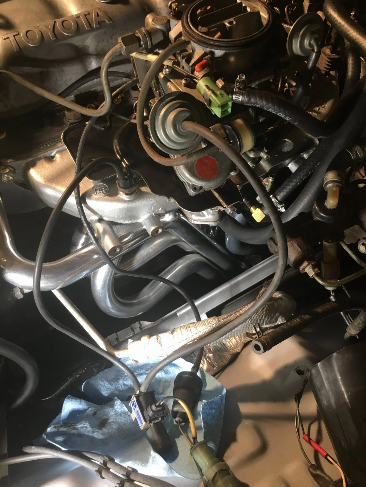

Also, don't run manifold vacuum to the distributor advance diaghragm, that needs to be ported vac off the carb. You DO run manifold vacuum to the VCV (under aircleaner) port S, that vents the distributor.
No I was just going to ask that, thanks! Where does that decel line run to? Looks one of the ports on the carb on your drawing.
*edit- got the decel input to the carb, top left port facing the head, shown in pic below
Also, what is the switch right above the decel in your last pic?

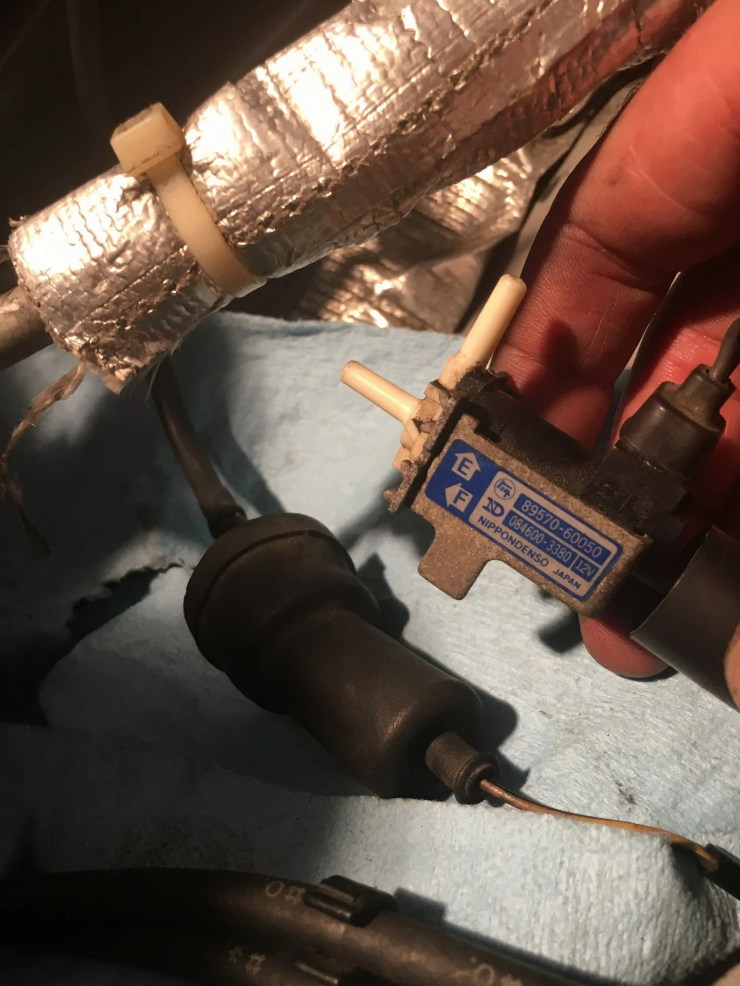

-What/where is the primary vac advance?
- which AC idle-up line goes where? (See pic)
-what goes into the gas filter 3 prong? Might just need to re-read my own thread for that one.

The AC idle up line from the manifold goes to the outside port on the switch (the one that holds vacuum when there's no power to it). The one from the carb diaghragm goes to the other that doesn't hold vacuum with no power.
Ok does this look correct on the ac idle setup?
Normally you'd pull vacuum for the AC idle up to the smaller fitting on the back side of the intake manifold (adjacent to the brake booster vacuum port) instead of the gas filter/front side of intake manifold, but the setup pictured is essentially identical in terms of functionality.

The large hose you mention is the other EVAP hose that runs to the carburetor. It looks correct but I've got a Trollhole carb and can't cross reference my own engine to be sure.
