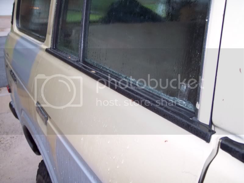

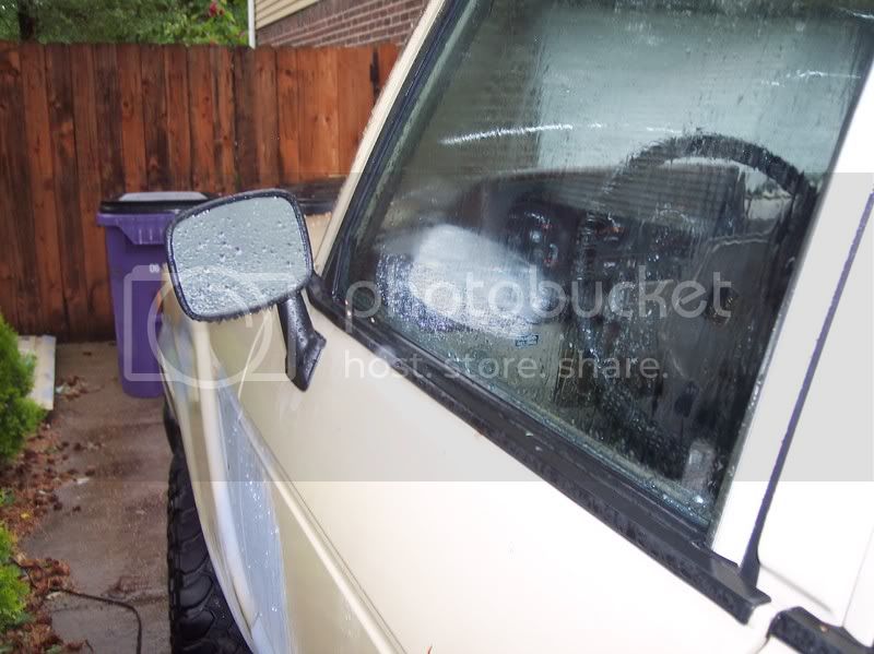

I Painted the bottom chrome/stainless around my windows a while back -
Photos -
