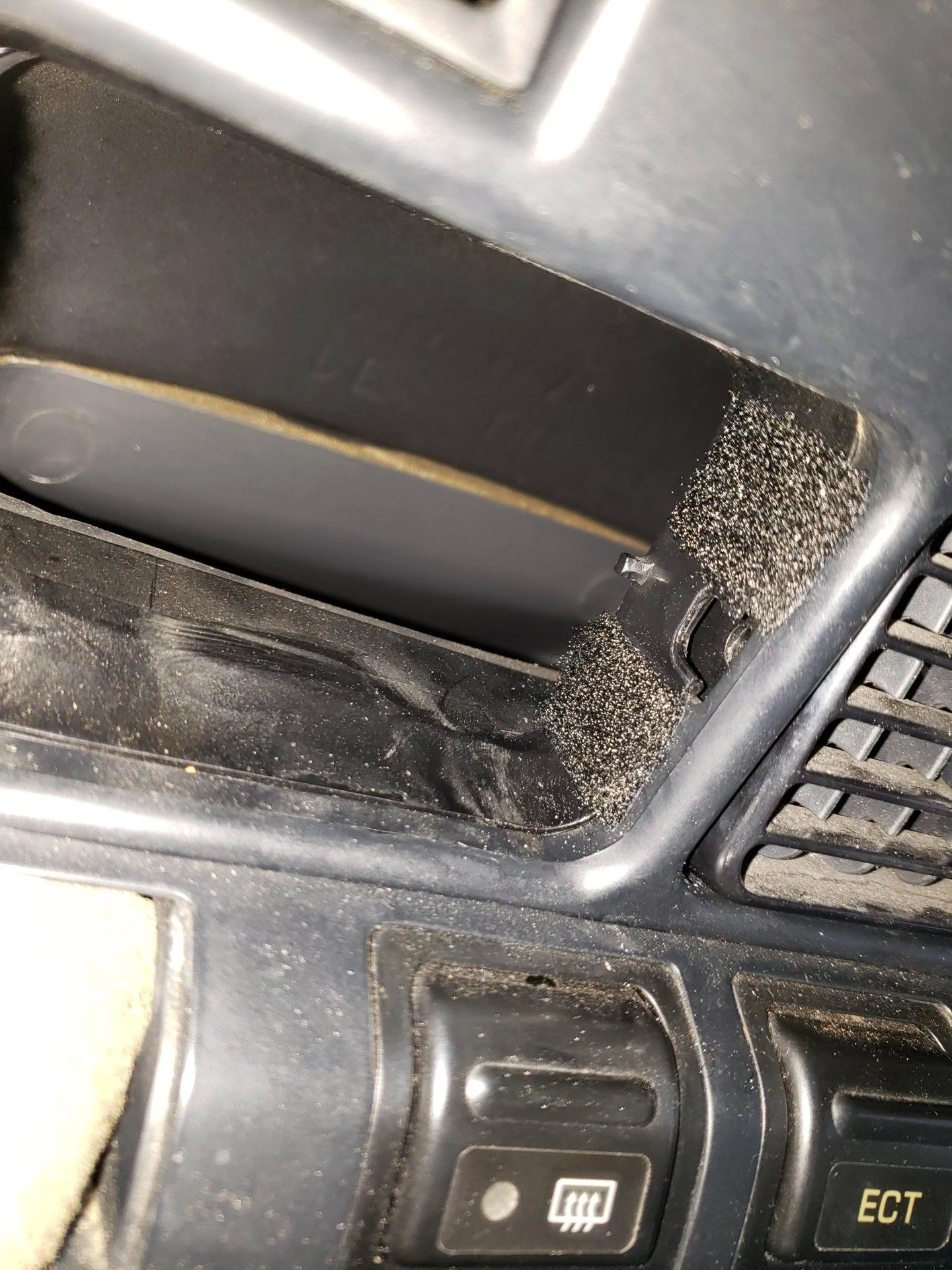

An easy and very inexpensive fix is black felt (like what is used under lamps and stuff) I found in the crafts section at wally-world.
Just cut small narrow strip, peel backing, insert into gap above and below the vent and carefully press into slot with thin tool, preferably wood.
It mimics the original felt perfectly and no one can tell it's there.
I din't have now a close pic .. but here is the idea .. if you do it carefully .. it looks totally clean.

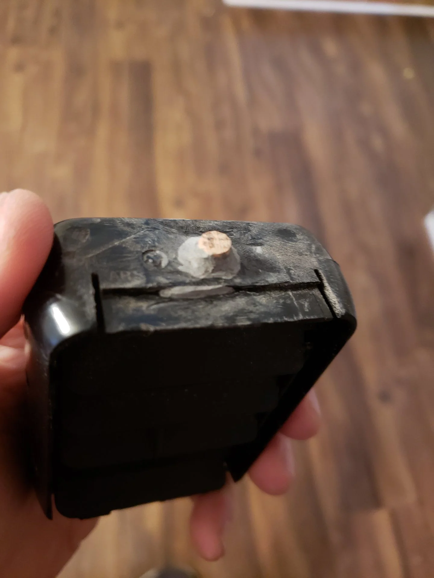

I just took them out, removed the little broken studs, put in some little metals studs made from whatever i found in the garage. I used JB weld to place them and build up the diameter. Then i just sanded them smooth and stuck the vents back in the bracket.

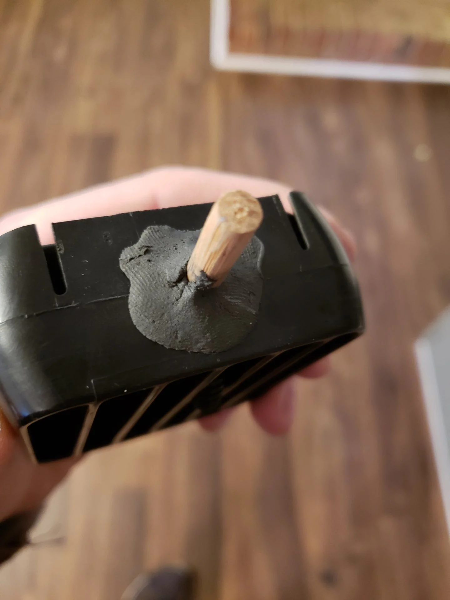

I used a 1/4 inch wood dowel. Removed the vents. Drilled out the spot where the peg broke off and JB welded the dowel in place once it set up, I used a dremel to shape and remove excess material. Also put some loop side velcro inside the vent registers go. Works great.
