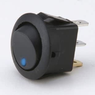

For my auxilary lights, locker control, etc...........I was thinking about these rocker switches. There are 5 different colors, which is perfect.
I have a fog light switch from Mot too :D
