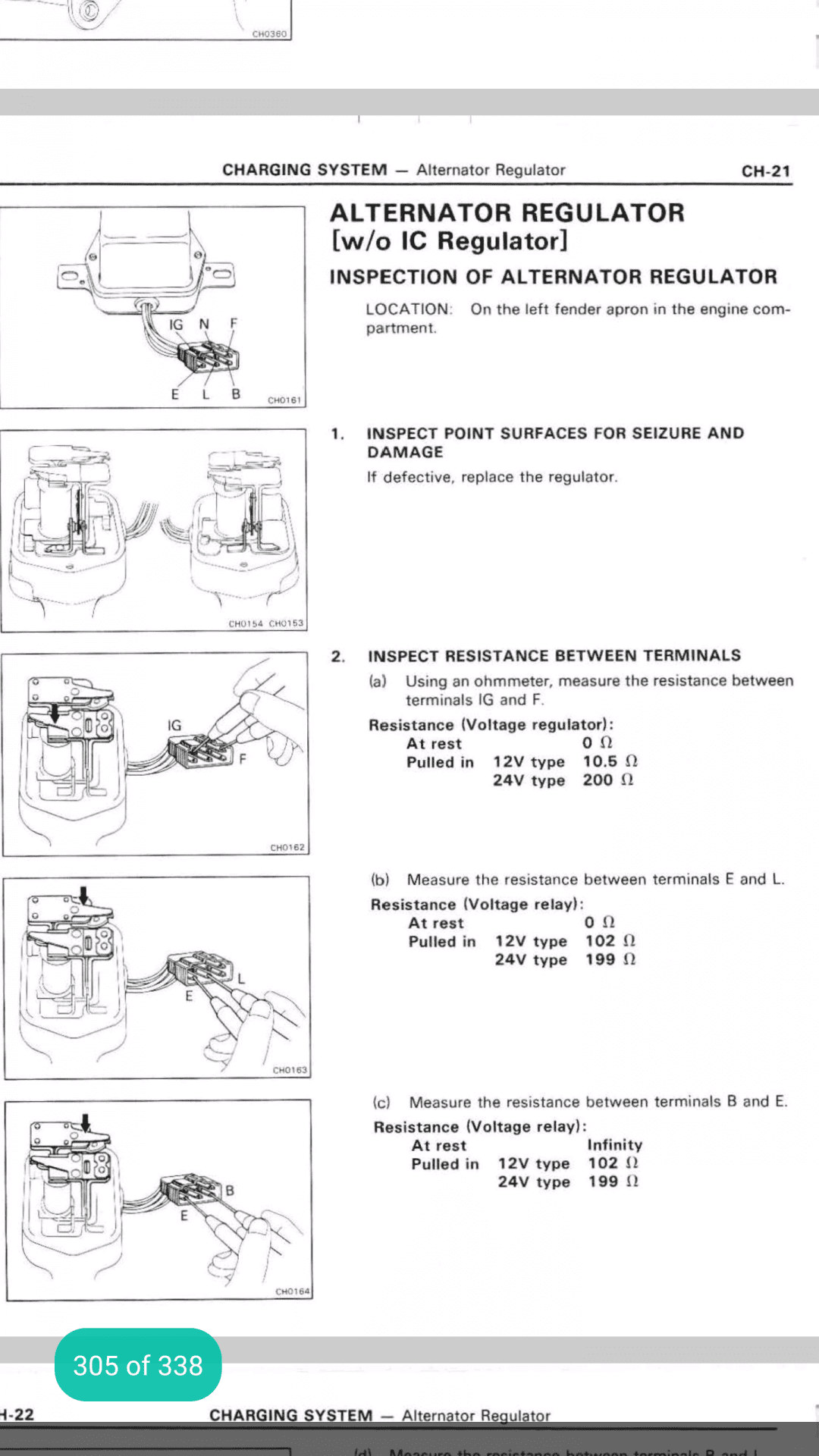

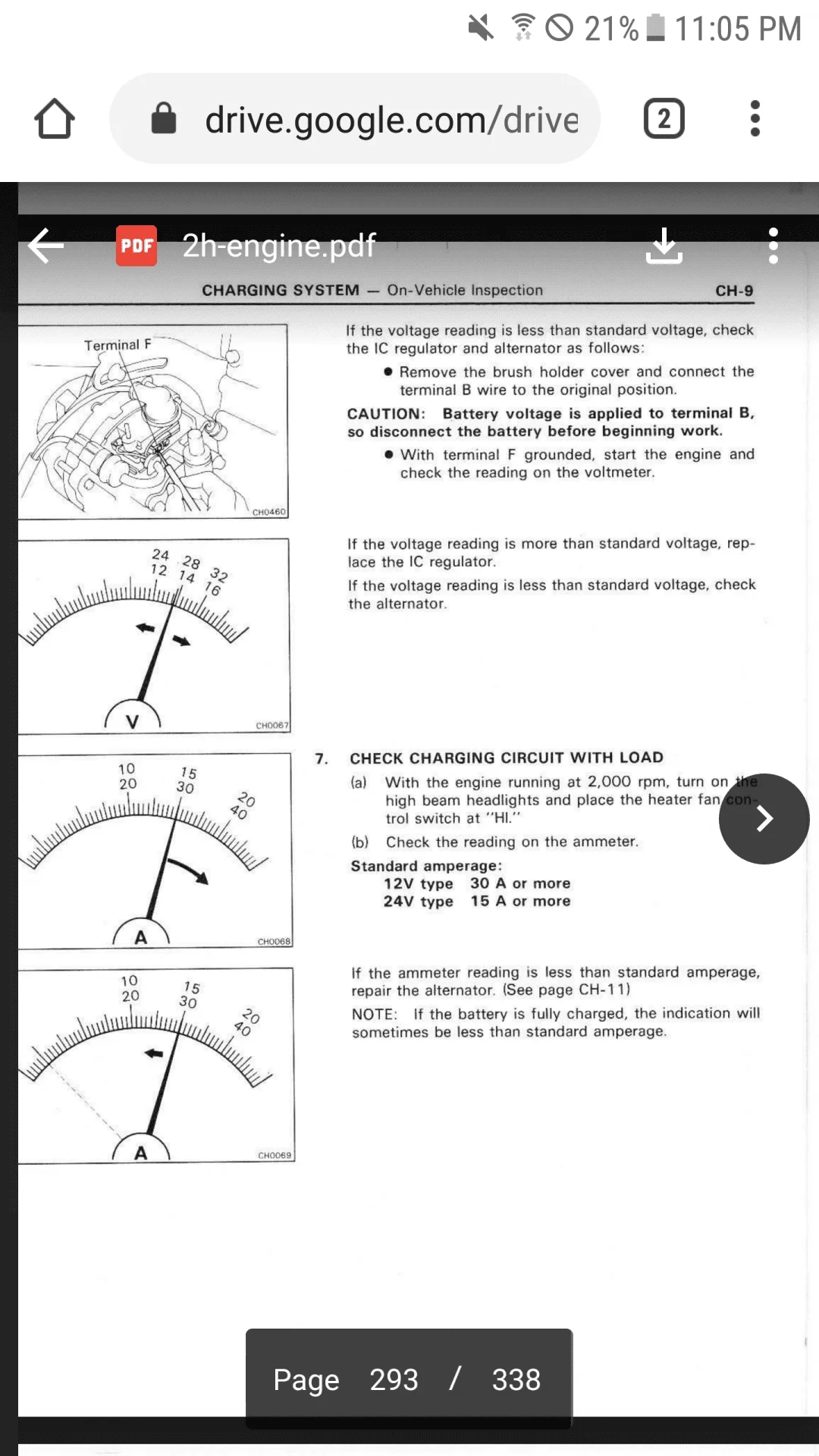

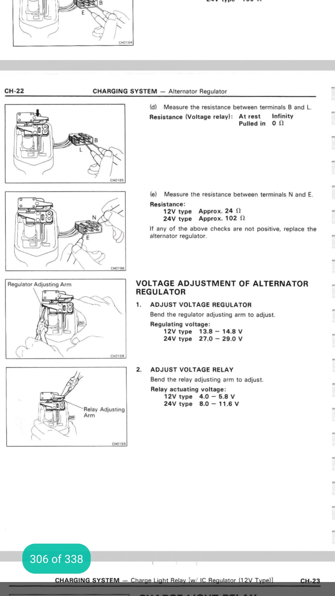

So reading through the FSM for 2H,12-HT it seems the Voltage regulator is replaceable for both internal and external. Quoting the FSM regarding internal type
One last suggestion is measure the actual Voltage with a multimeter at your batteries to rule out a false reading from your gauge.

Followed FSM instructions to diagnose voltage regulator. All of the readings are close, but some were 10% above or below the target.

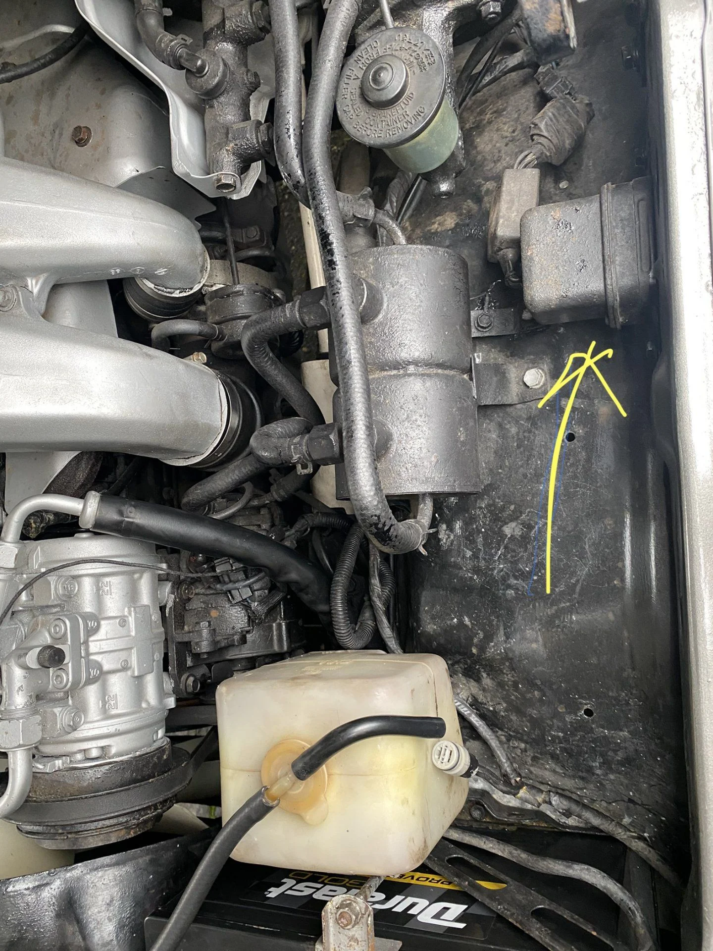

And a little bit of rust inside!
is the external voltage regulator a part that’s easy to find, without being sent from EU?
I believe the regulator output should be 27.5v +-.3v . As the external regs seem to be NLA from Toyota , it would be worth while to take it to an auto electric shop for proper testing to confirm condition. However, it sounds like it was/is intermittent, which could possibly be a poor connection or a failing wire.

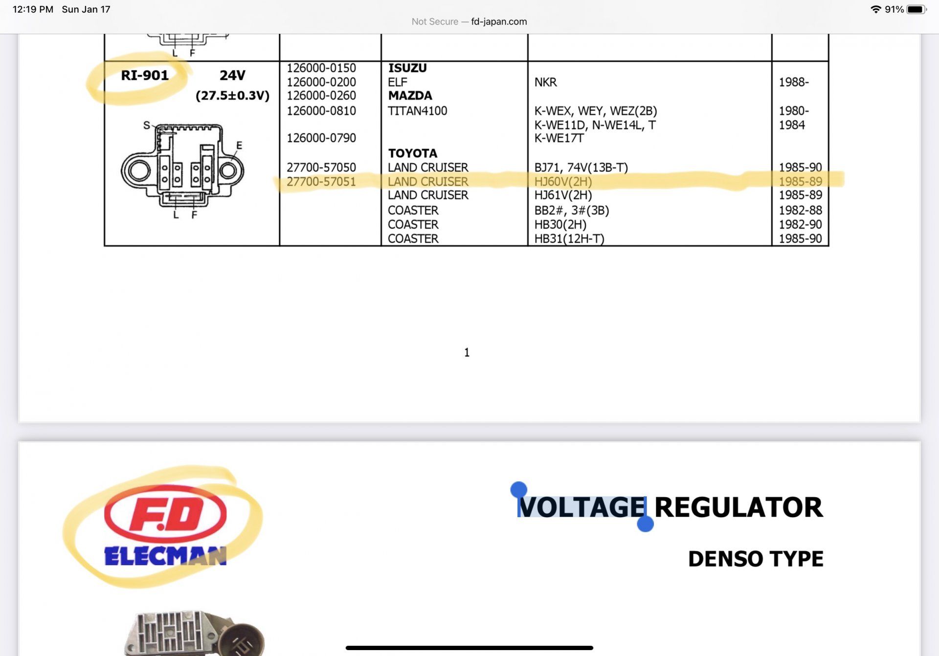

Here’s an option with the same P/N for the 24v 40a regulator;
27700-57051
27700-57051
