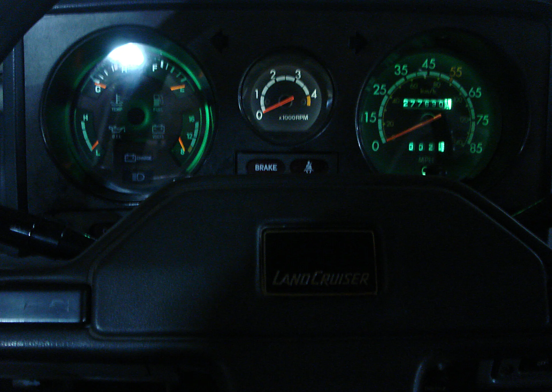

Any auto parts store has them. Ancient design. Remove one & bring it with you. After trying LED options, I opted to keep the incandescent bulbs. To me they looked much better.
The bulb lighting the tachometer I did change to a clear LED and it was/is a big improvement over the dim incandescent bulb. Not too bright. Just right.
Picture shown has all incandescent gauge lights and the clear LED in the tach.

I agree. incandescent dash lights provide a nice light that's not harsh and adjusts nicely. All the LED conversions I've seen were too harsh.

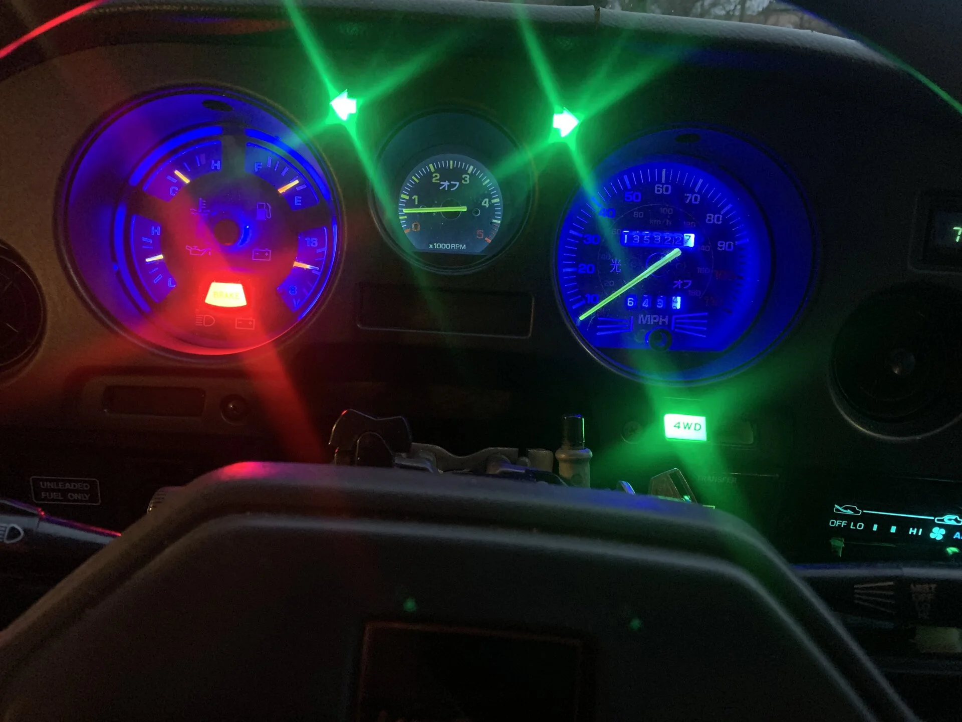

This is the new FAA and USCG wheel house and cockpit night time Illumination LED
Well not all the green and red ONLY the blue …
