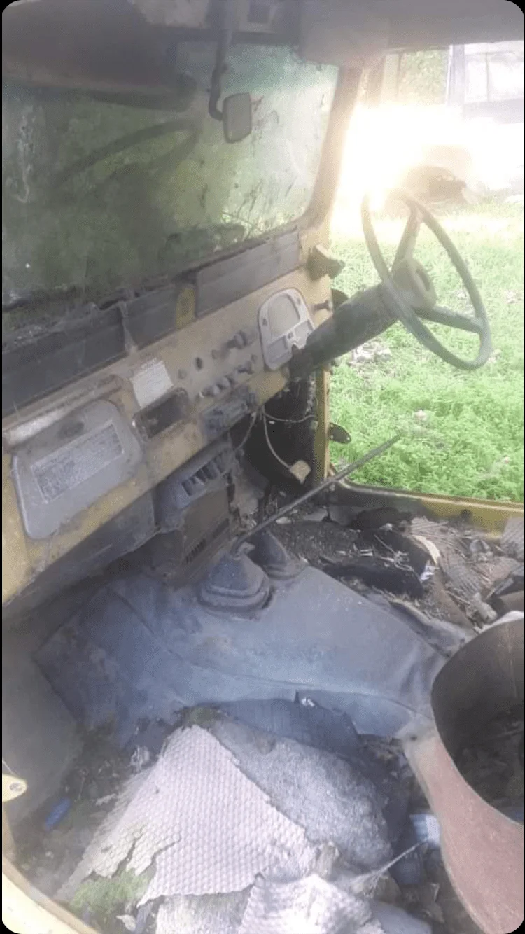

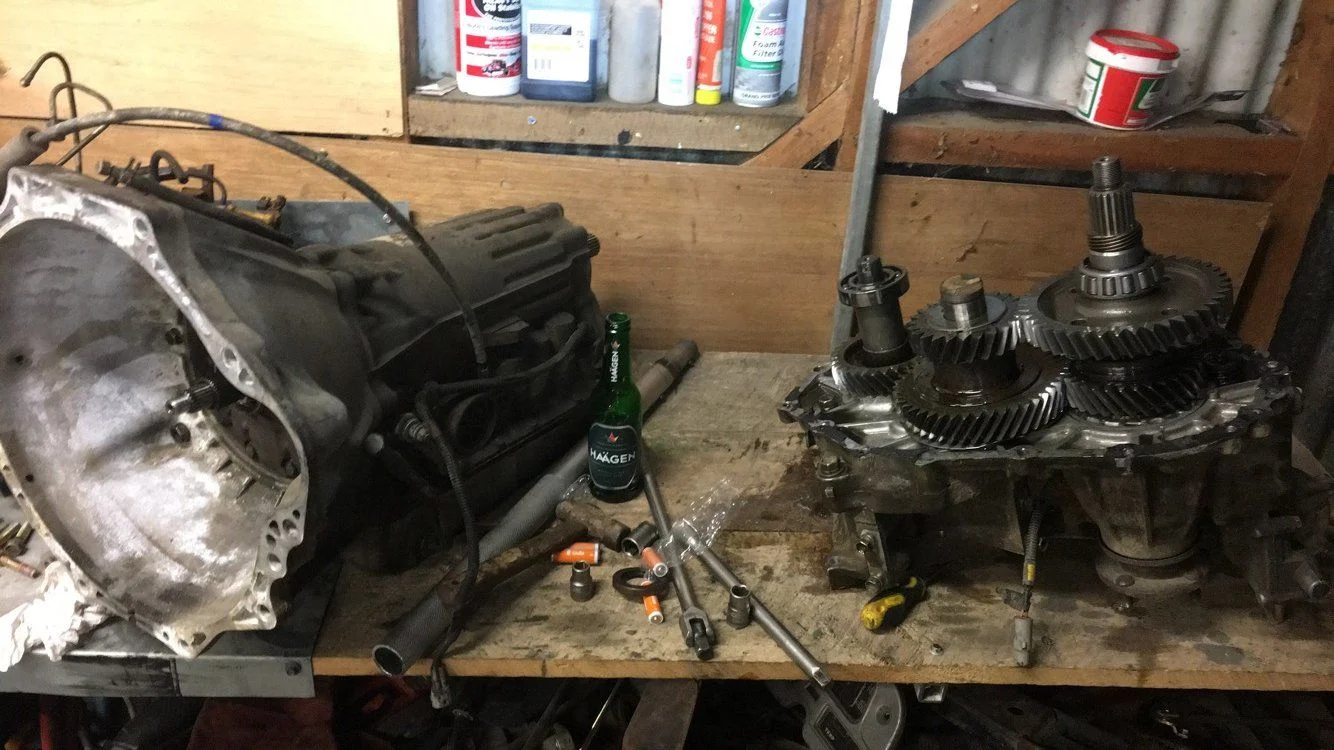

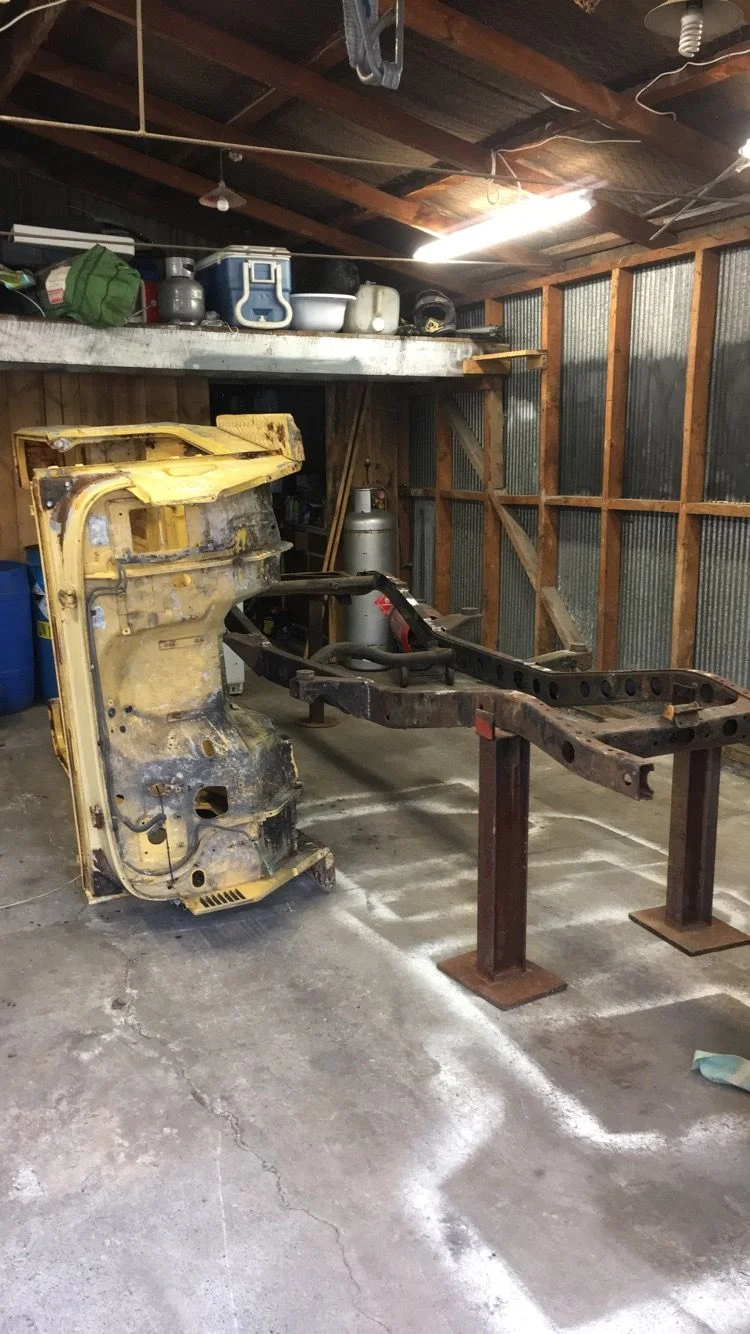

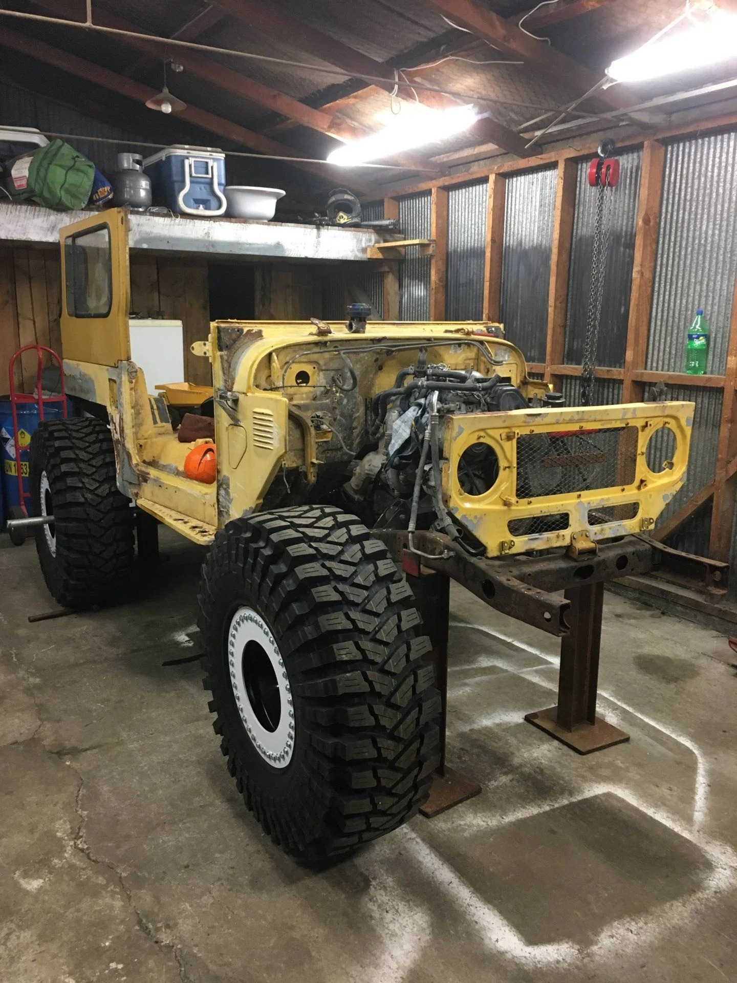

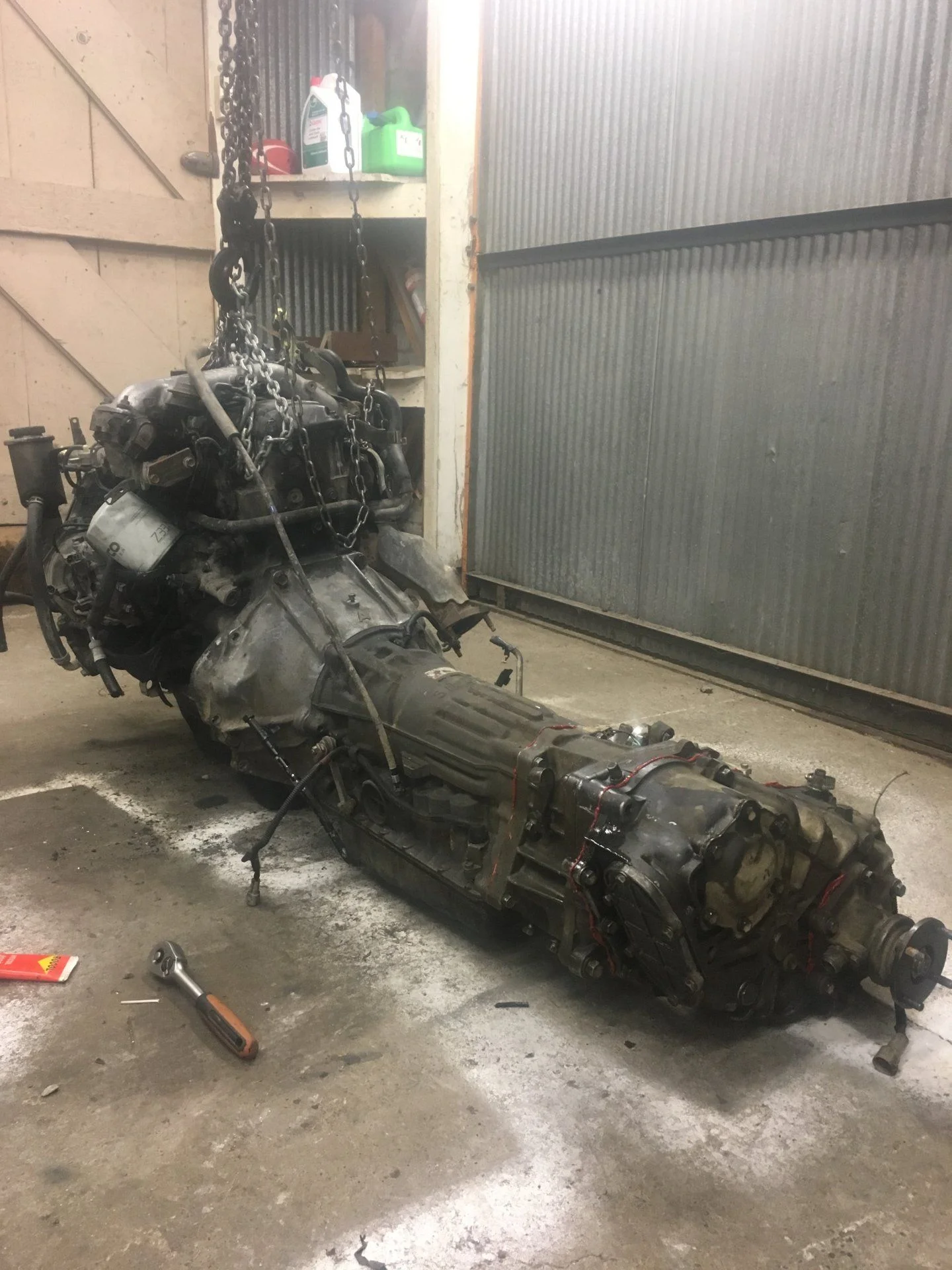

Fist up was collecting a rusty old 79 Fj40 with a hydrolocked b engine and 4 speed gearbox.
I fully stripped it keeping anything that was salvageable. The tub and bonnet were scrapped and other parts that were of no use we’re sold.

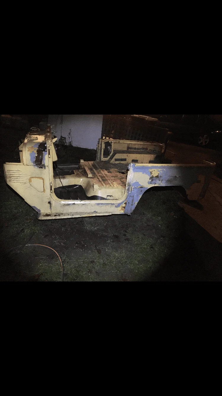

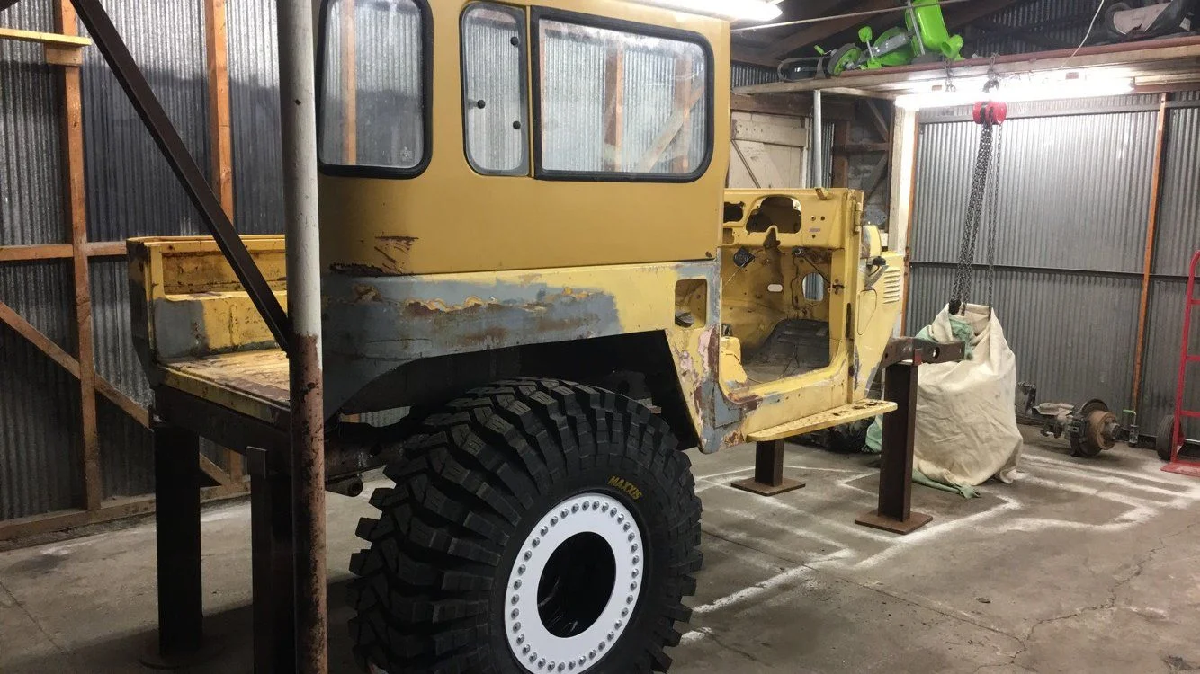

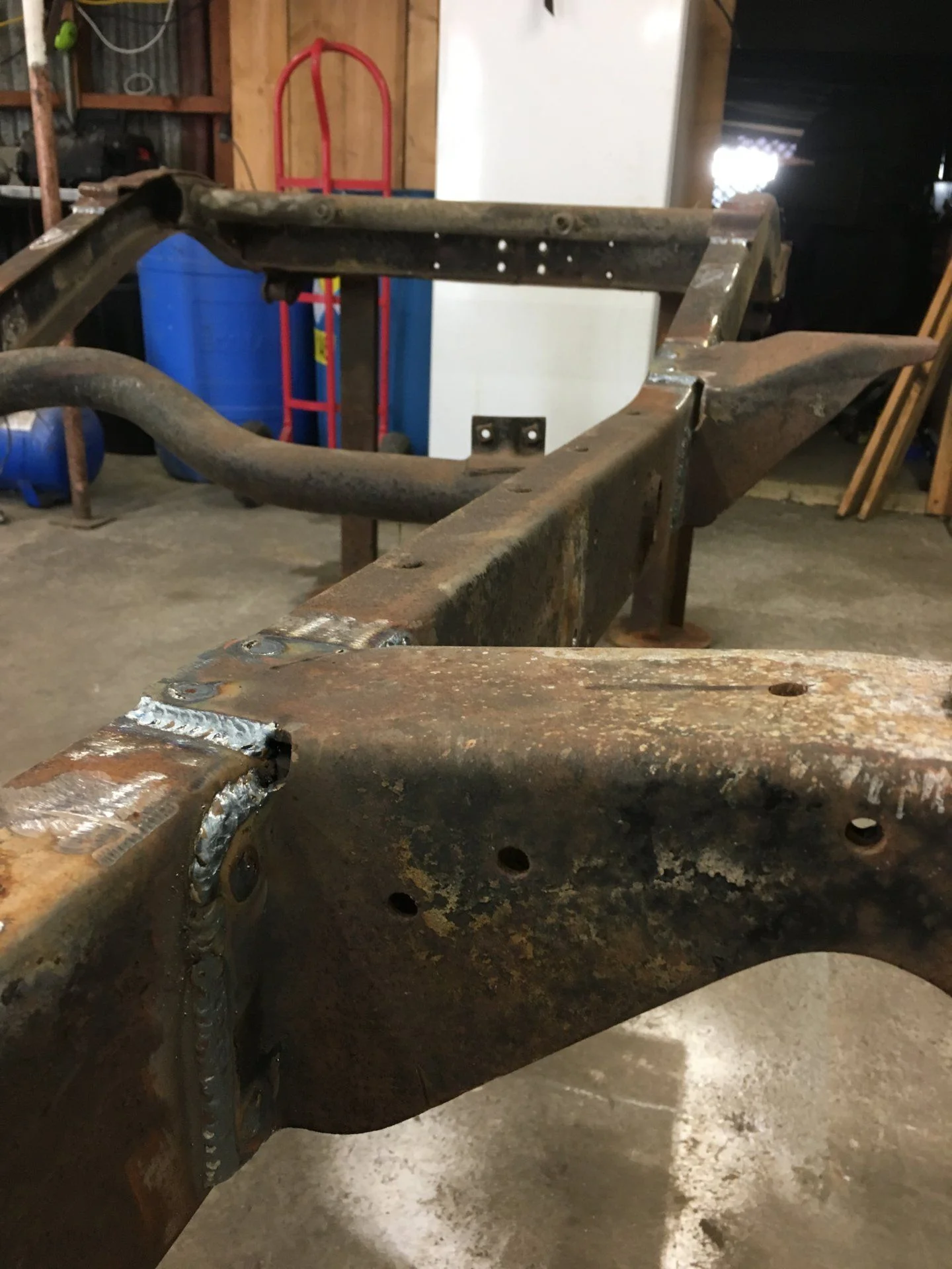

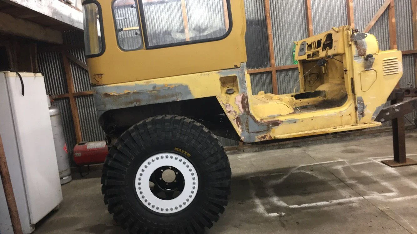

My next issue was finding a fairly sound tub that wasn’t gold and plated. I found this one for two box’s of beer
That should be strong enough, lol

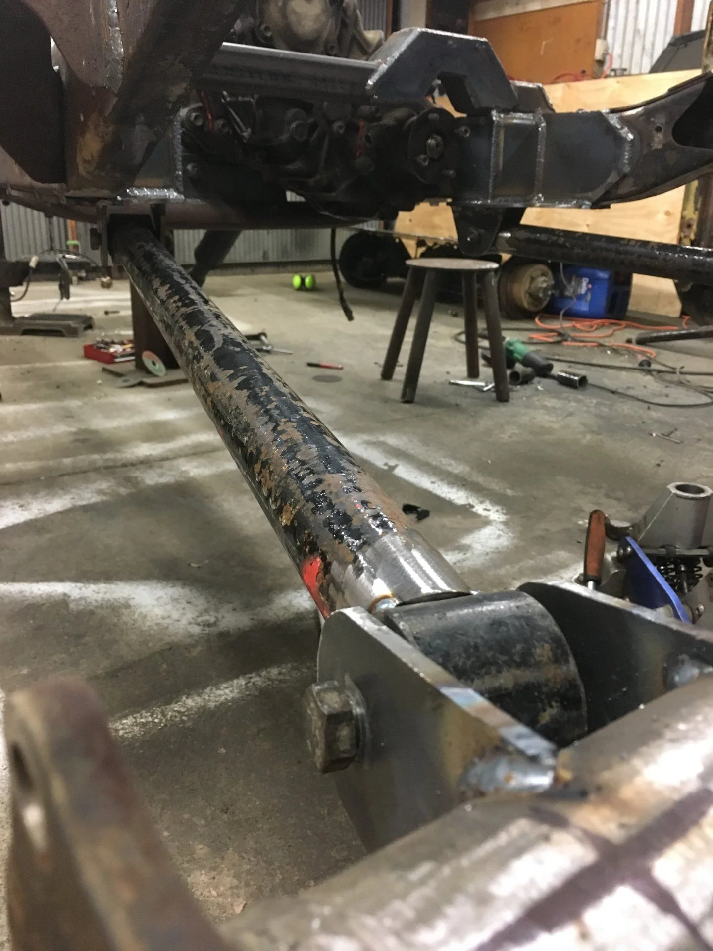

Looks strong but heavy. Weight is not your friend

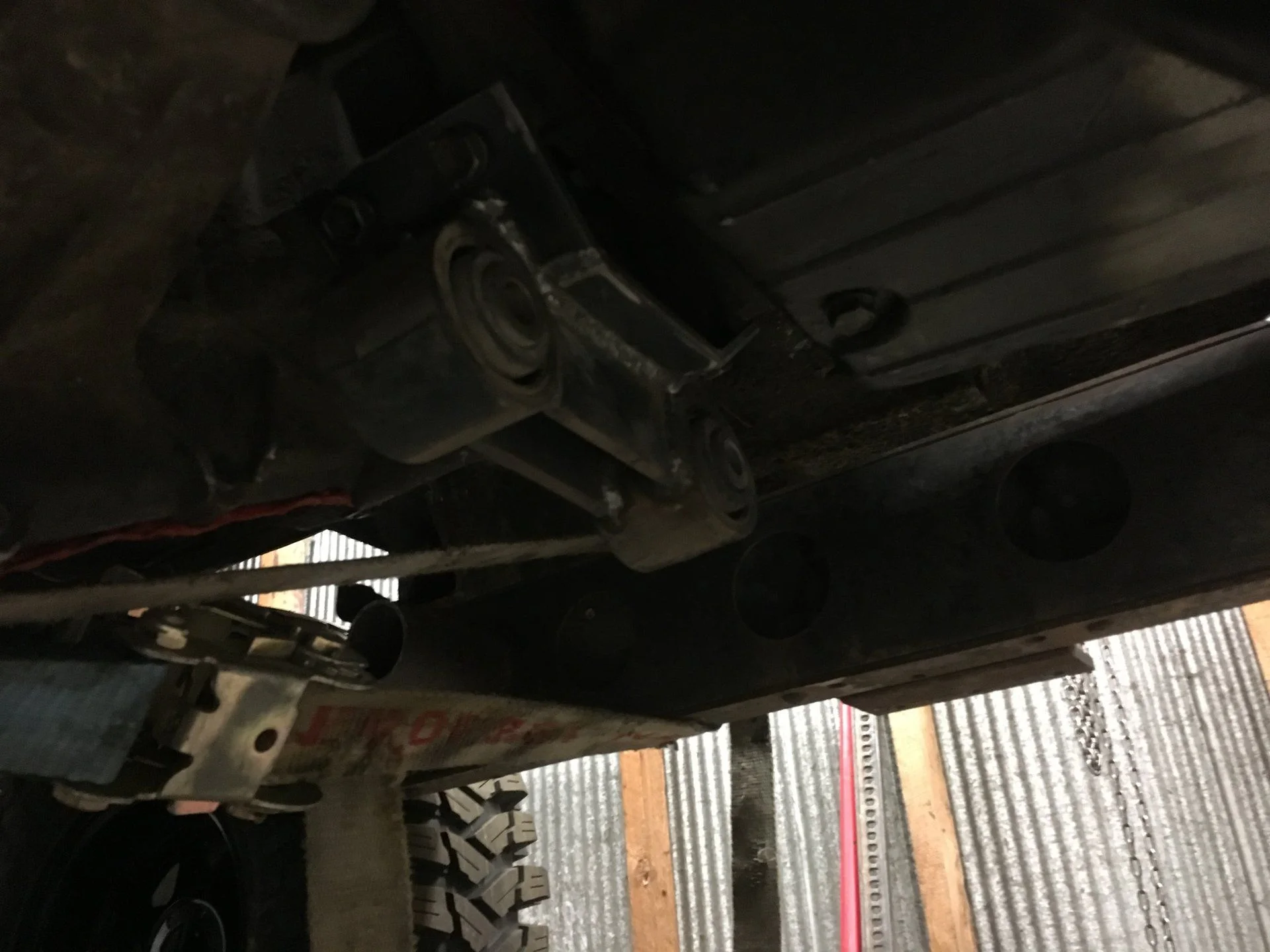

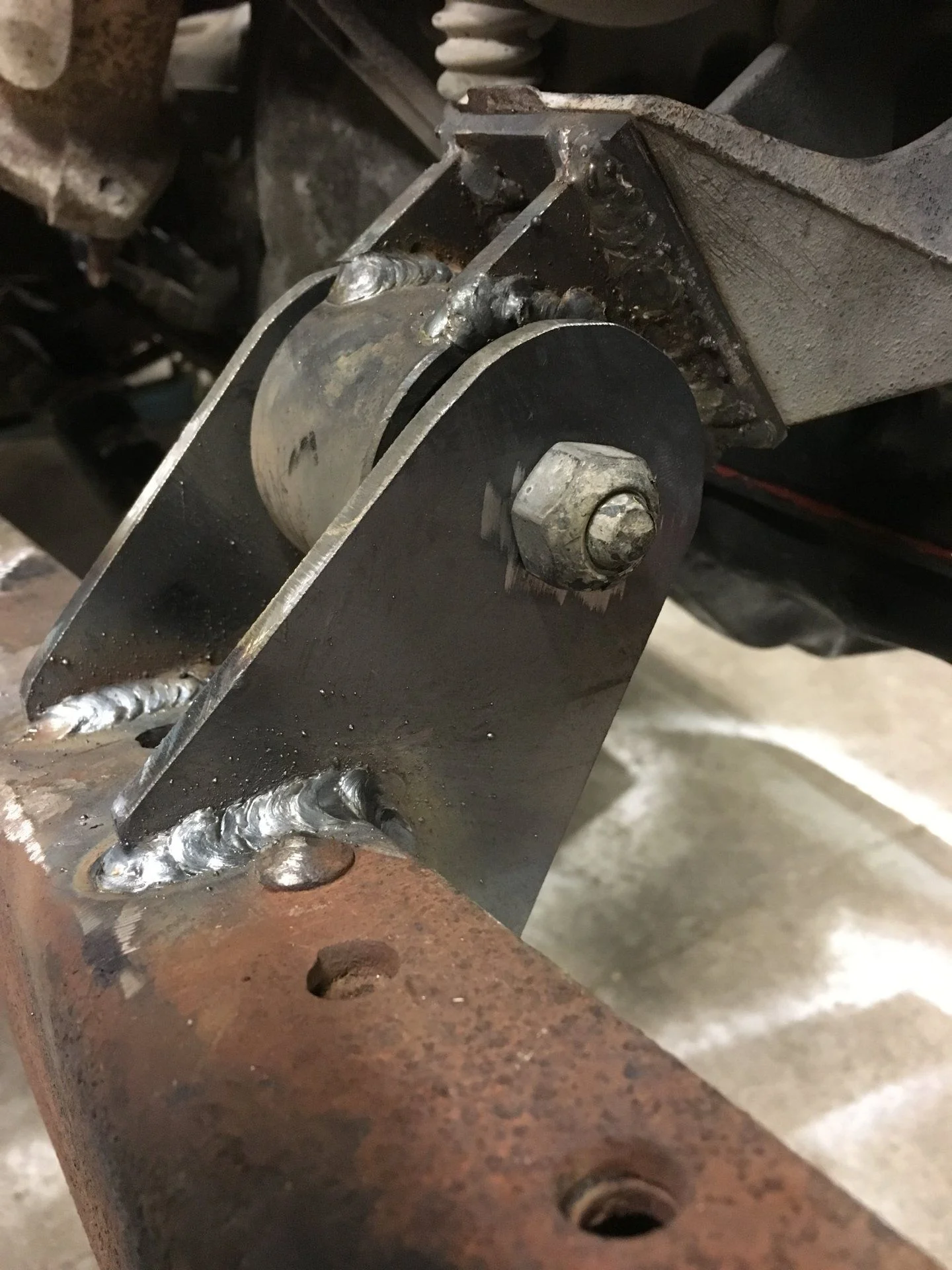

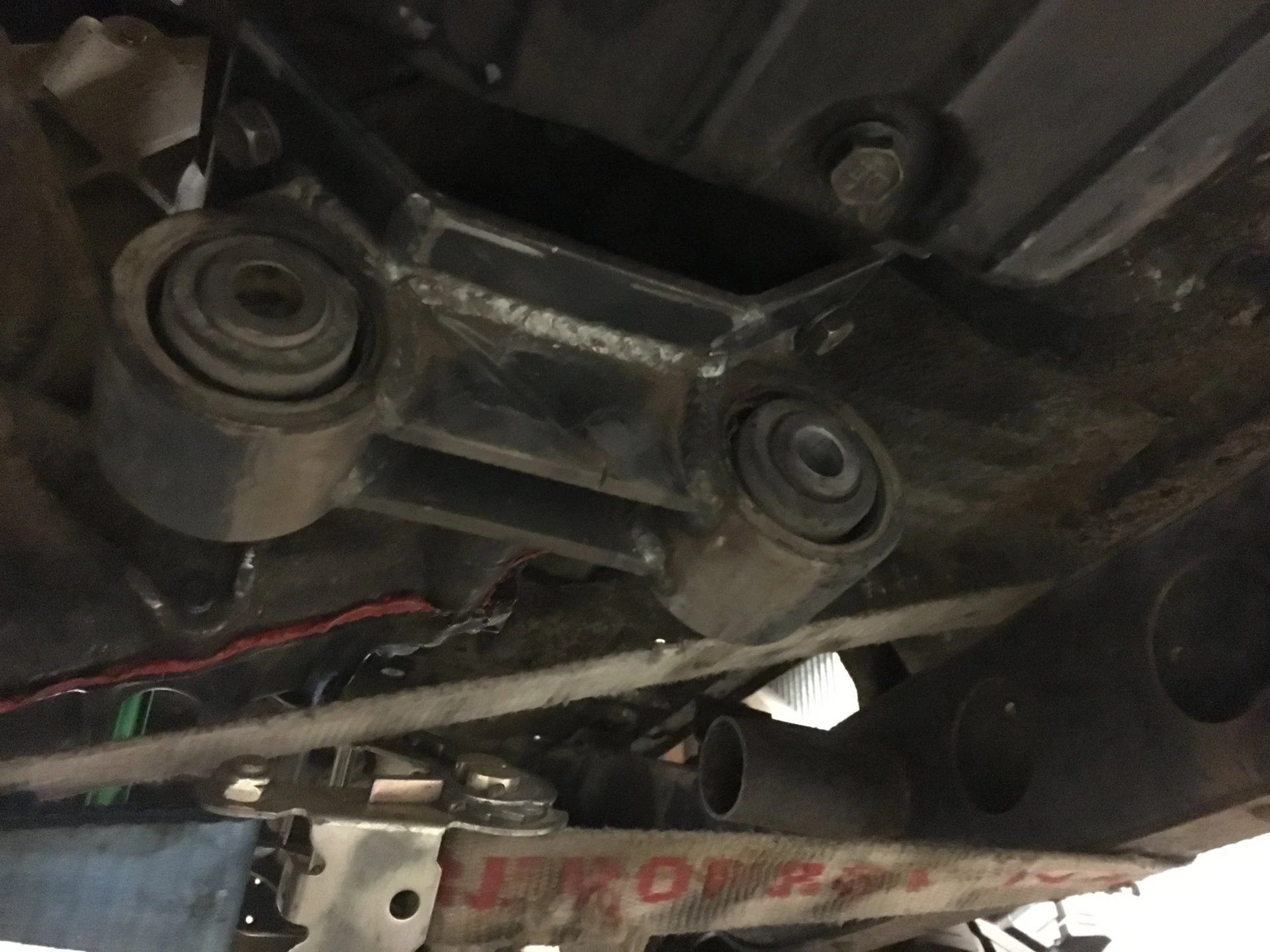

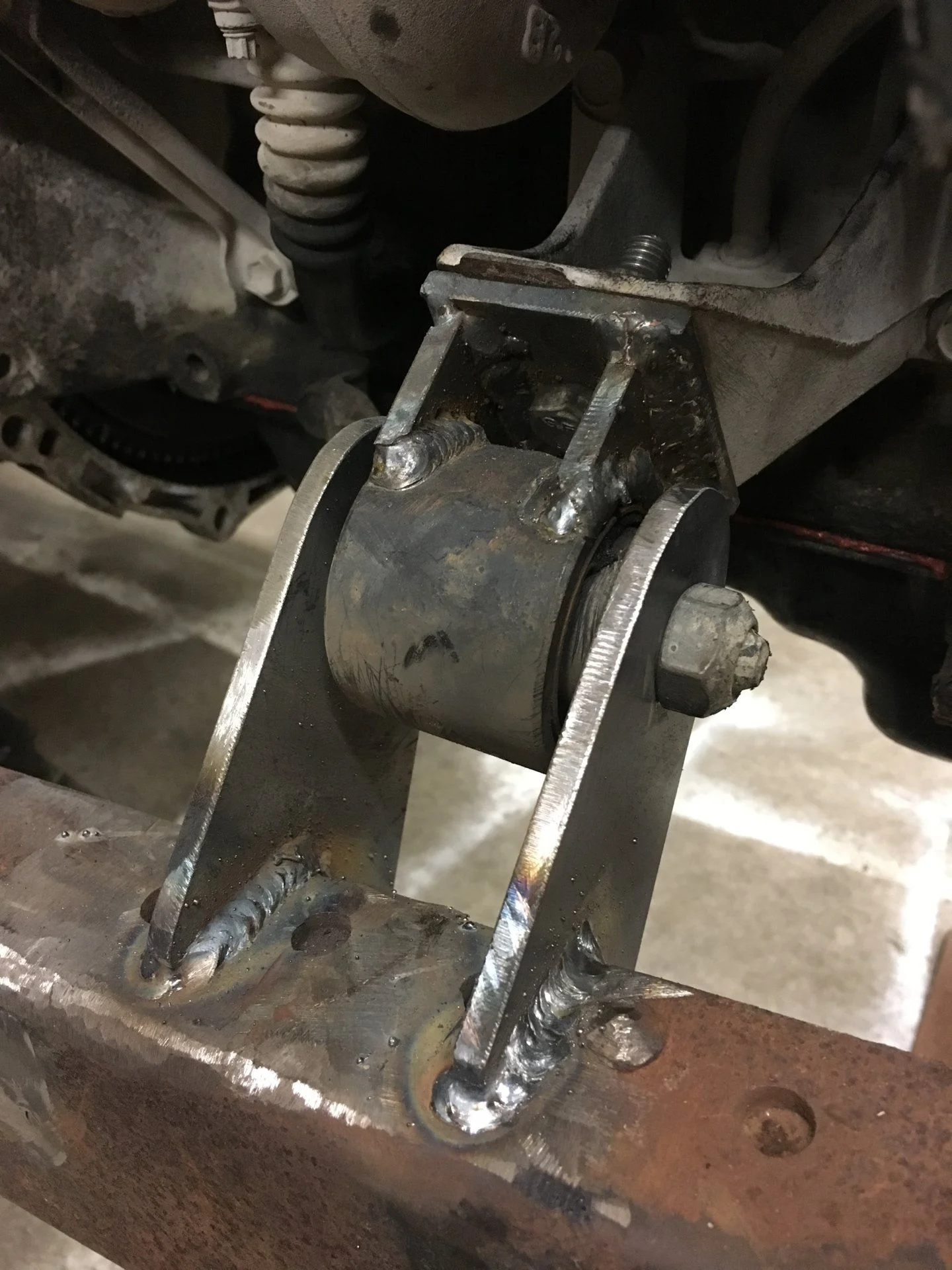

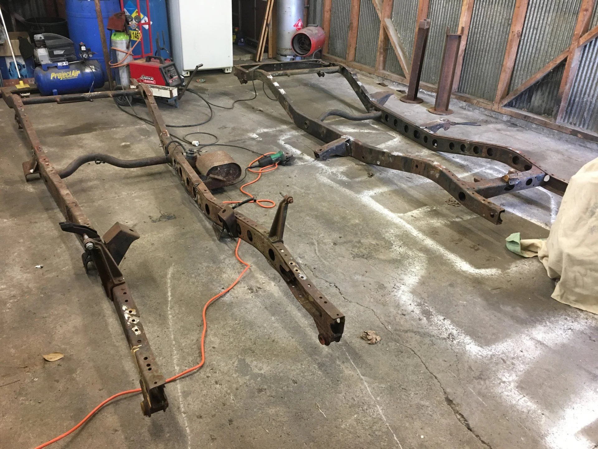

Good choice on the bushings for motor and transmission mounts, they work really well. What did you cut them off of?
Strength is my friend haha I’m happy to sacrifice weight when it comes to important mounts etc. Theyre y60 Nissan patrol rear link ends, I’ll be using them for all suspension links aswell just to keep it the same and simple

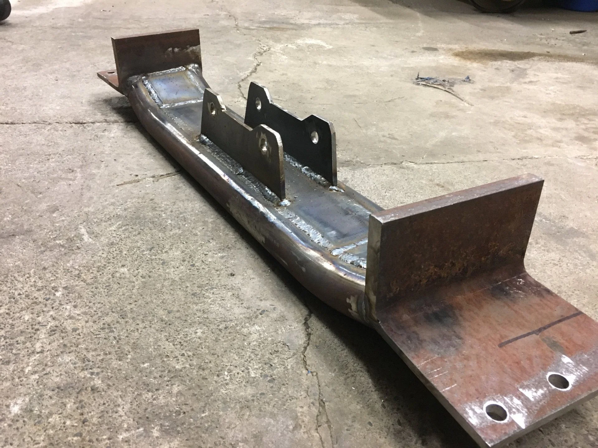

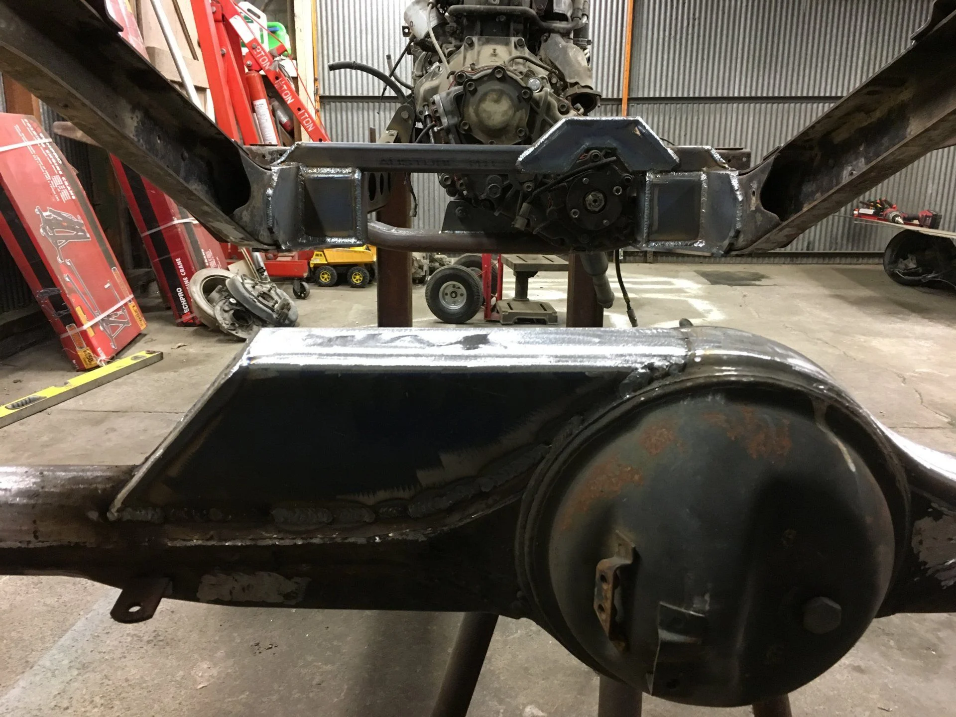

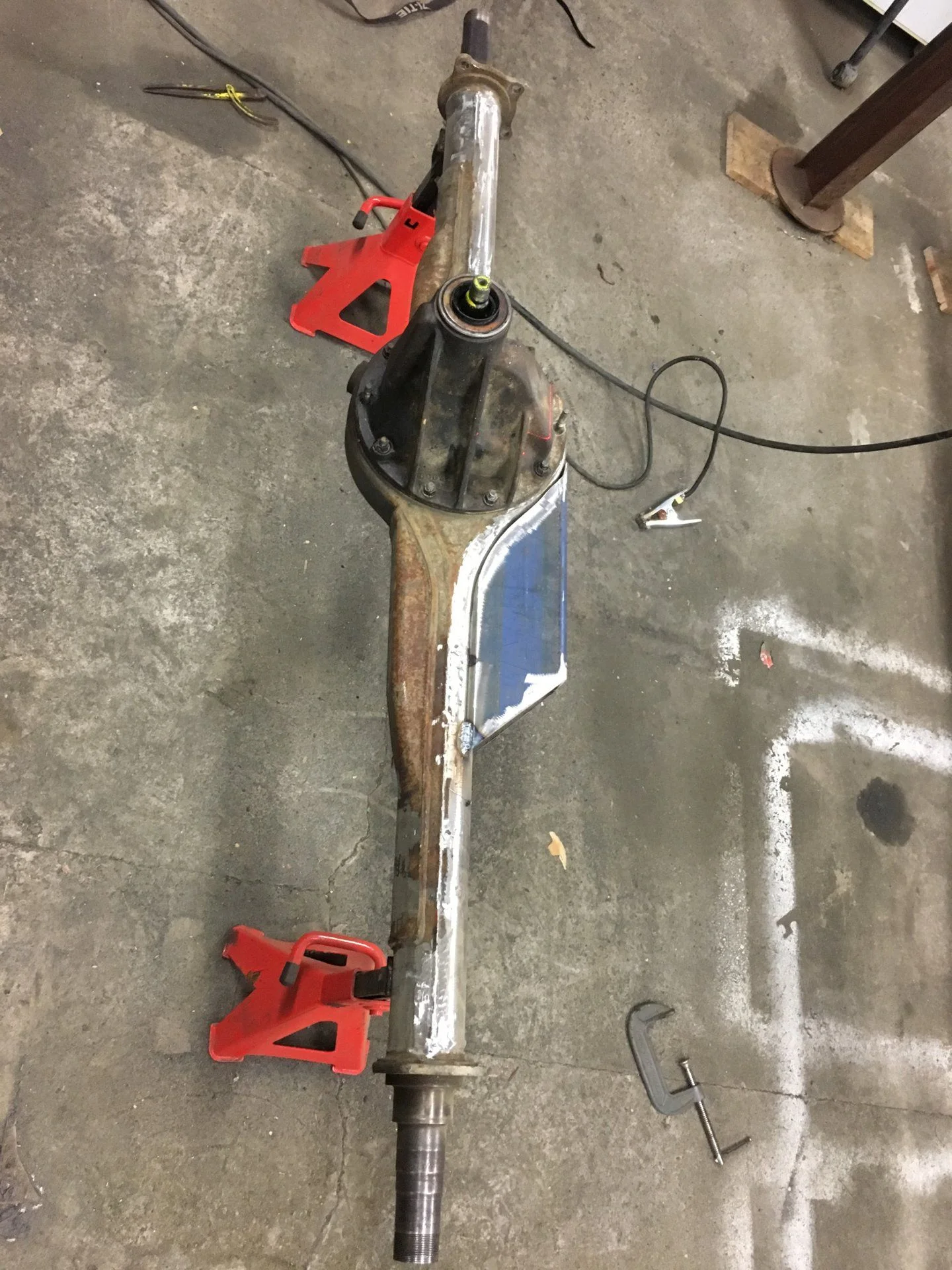

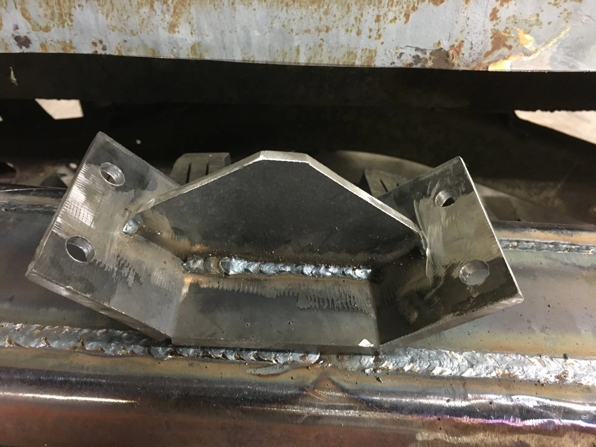

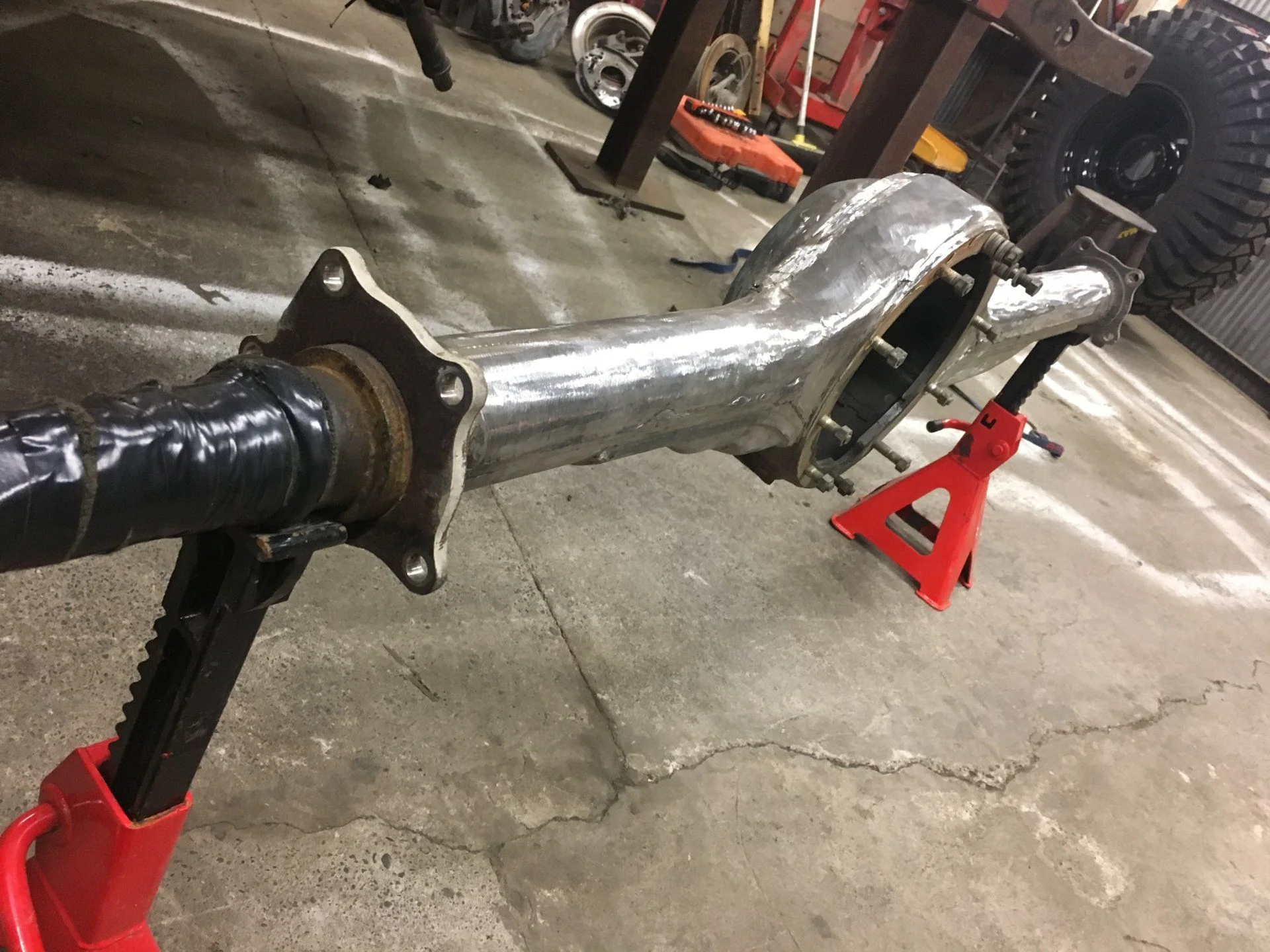

Today I got the 80 series rear housing stripped, all mounts cut off and ground back to shiny stuff 👍 Now it’s time to shave the bottom of the diff and build an axle truss
Stripping the 80 axle is never a fun job.
