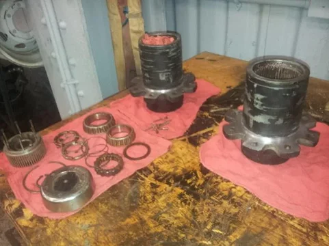

Got a chance to take a tire off during my lunch brake I don't see any abnormal wear although have u ever seen hubs like these
R my for hubs for a Ford got the axle second hand. Its Chevy side diff also they look weird to me.
my last set of hubs on a old Dana 60 I had looked like this
I think that's a dually hub that's had the wheel mounting flange machined off
to make it a srw hub
Or the rotors mounted on the wrong side more likely option 1
And on zooming in on your pic can see the out line of we're the nuts were holding rotor on
And the sharp cut line were it was turned down
Look on pirate there was. A thread on doing it
And I'm shure the poster mentiond he would only
Suggest trail use truck only
The wheel isn't properly supported
After doing some reasearch on dually hubs I think so too so I went ahead and disassembled them. And spun them on a buddy's brake lathe boy were they off
I don't know do I. Ifigured now that the surface is flat it shouldn't have any problems the wheel wobbled side to side not up and down so. Ithink ill be OK. Ill find out tomarrow when I put it all back together and test it I'd put it together right now but I need new hub seals as I messed mine up taking them out

My rims have the v shape for acorn. Nuts I thought that meant they were lug centric the rears don't have any problems. Centering without any kind of ring well I guess ill findout. When I put them on later this afternoon
