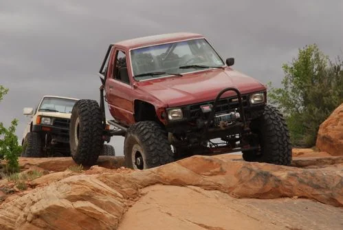

not sure on the springpad width on a cruiser, but on my mini, I cut the longside down 2.5 inches and it lines up perfect. I would keep the axle as wide as I could, mine is perfect at 67 F&R, but even cut down 4-5 inches it will be far more stable than what you had, considering all the added unsprung weight.
