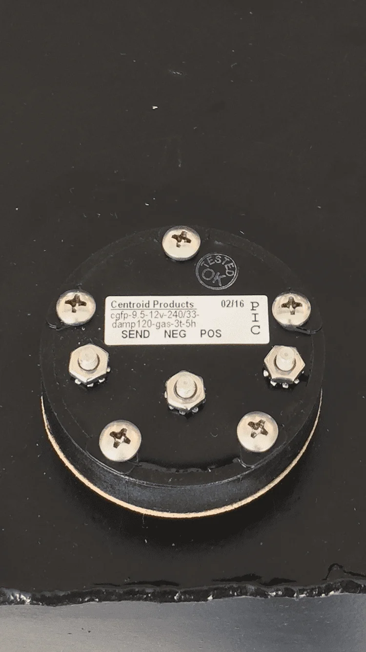

My current setup is VHX Dakota Digital dash system with a non/mechanical Centroid Fuel sender 240/33ohms. I am using a Conferr style tank as my main and only fuel supply.
The Dakota Dash allows me to select up to 8 different fuel senders. I currently have it set to the SW33 which should match the Centroid Fuel sender at 240ohms empty and 33ohms full.
No matter what I do I cannot to get the Centroid Fuel sender to communicate correctly to the Dakota Digital. I spoke with Joel at Centroid support many of times through emails. After numerous tests, troubleshooting and calibrations he doesn't have a good answer to why it's not working.

When I bought my Centroid gauge, I told them I had a VDO gauge but was thinking of going to a Dakota dash. They said to get the 3 terminal (separate 12v terminal) or it wouldn't work with the Dakota.

That's what I am running. The 3 terminal Centroid sender 240ohms/33ohm.
