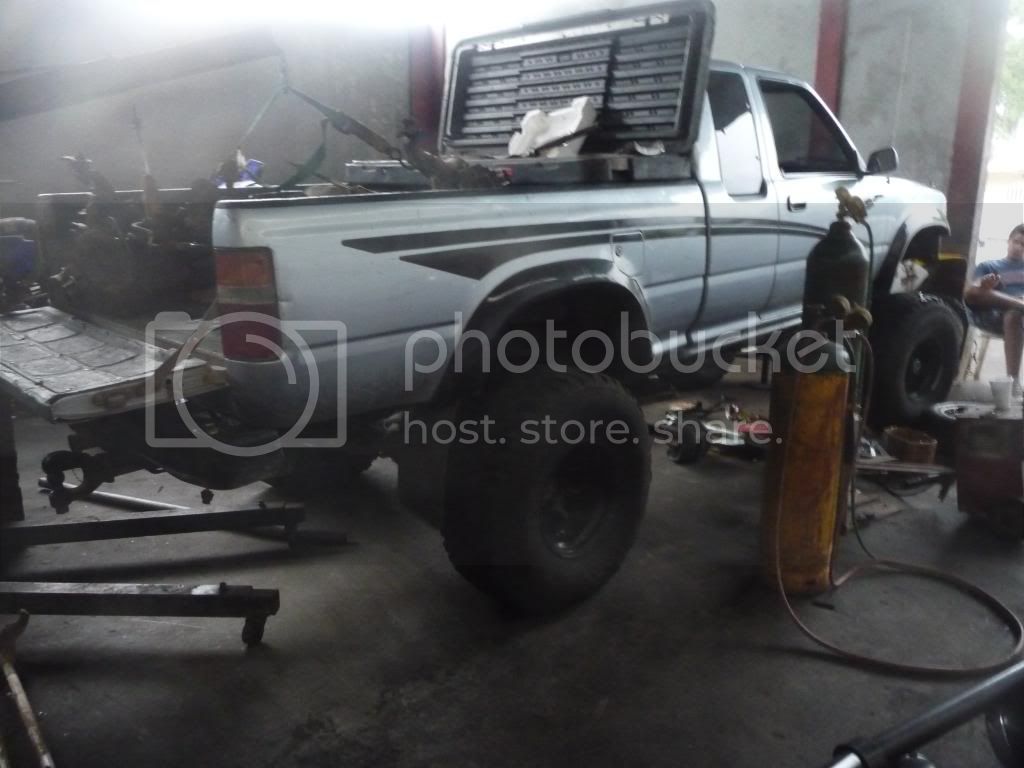

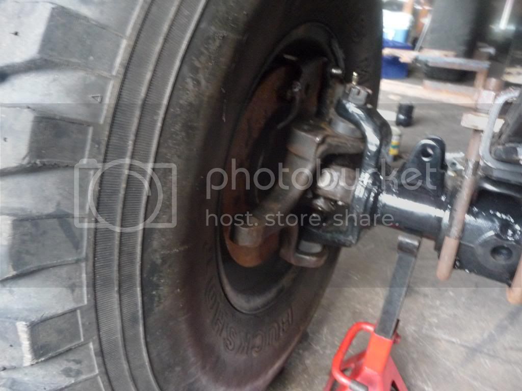

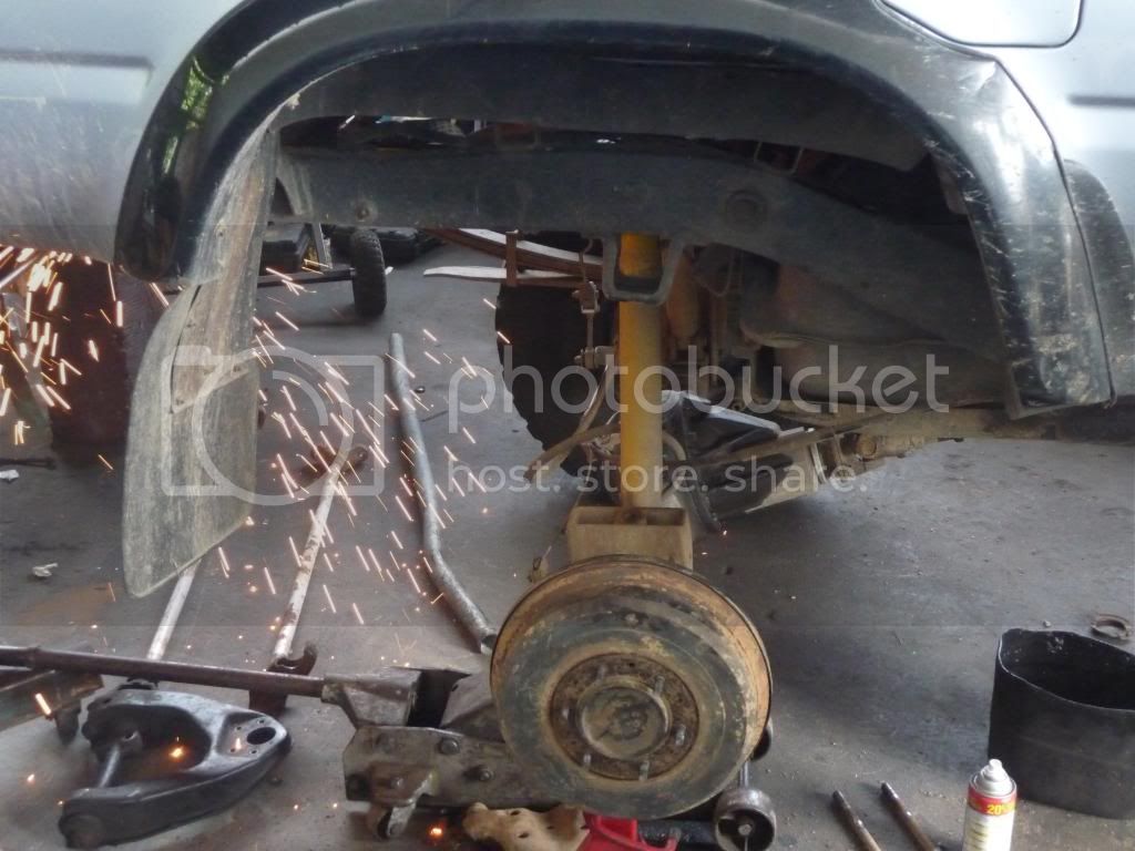

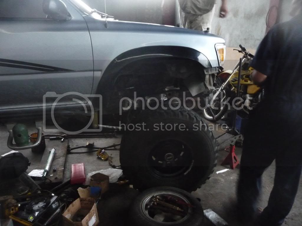

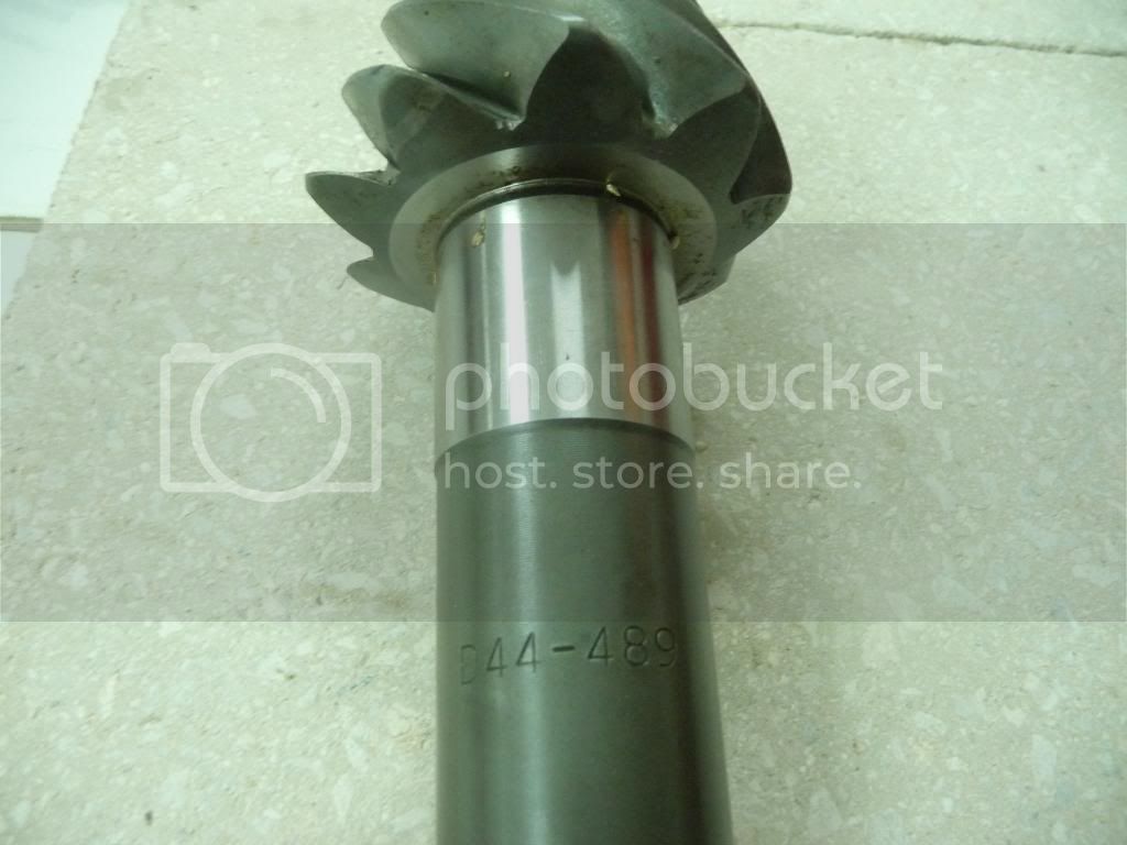

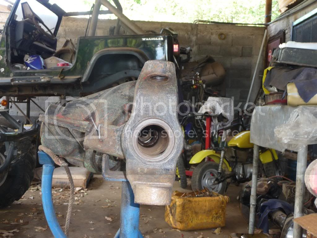

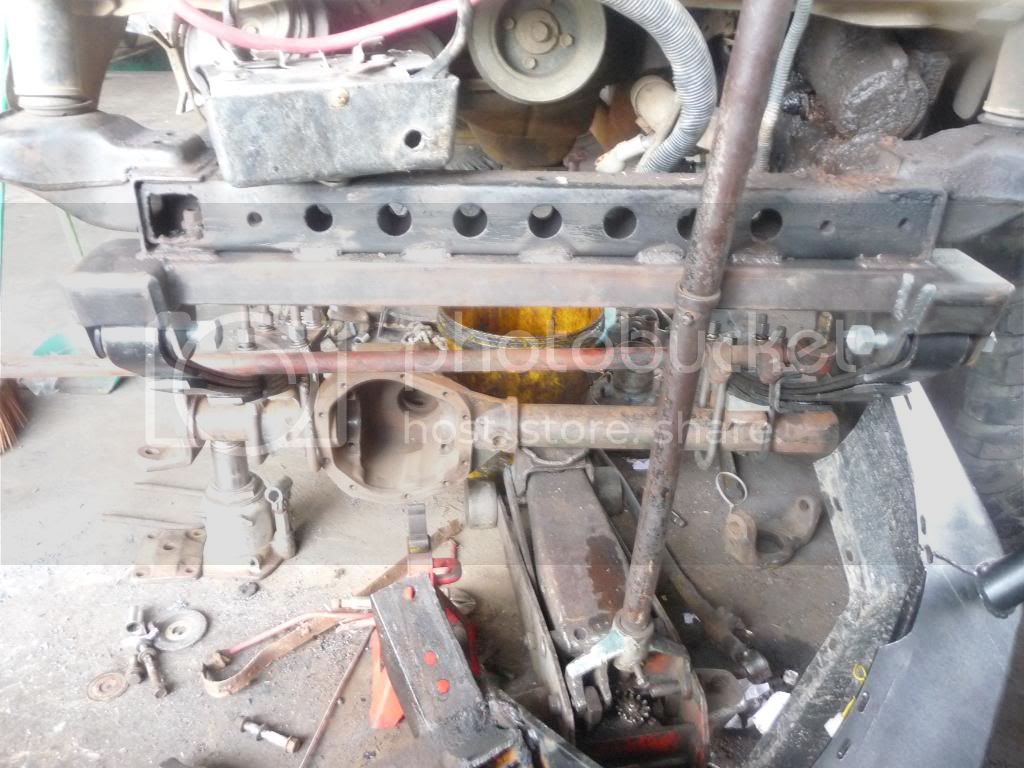

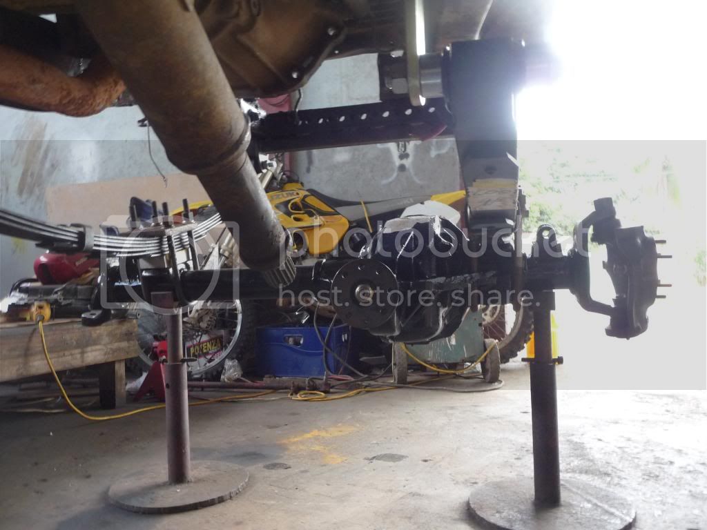

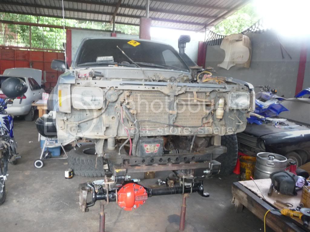

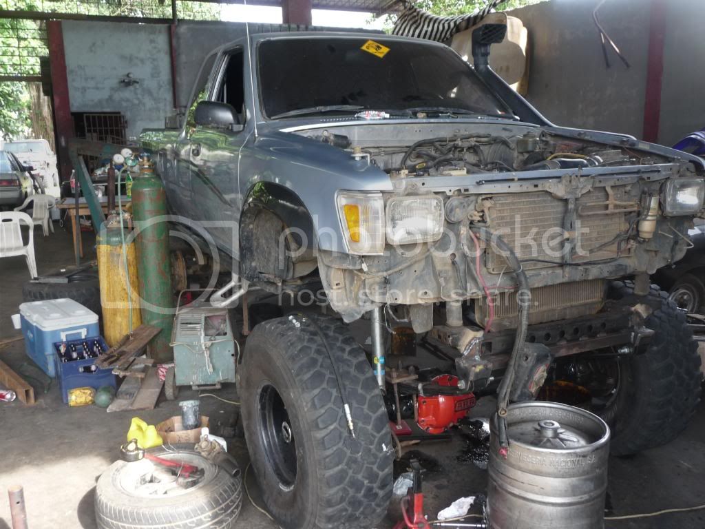

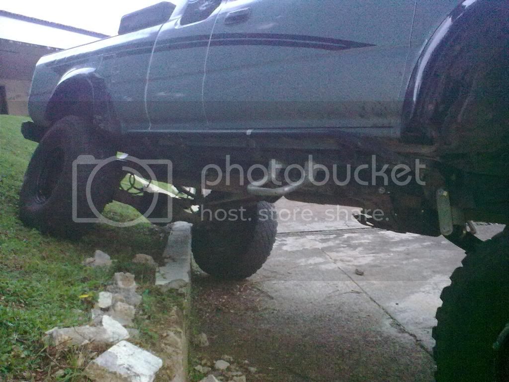

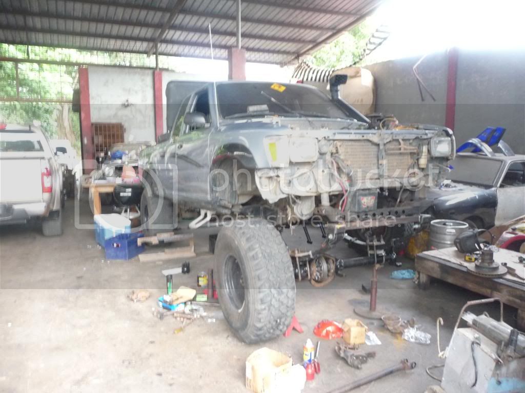

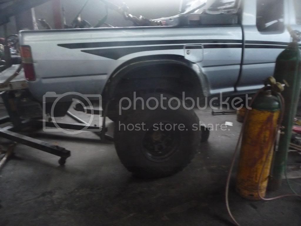

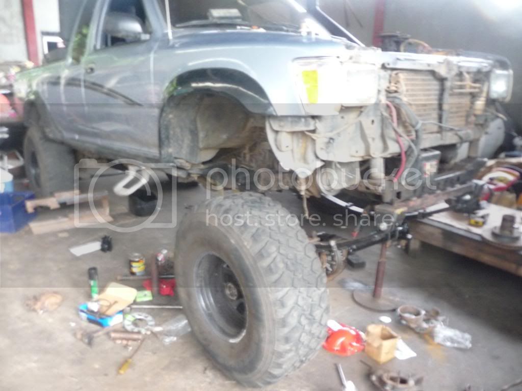

I started with the SAS here are some pics...

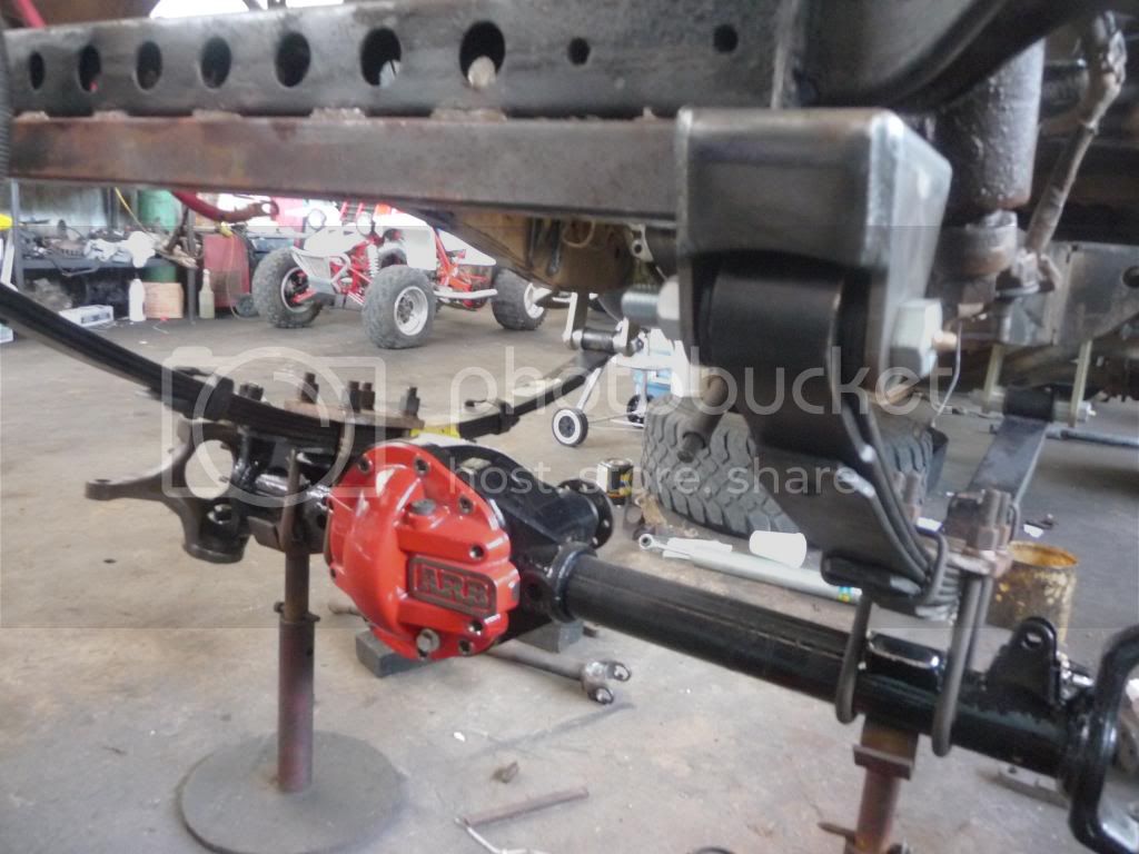

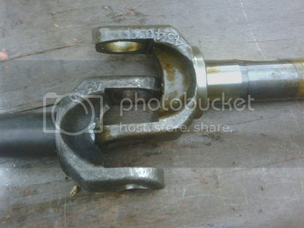

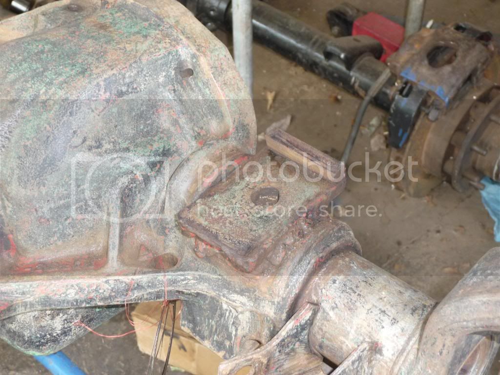

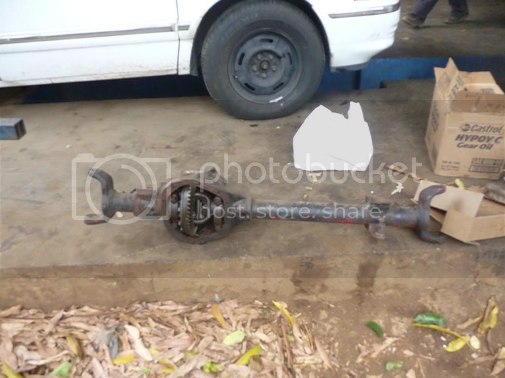

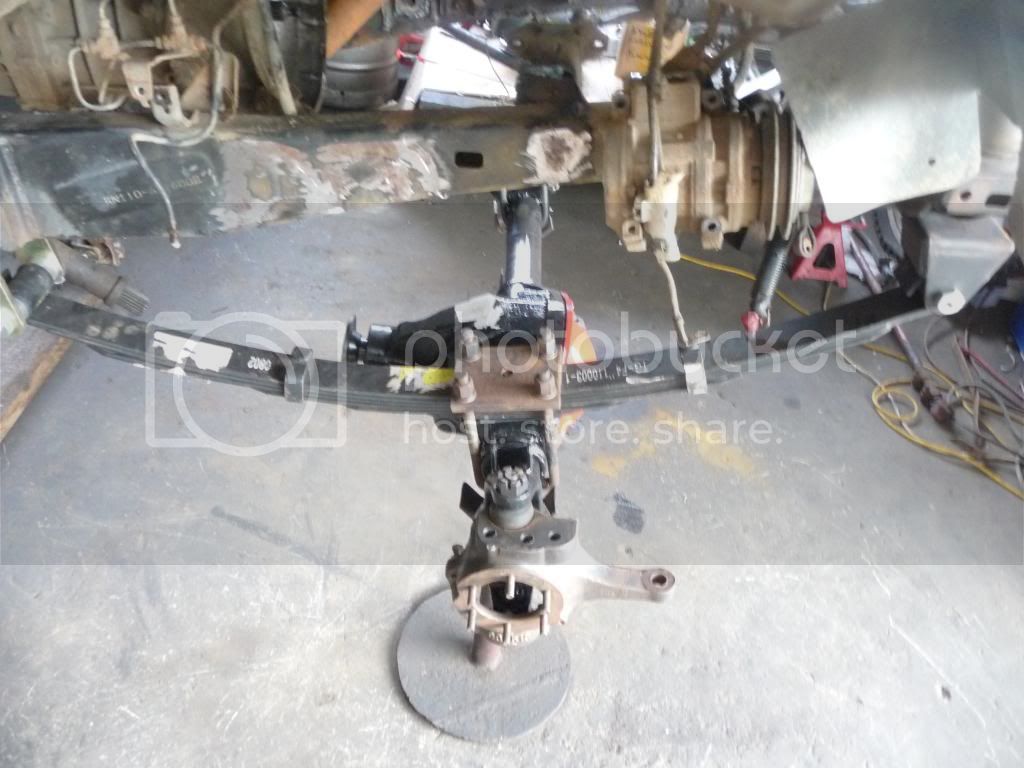

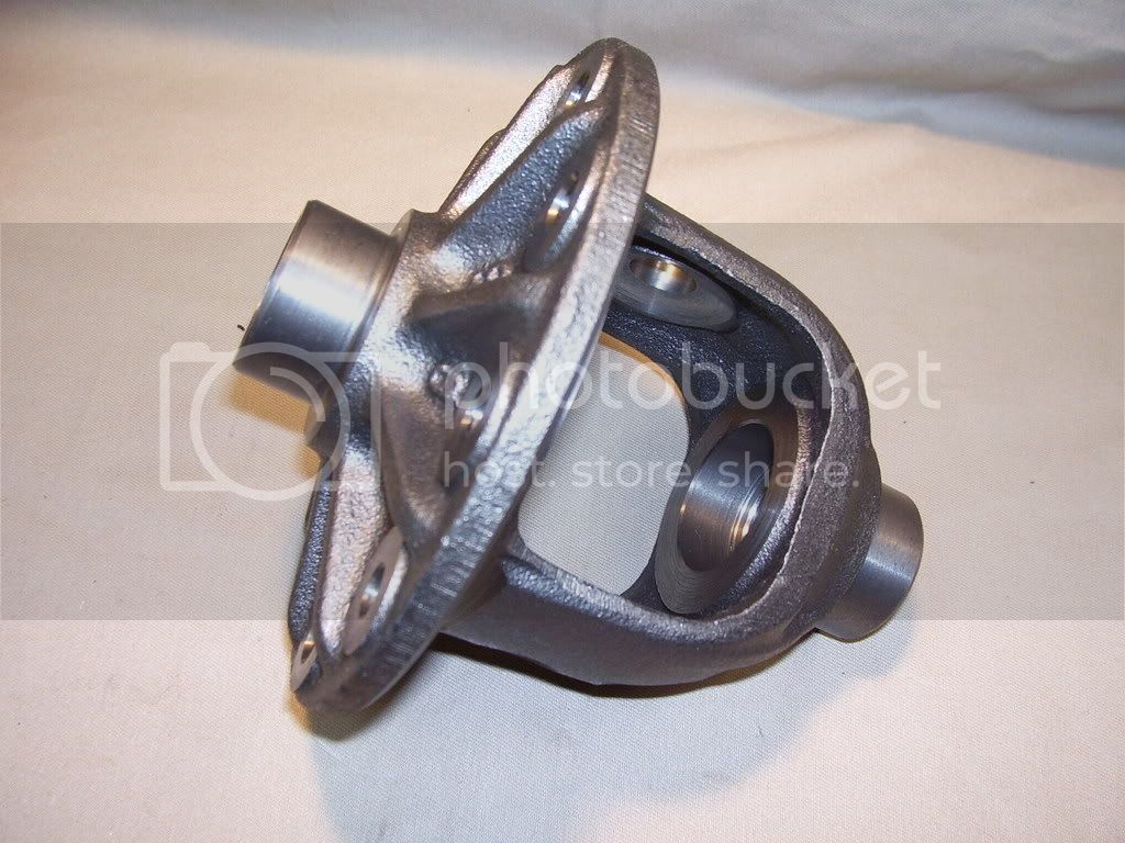

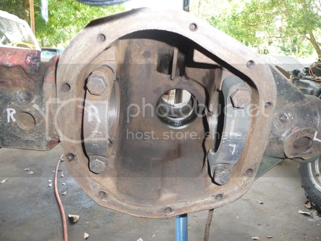

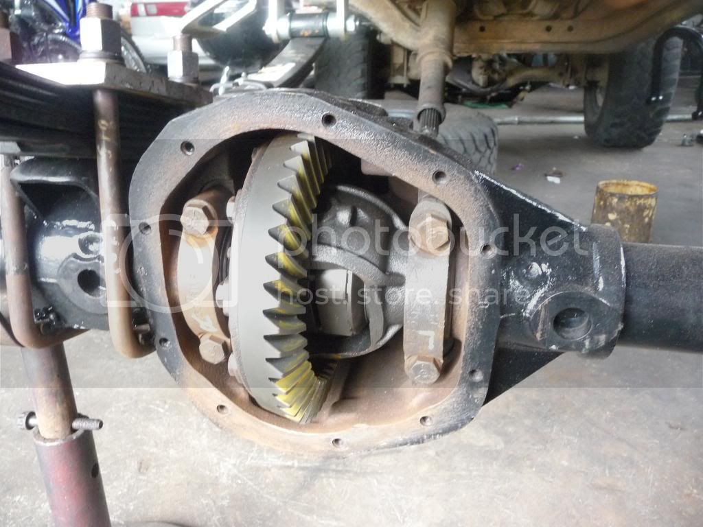

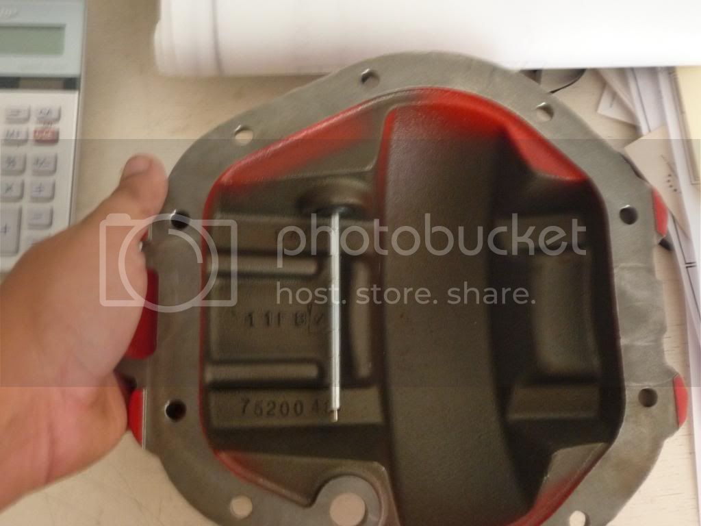

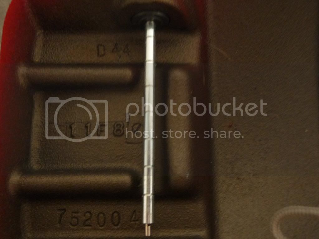

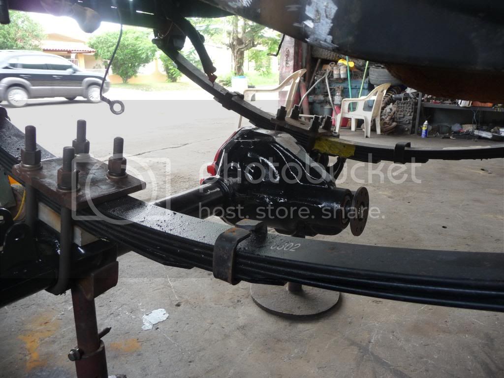

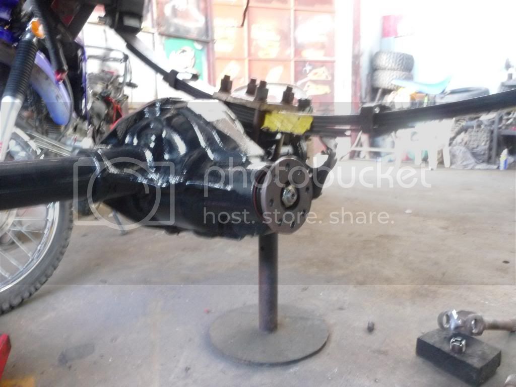

DANA 44 from a wagoneer

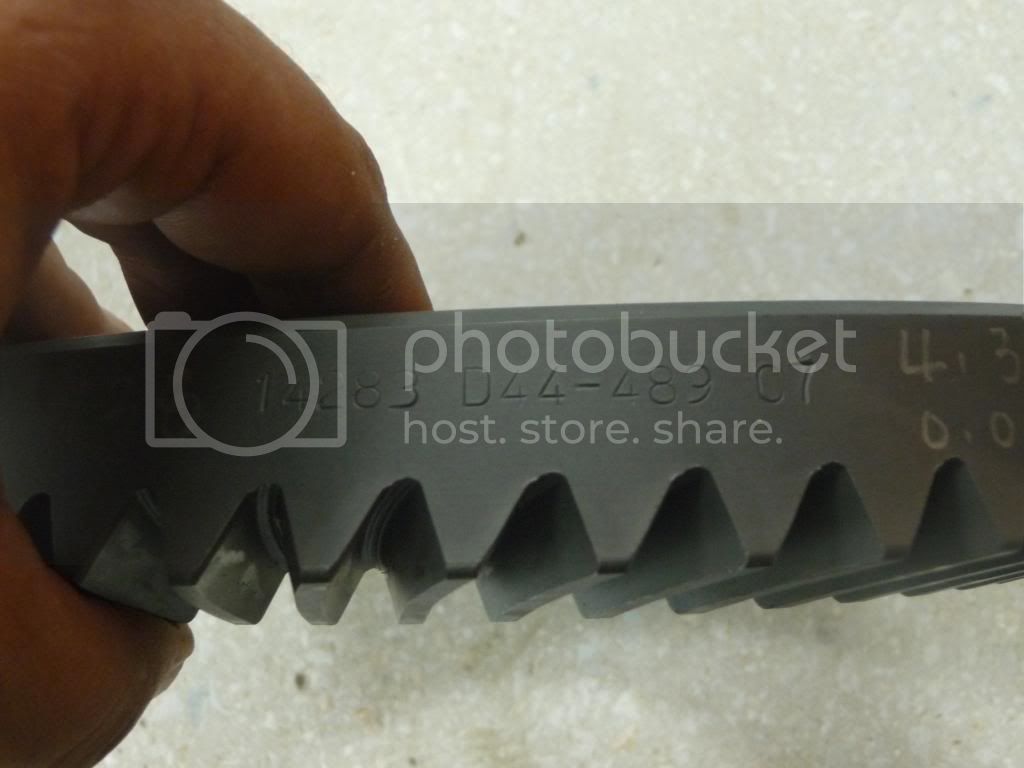

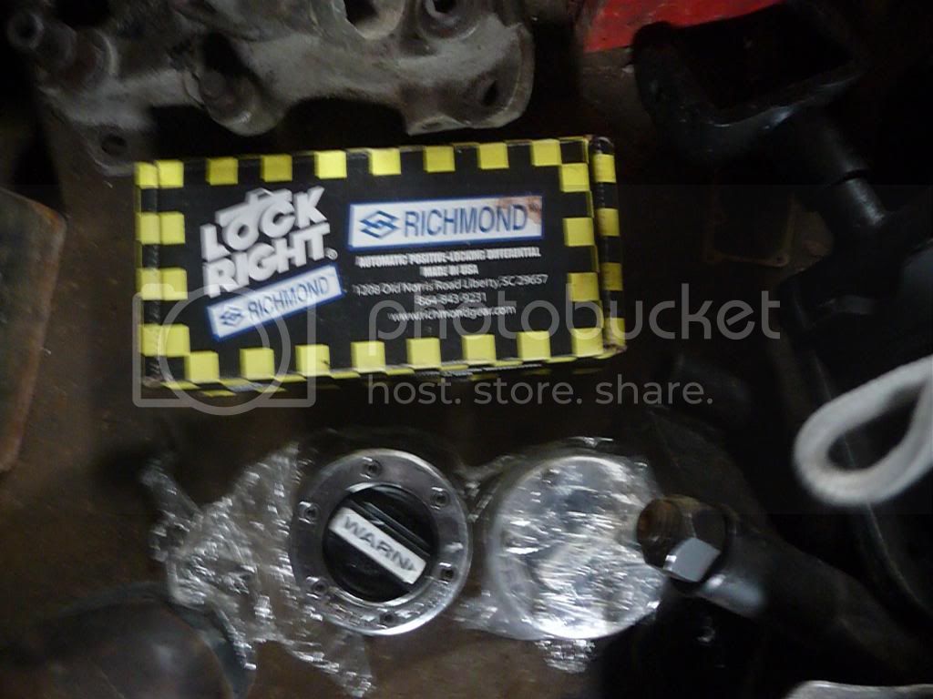

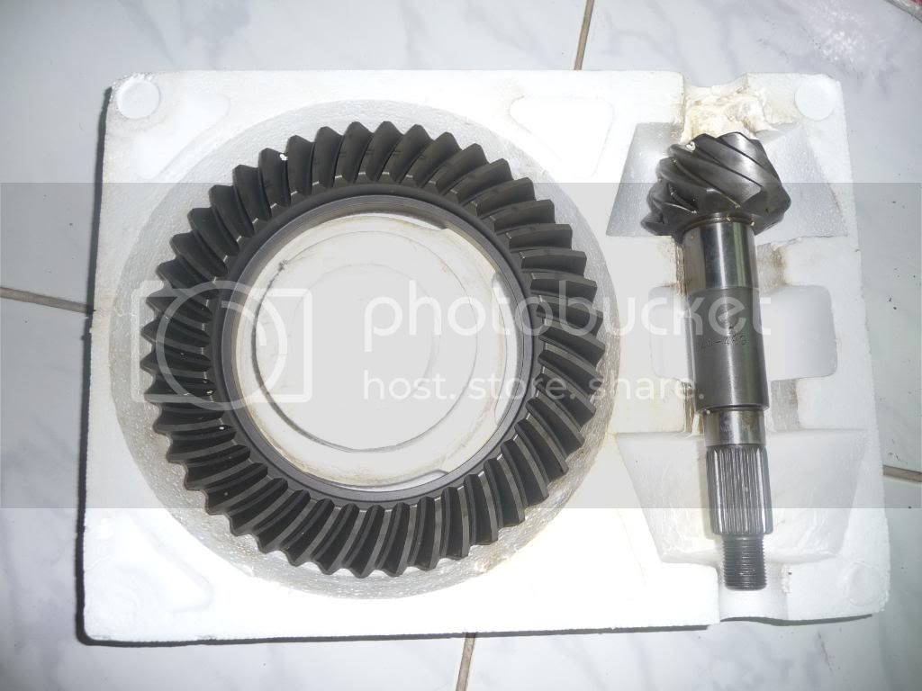

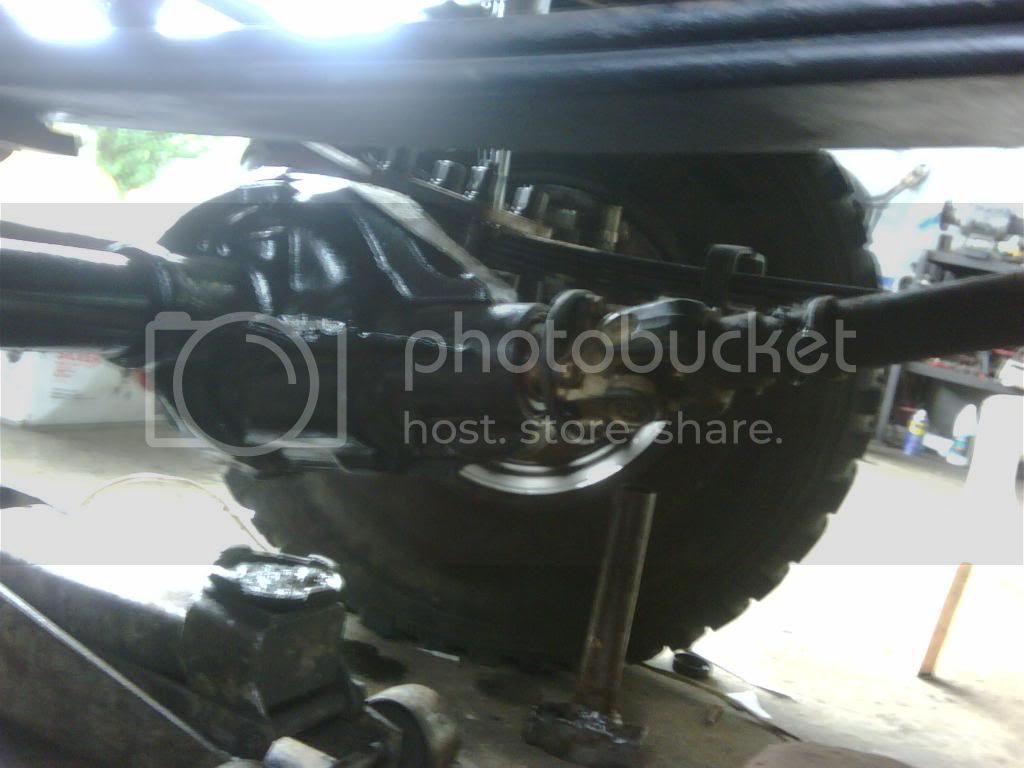

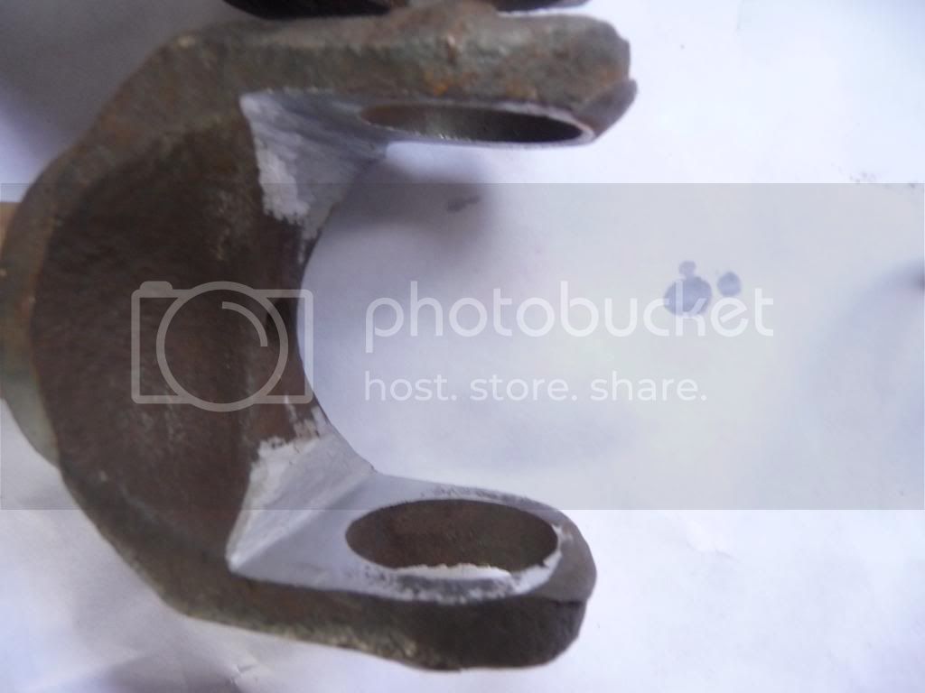

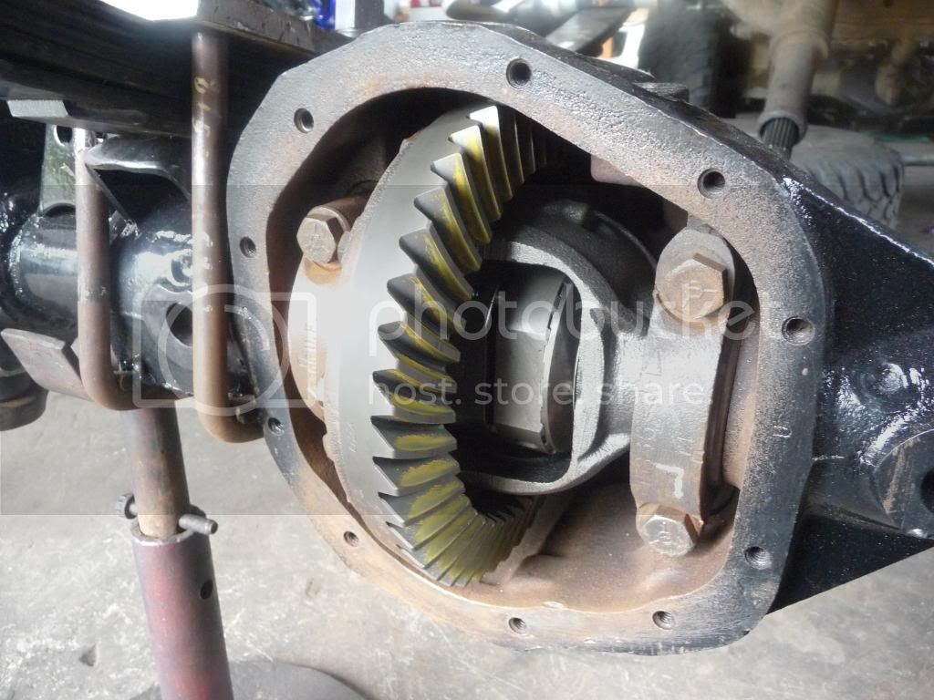

A new carrier for the 4.88:1, it was 3.73:1
4.88 Standard Rotation

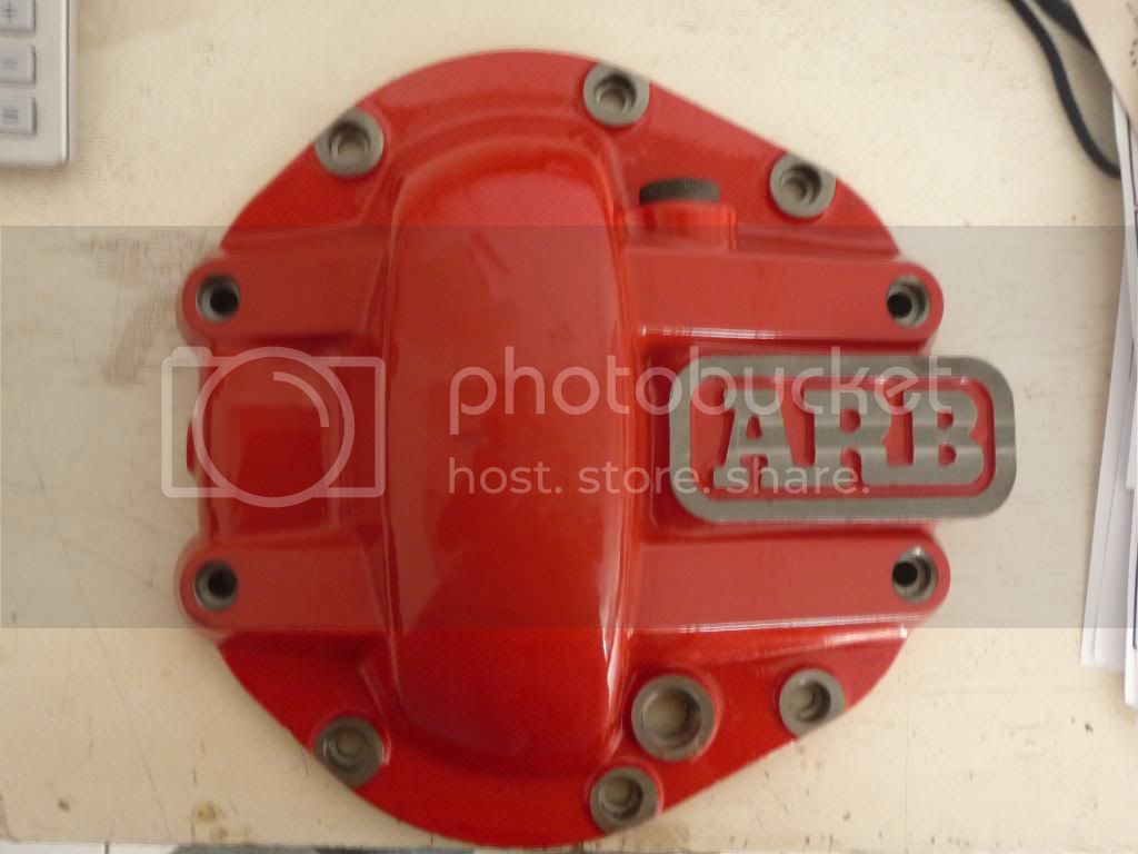

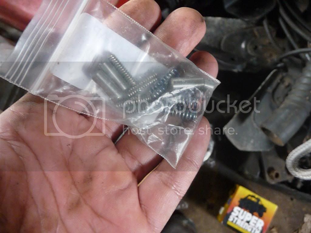

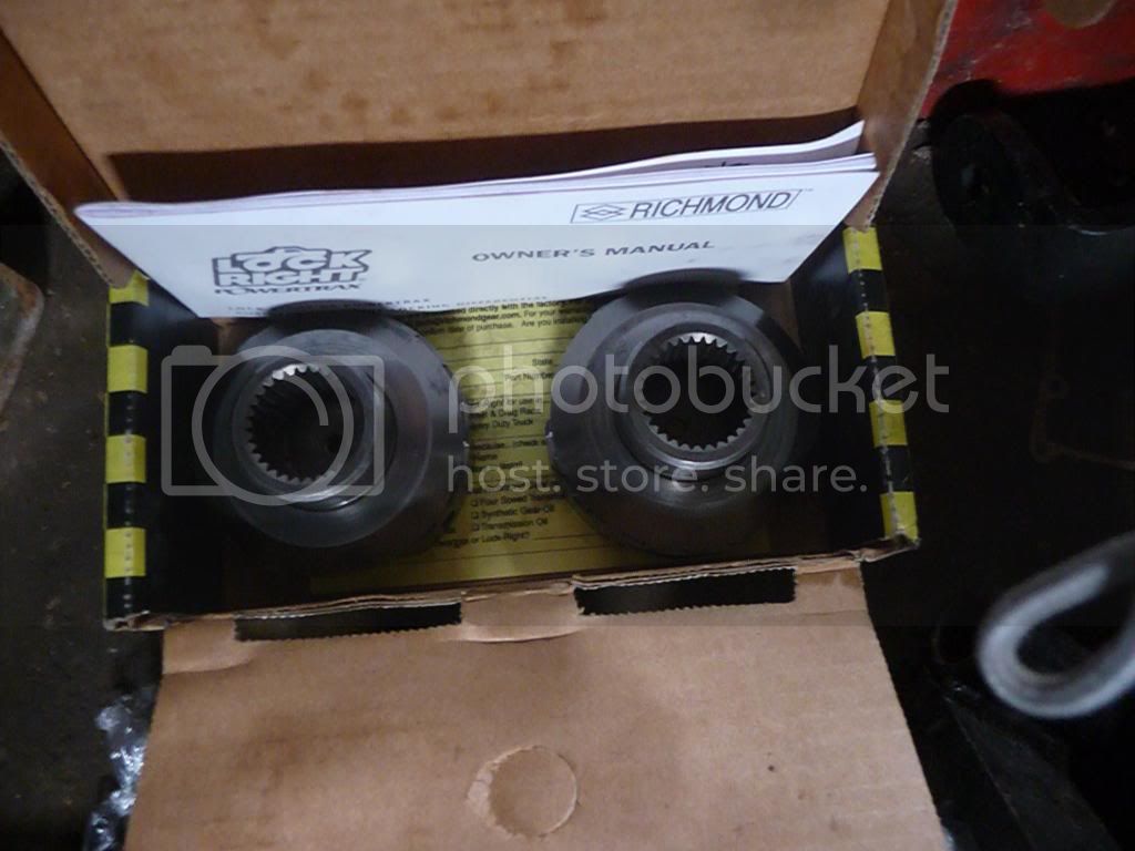

Locker

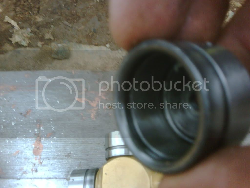

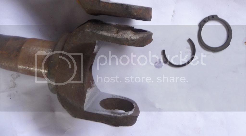

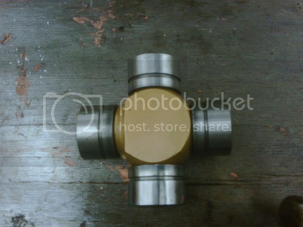

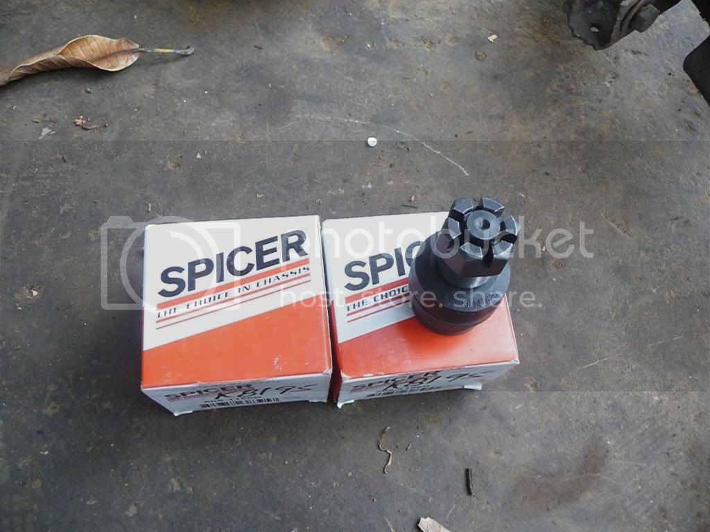

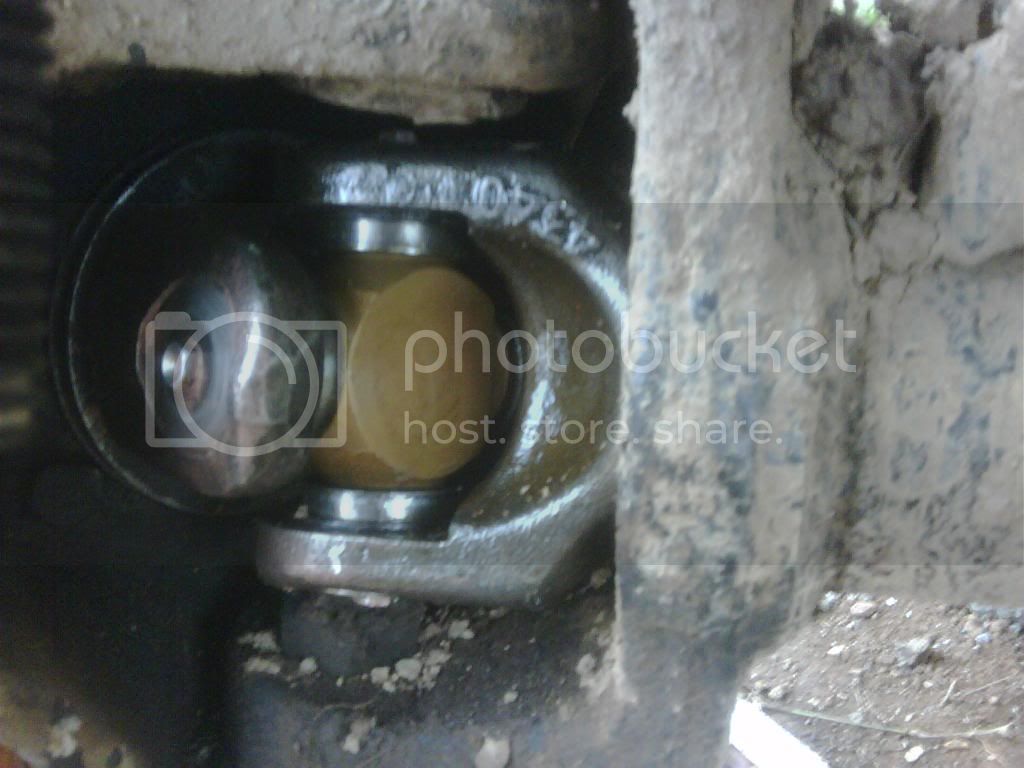

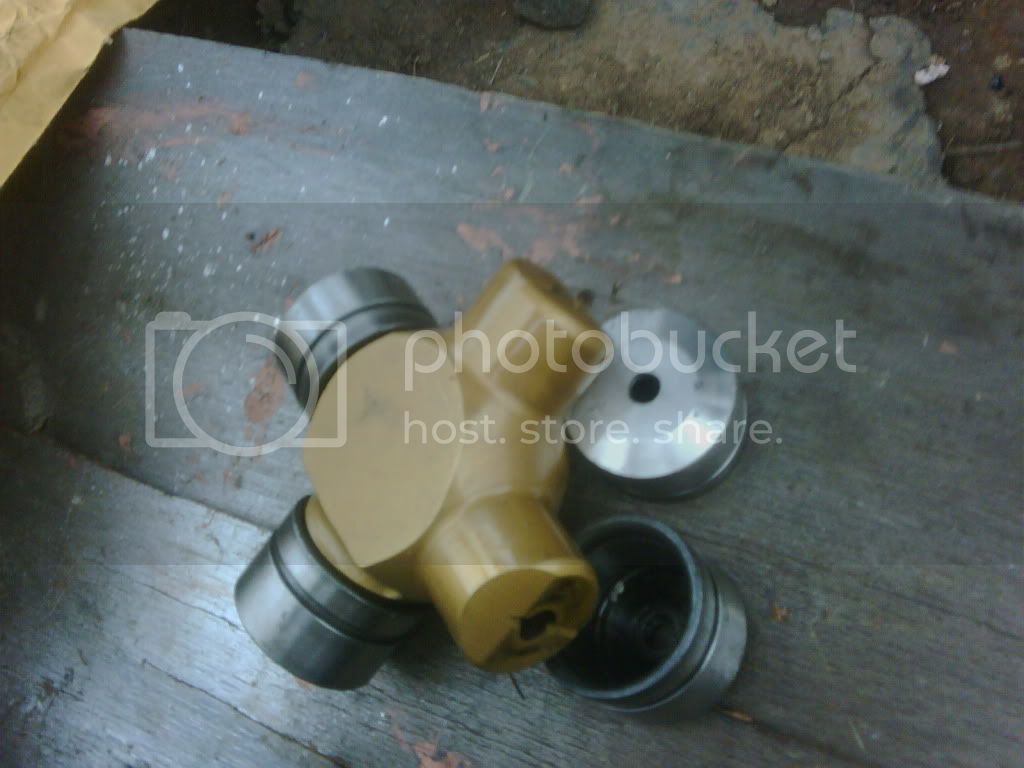

Federal Mogul U joints

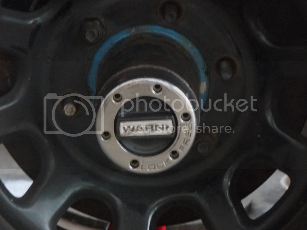

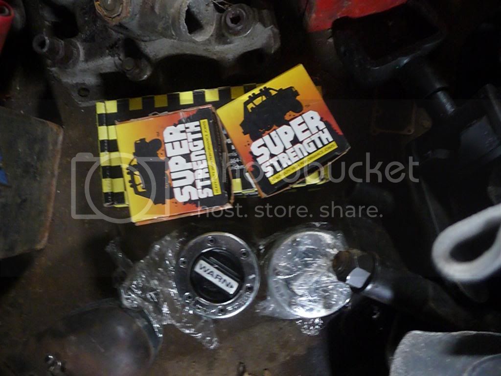

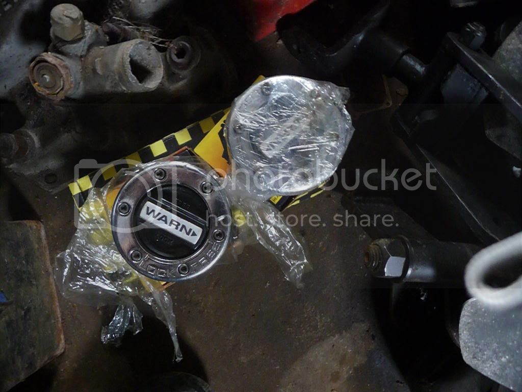

Warn Hubs

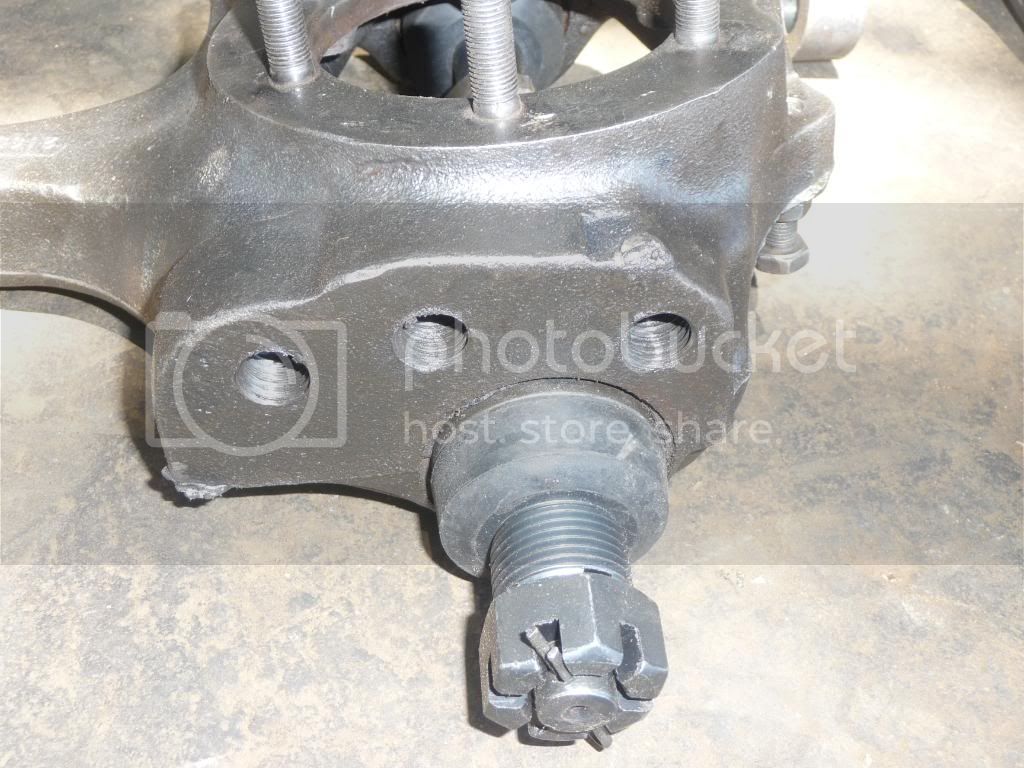

Ball Joints

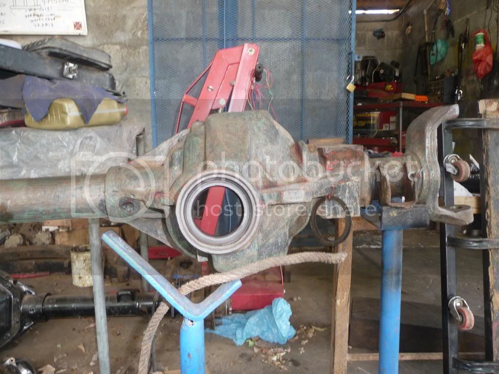

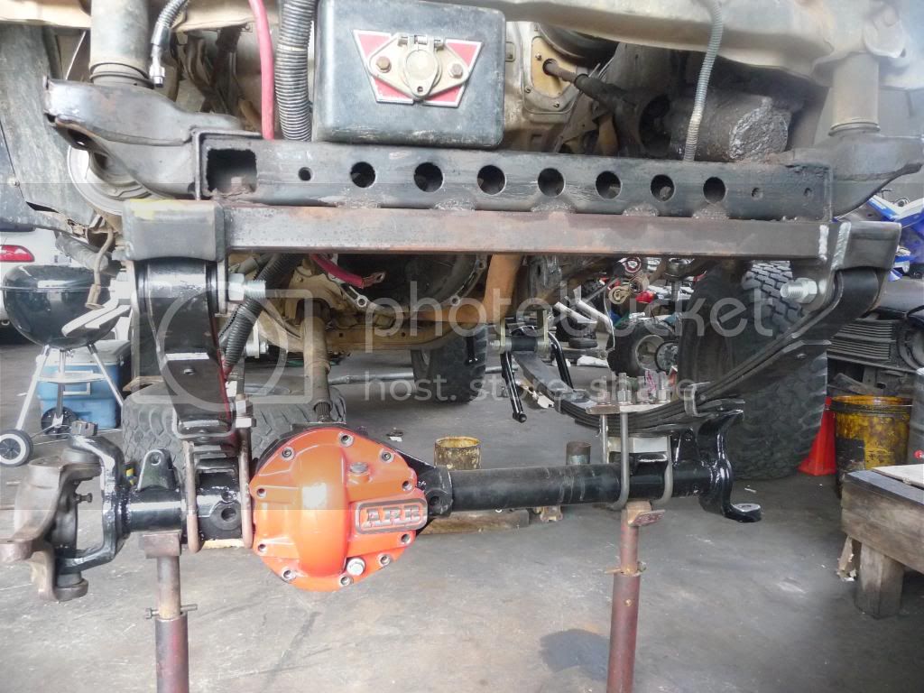

We're begining with the rebuilt of the whole diff
Ive seen warm hubs blow in spots that most vehicles do in 2wd. But its hit and miss with them, they are much stronger then factory gm/ford/chrysler hubs.
Im not sure on the second question. Im goign to think so, but someone elses opinion would probably be alittle more accurate.

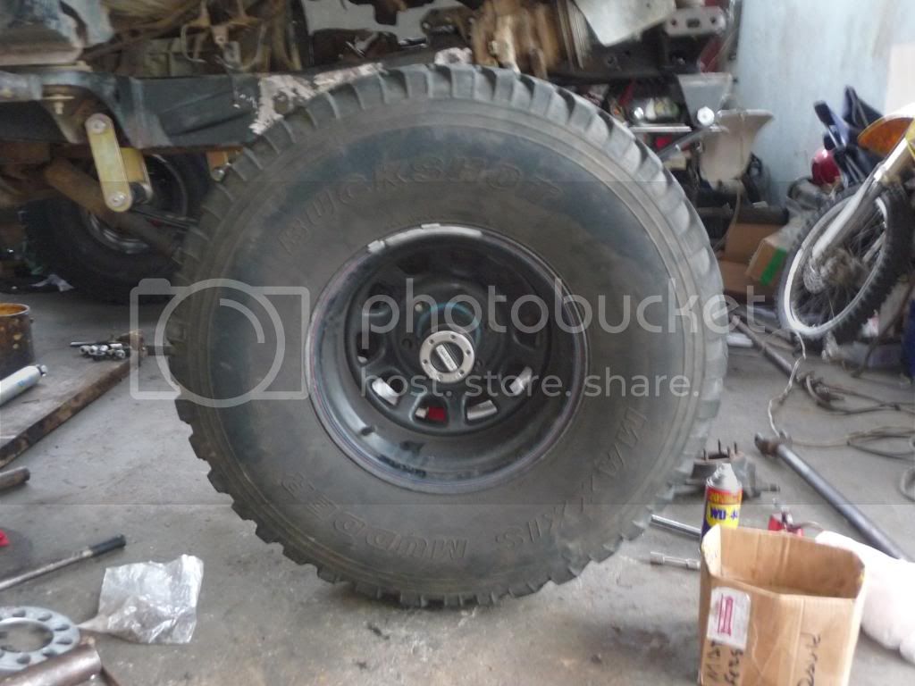

I think that i'll need spacers for my toyota 8" rear axle cause the wagoneer D44 is :
62.5-Inches Wheel Mount Surface to Wheel Mount Surface.
Do you know the real width of the rear toy 8"
Or which spacers i'll need??
From Pirates mini FAQ
Toyota Rear Axle Widths:
55" wide, '79-85 4wd trucks/4runners - 6 Lug
58" wide, '86-95 4wd trucks/4runners - 6 Lug
56" wide, '79-95 2wd Trucks - 5 Lug
60.75" wide, '95.5-up Tacomas/4runners
66.75" wide, '93-98 T100 trucks
Keep the pics coming :cheers:
Aren't good enough those warn hubs??
I have another question, do you guys think that my stock brake master cylinder will have enough presure to work with those wagoneer calipers??
Warns aren't all that great. They are definitely better than stock but I would keep at least one extra set with ya, but thats just me...
When it comes to Warn vs Toyota Aisin, its Aisin all the way

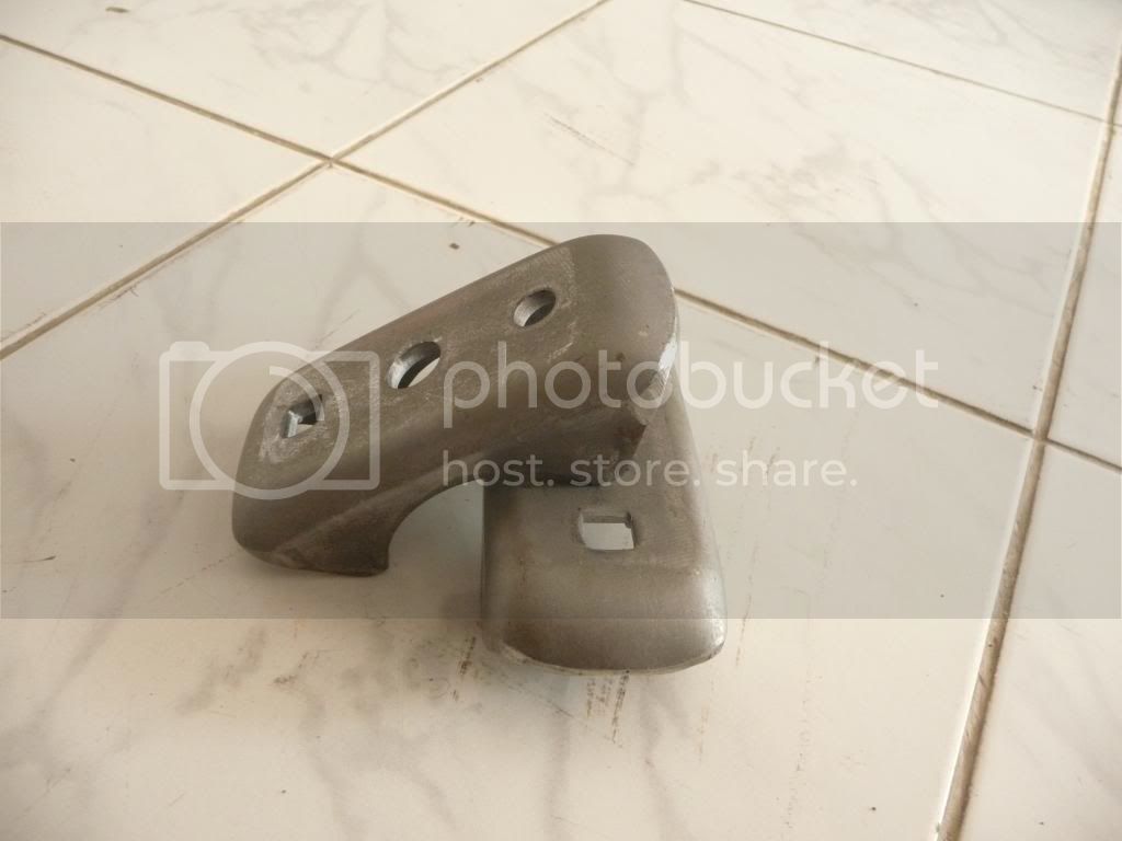

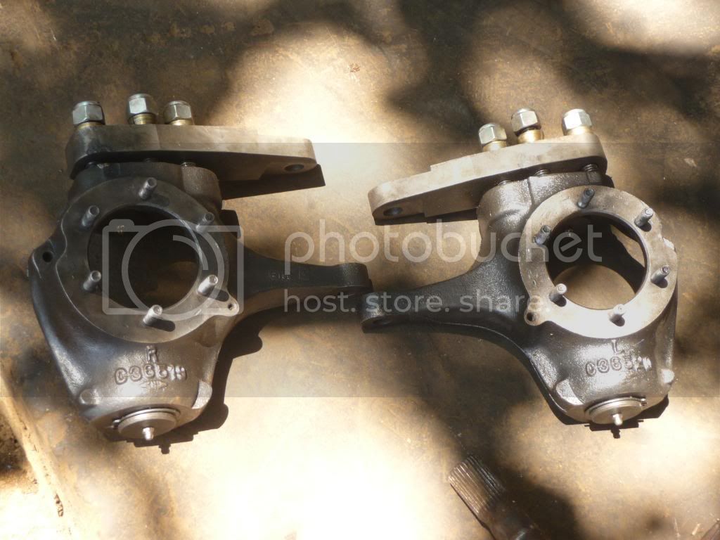

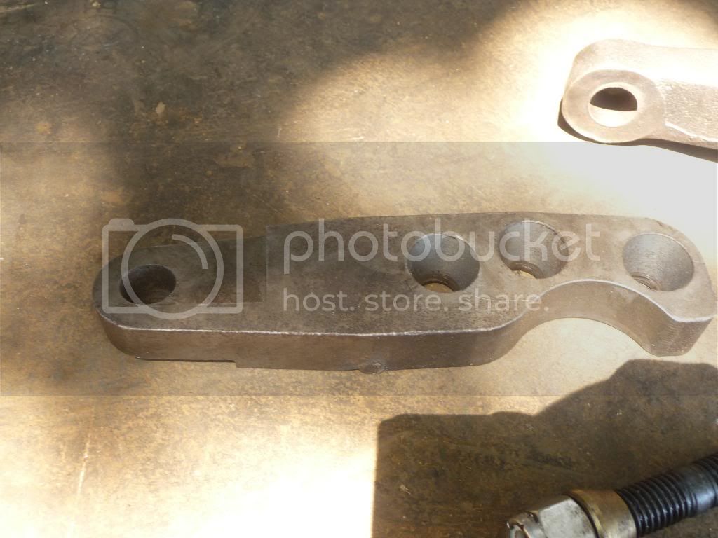

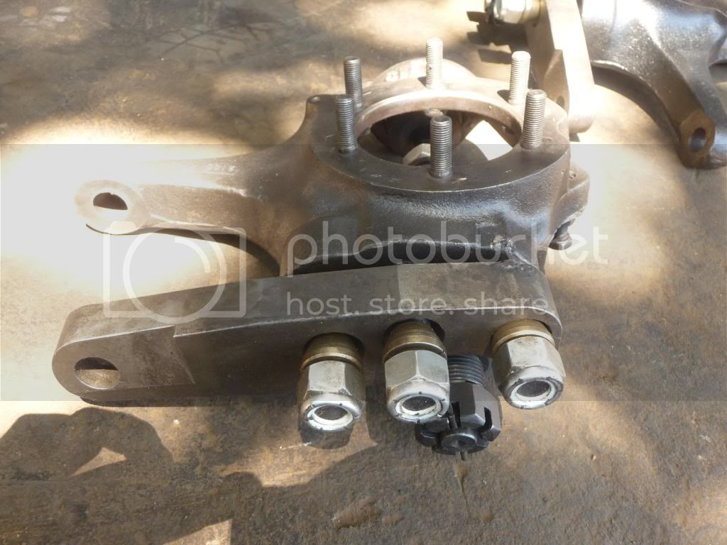

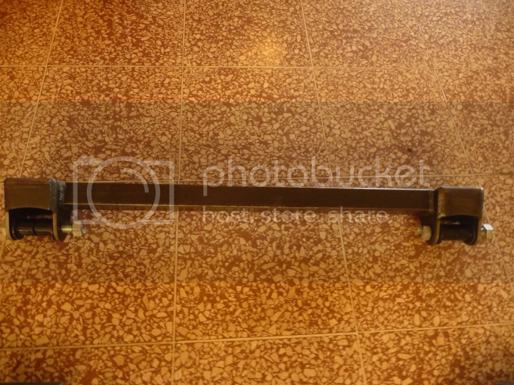

High steer arms

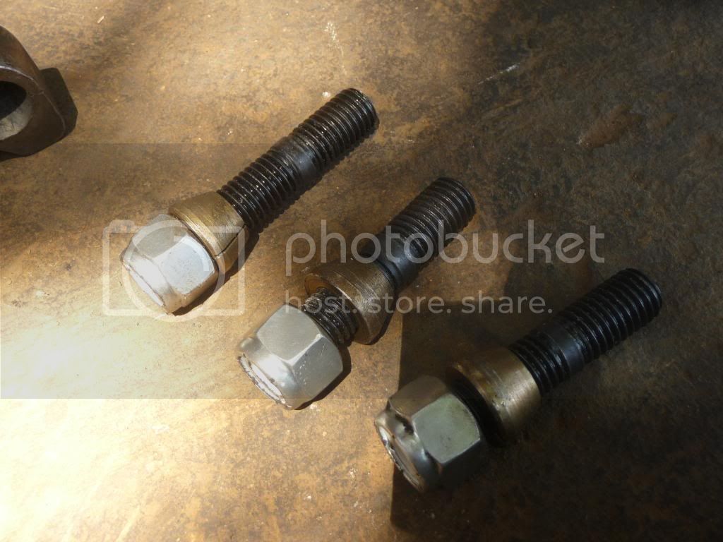

Hardware

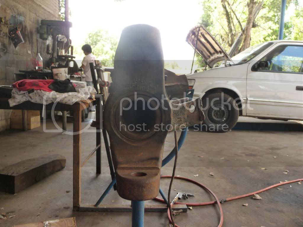

knuckles

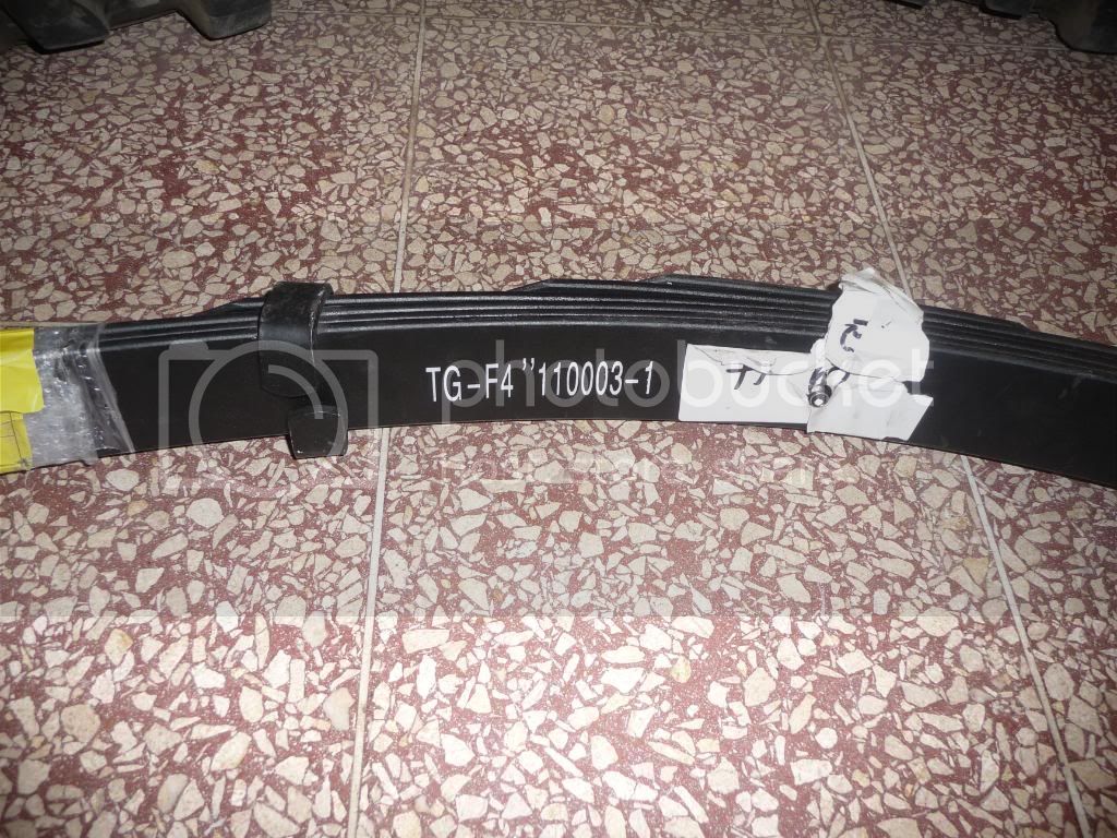

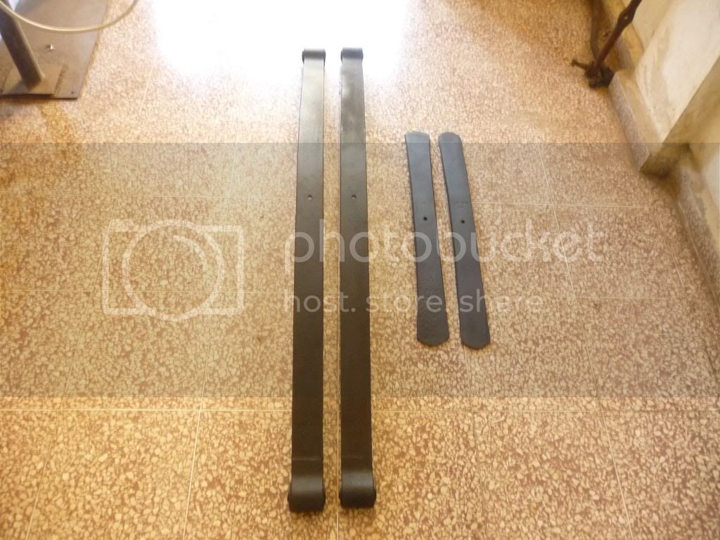

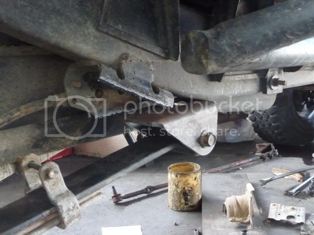

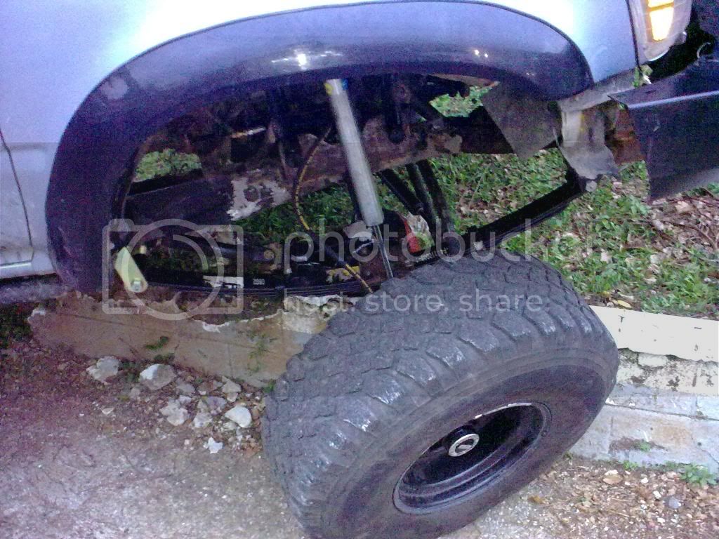

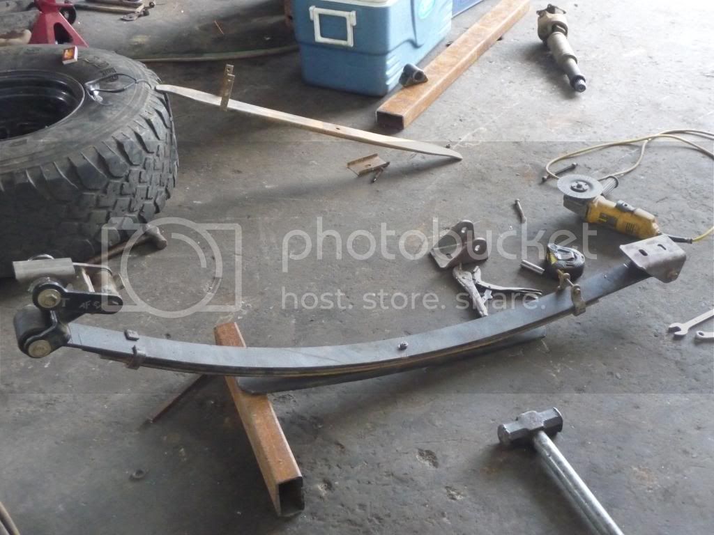

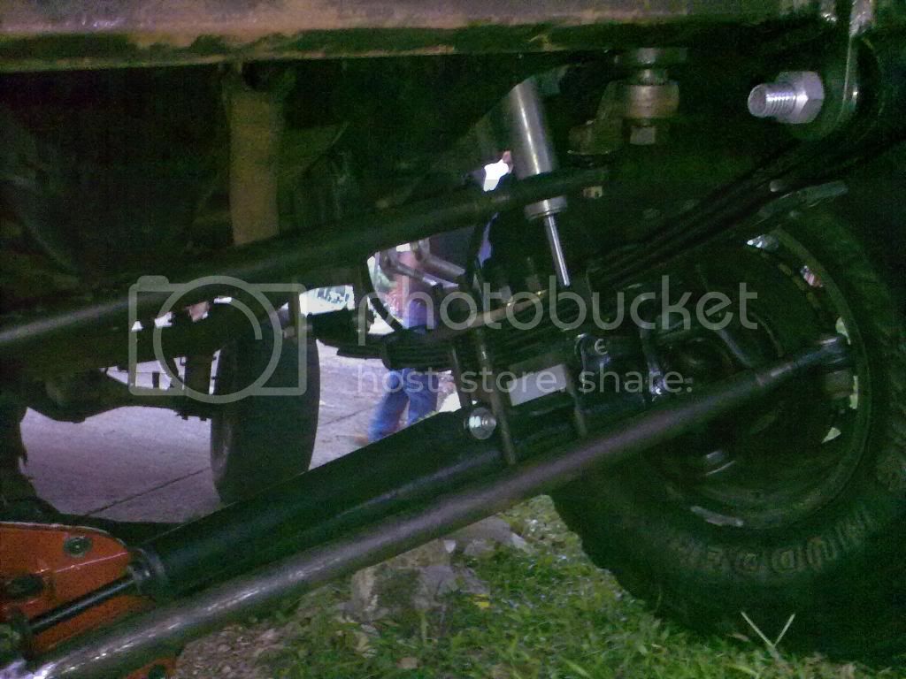

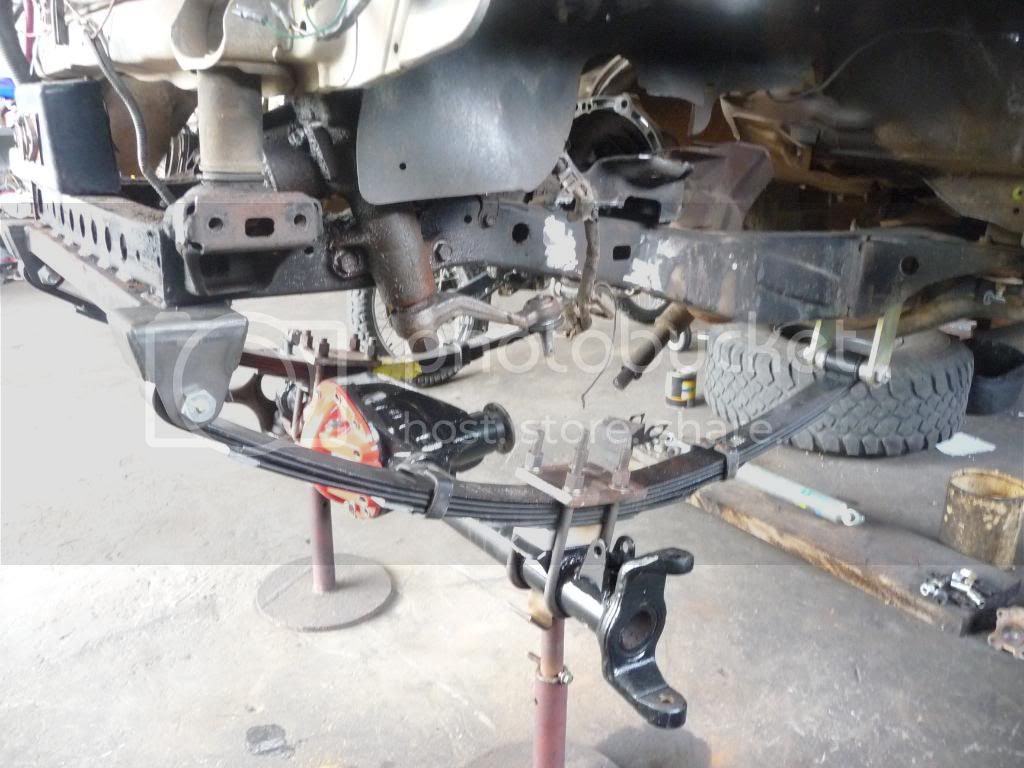

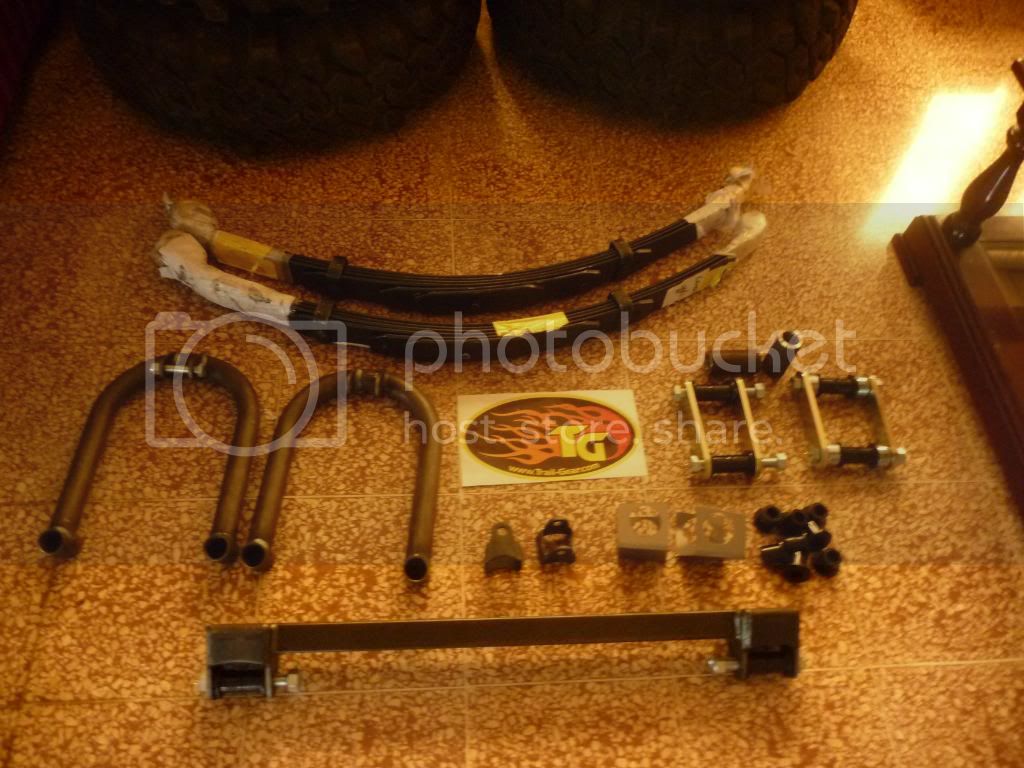

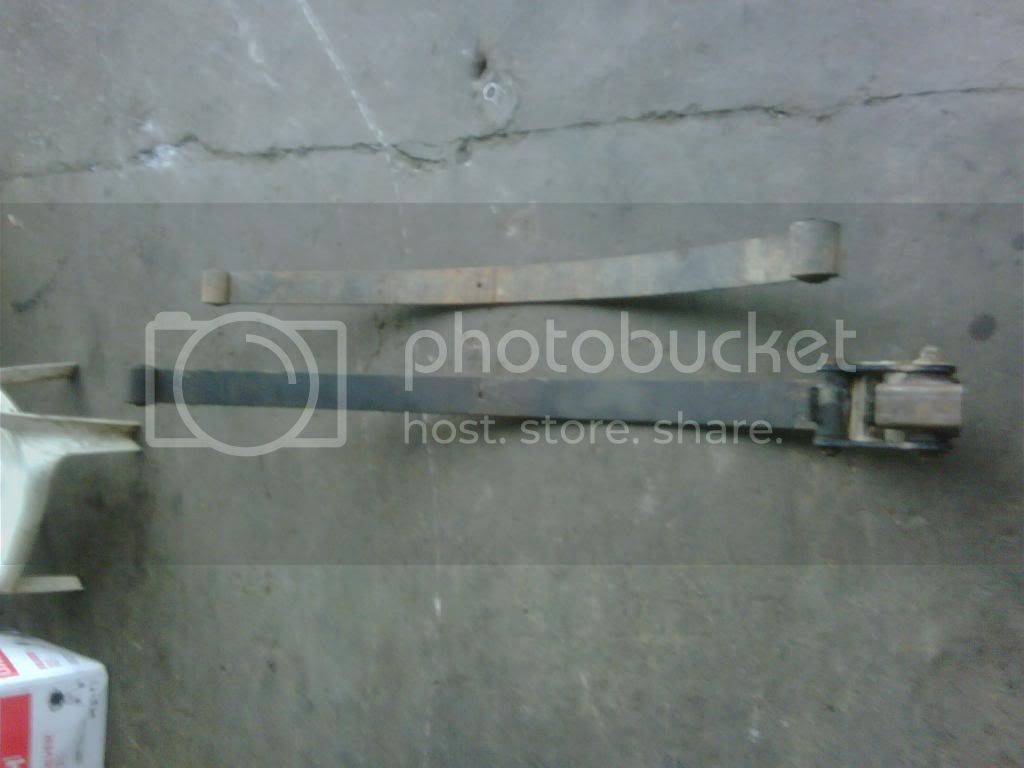

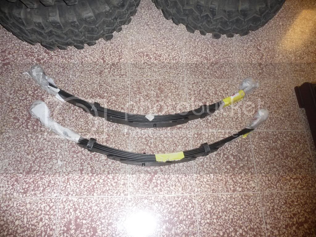

Chevy 63" leaf springs and over load leafs for the rear suspension
front leaf springs
4" lift

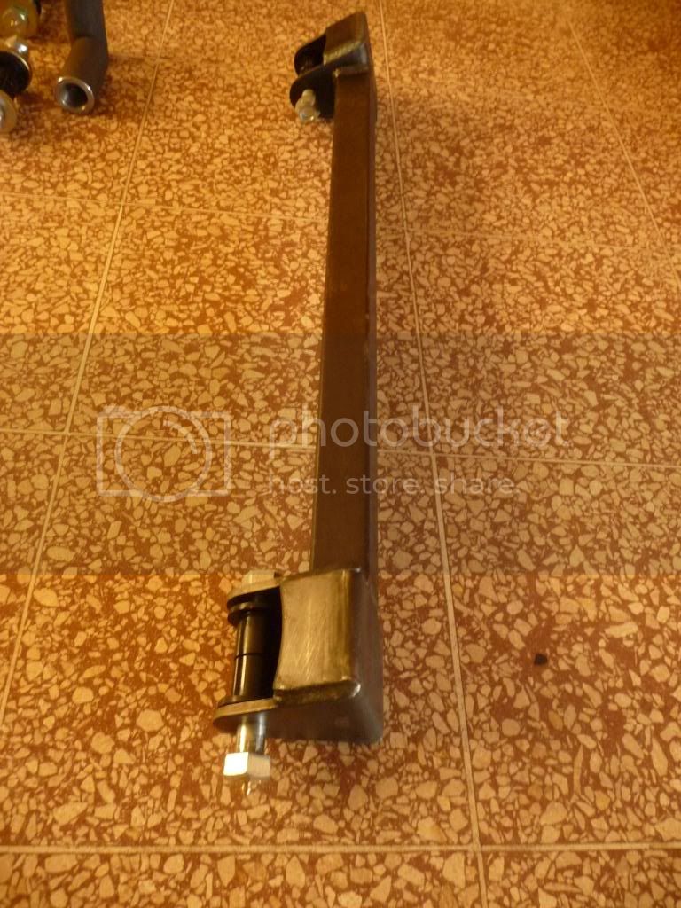

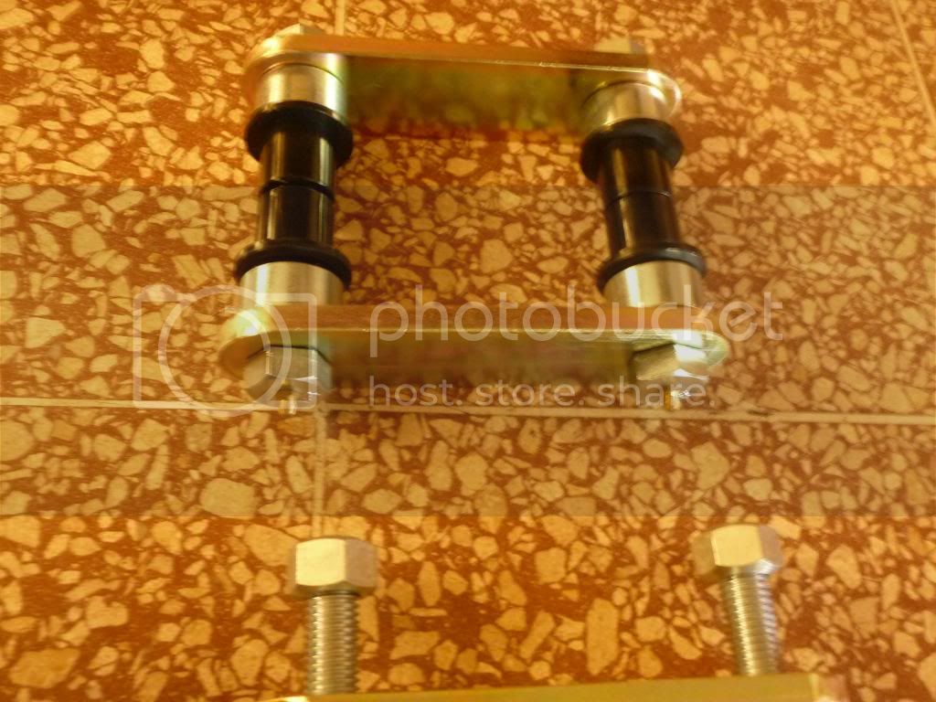

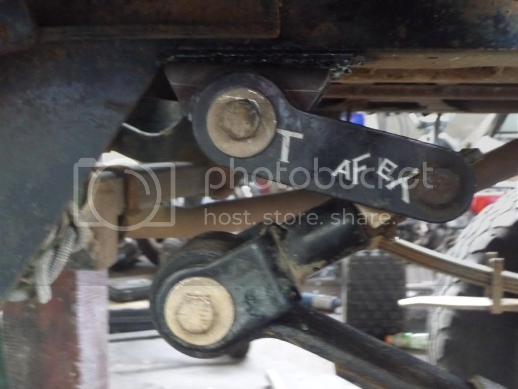

greasables Shackles

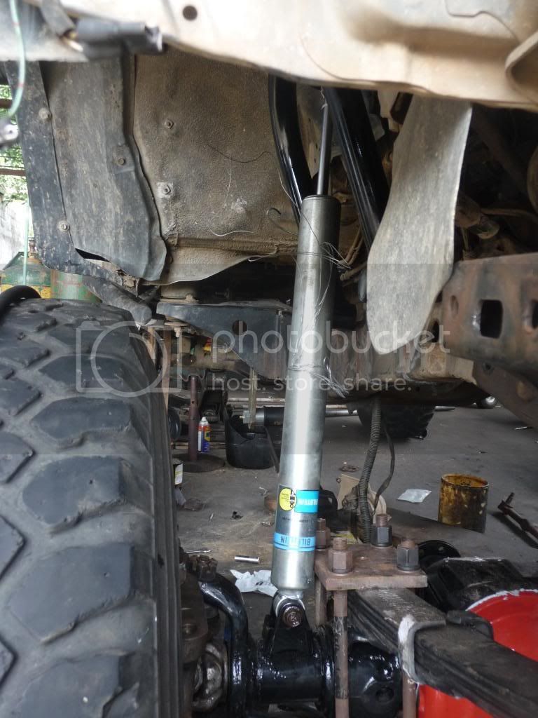

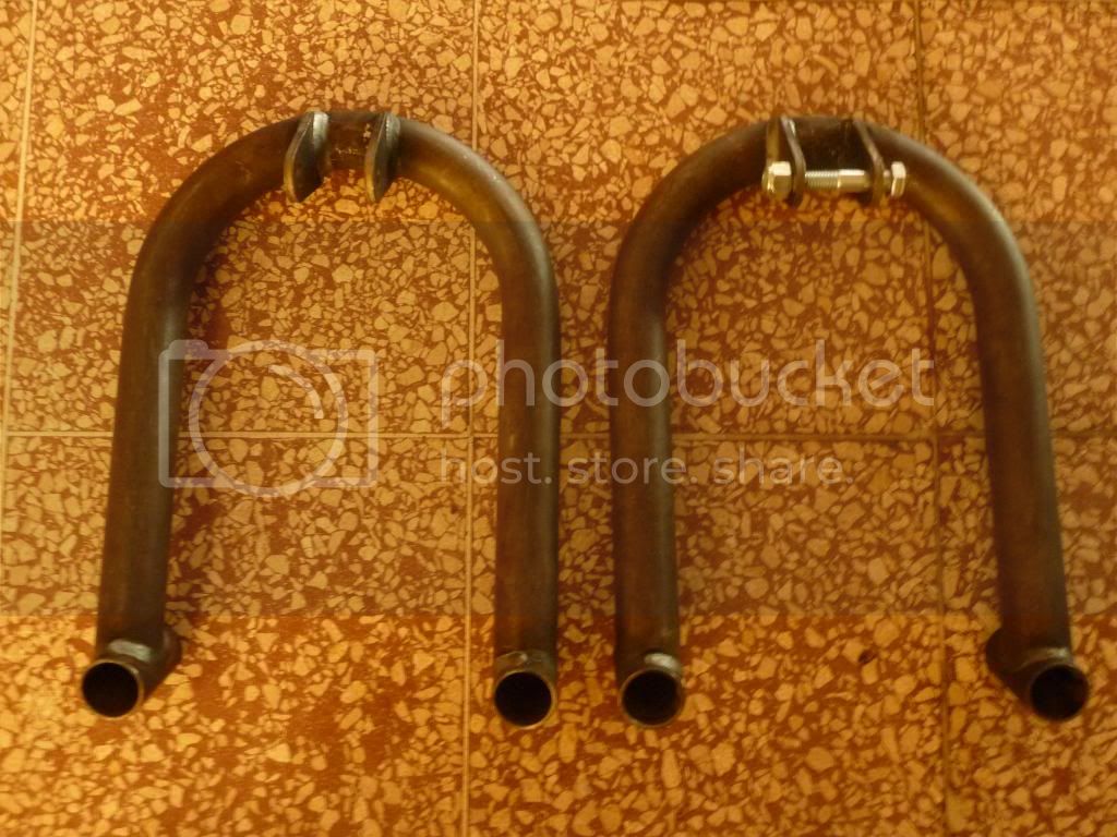

Upper Shocks mounts
Lower shocks mounts

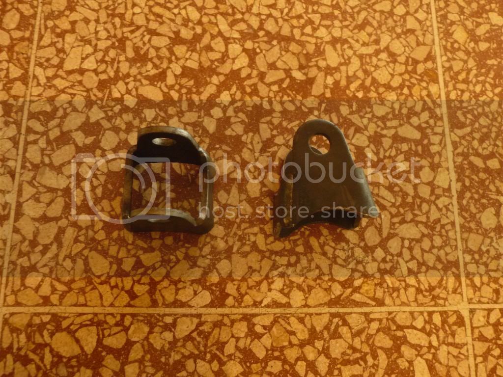

Shackle Hanger

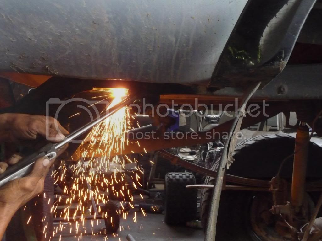

Parts keep coming...

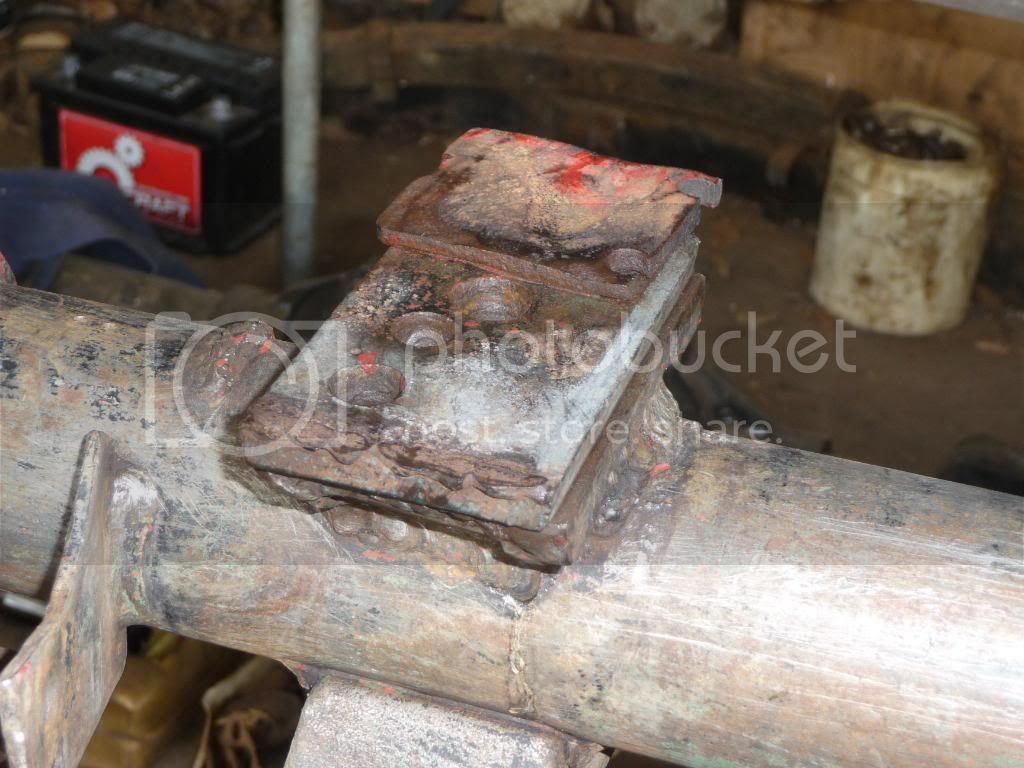

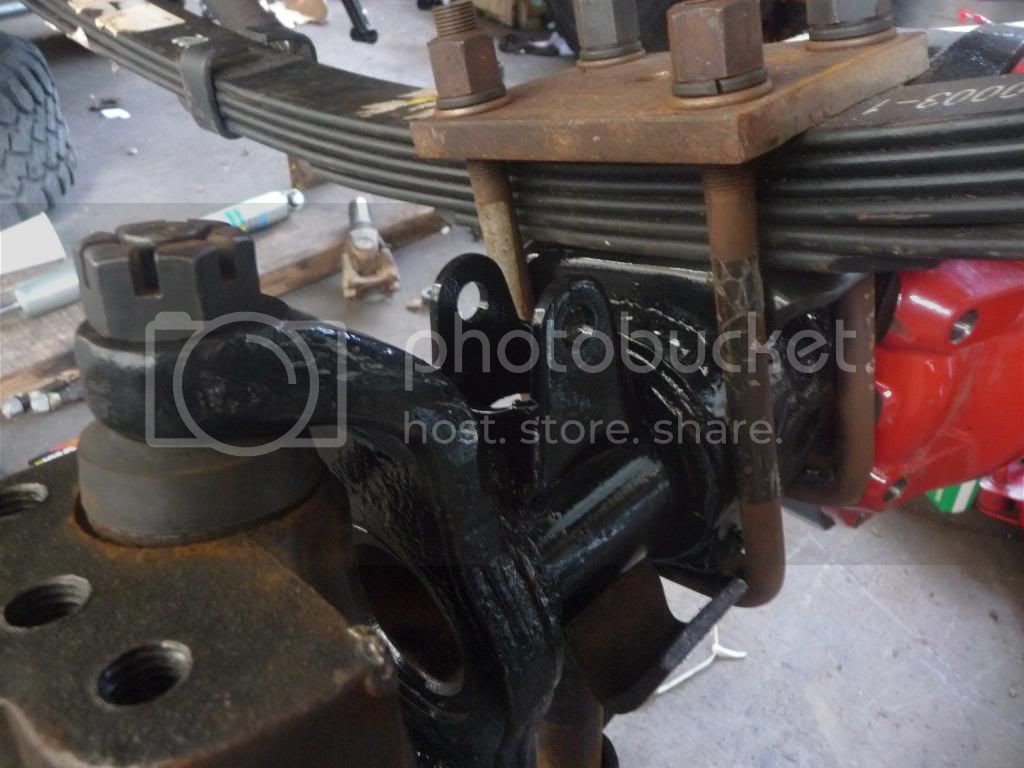

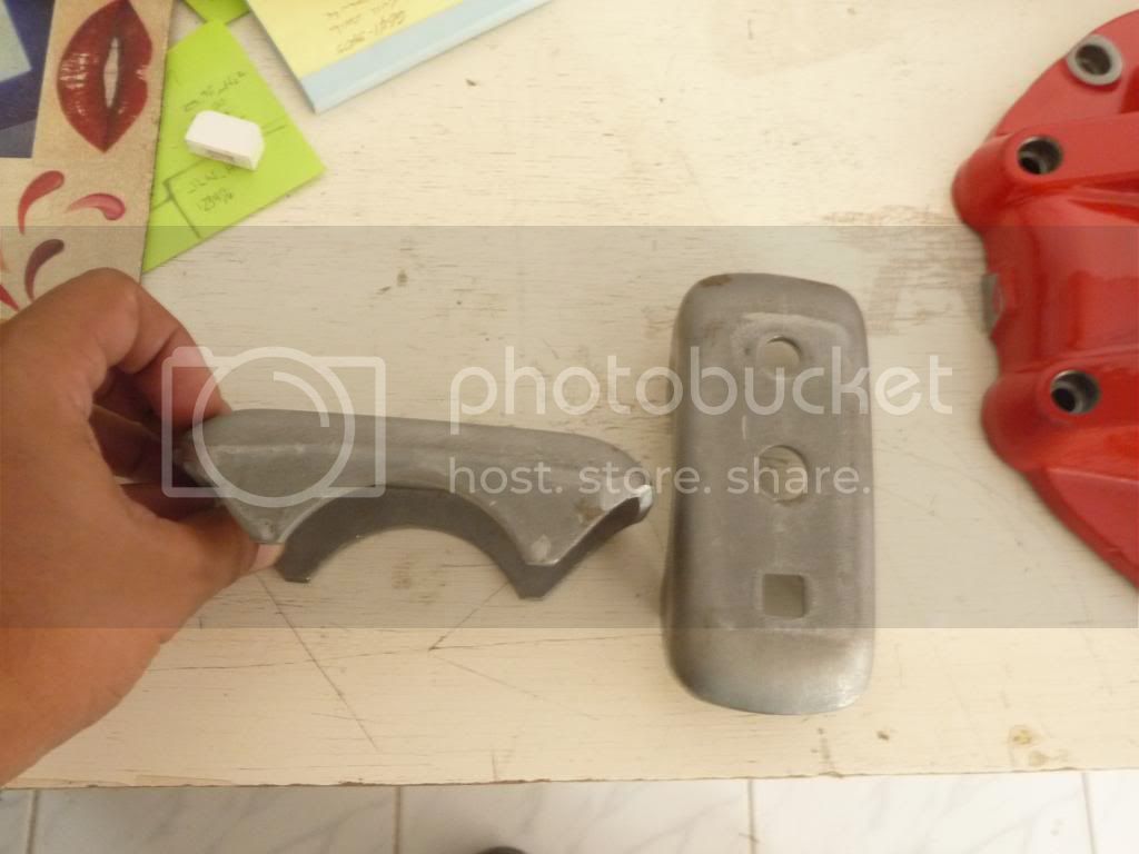

Home made spring perches will be replaced....
New Spring Perches

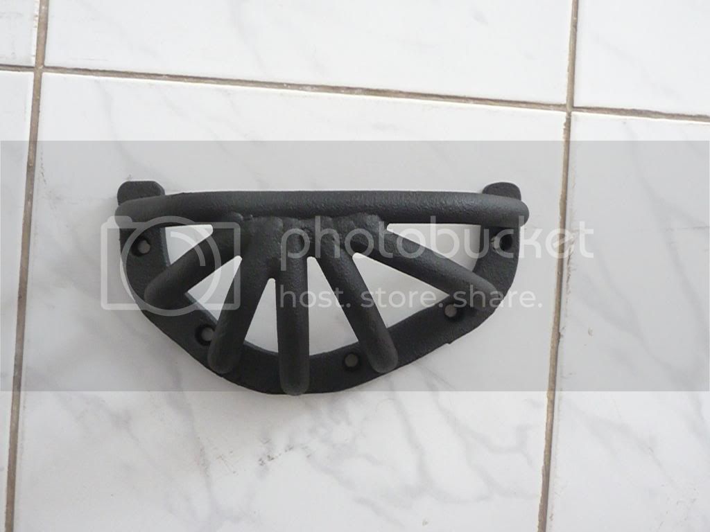

RockGuard

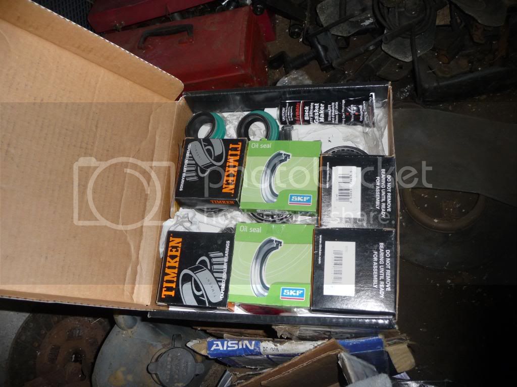

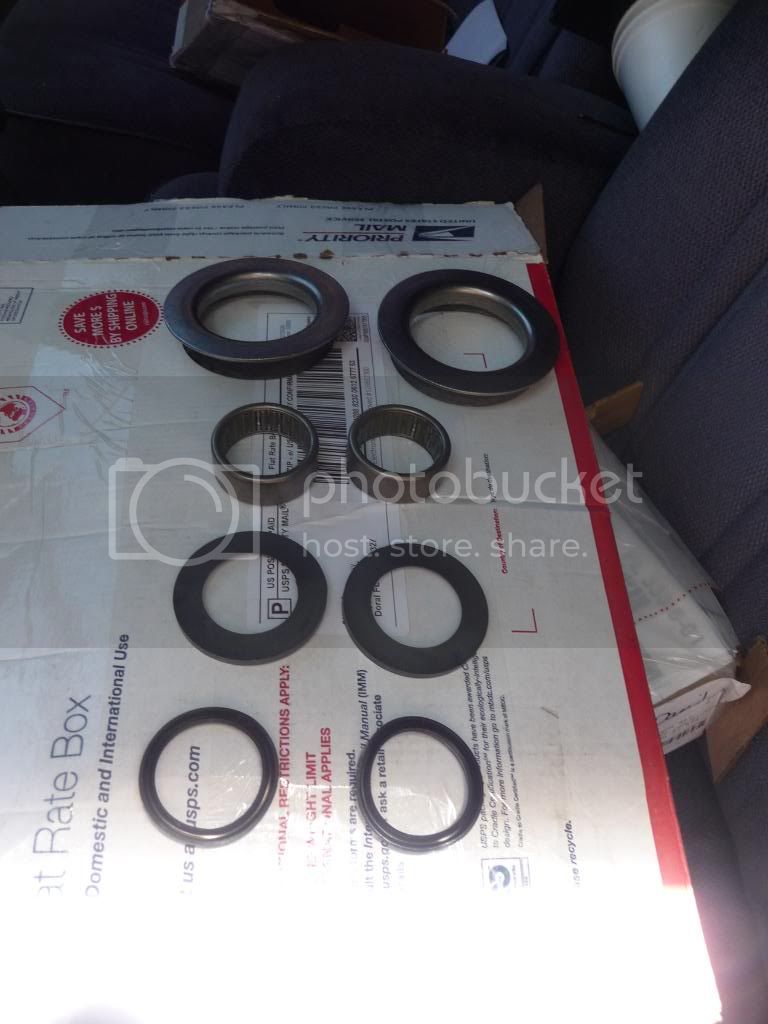

Spindles Bearings

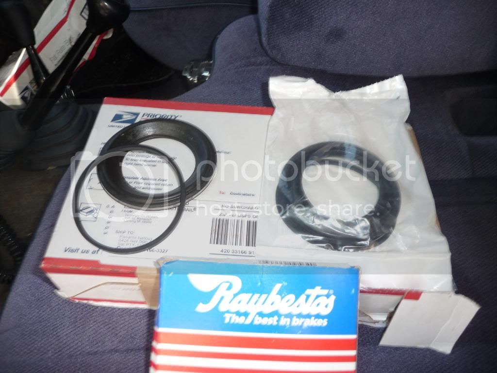

Calipers Seals

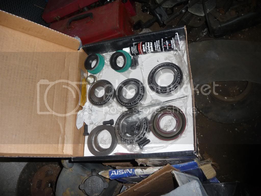

Ring & Pinion Bearings and Seals
Wheels Bearings

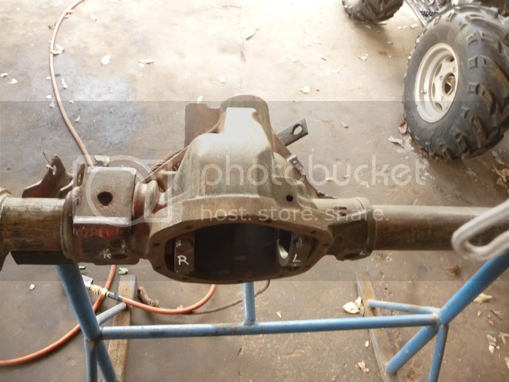

Housing

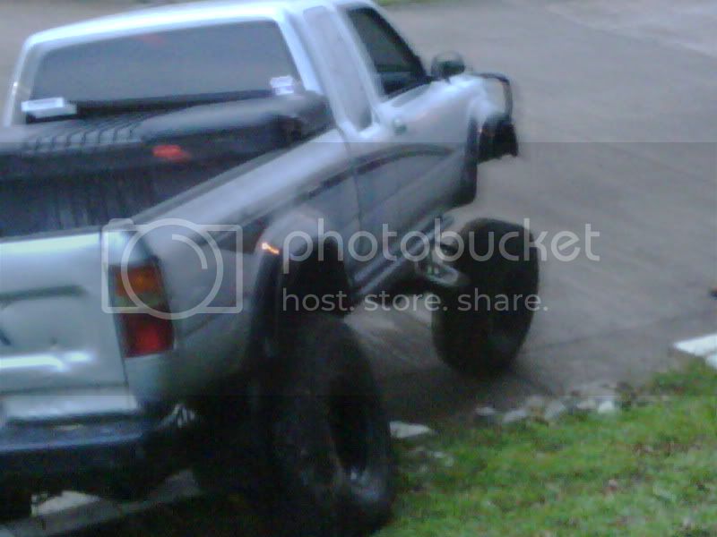

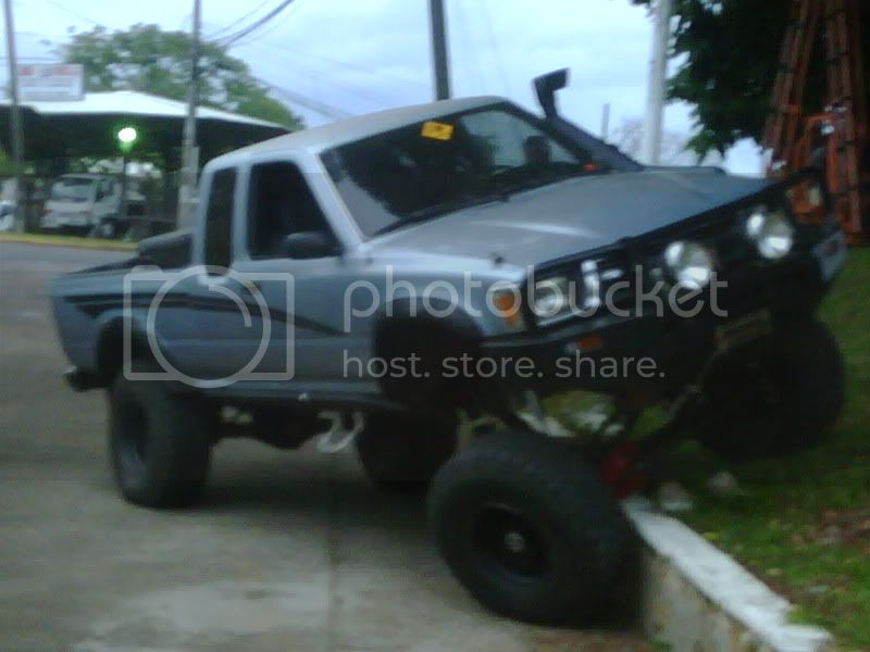

sweet I cant wait to see some flex shots ! I have the 63'' and a set of 44044 to go under my 83 and I have d44 and d60 to go under it nothing is getting swapped till I break something thoe... Whats up with the wrangler I know I had the jeep bug but lost it when I got my yota....
