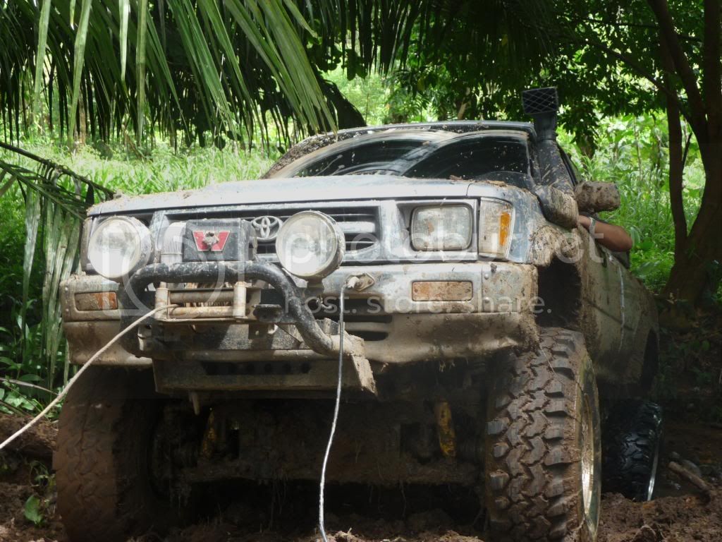

Hi guys i'm new on this forum, it have a Toyota Pick up with 7" lift, rear teraflex revolver shackles, LTB 35 x 12.5 R15, and a 22re with k&n air filter, headers and msd ignition and so on,
The question is i'm going to make it SAS, and i'm wondering to use a Wagg Dana 44 or earlier toyota 8" differential.
Wich size of tire is limit of each of those diff's???
sorry about my eanglish, i'm from Panama
here's a pic of my truck

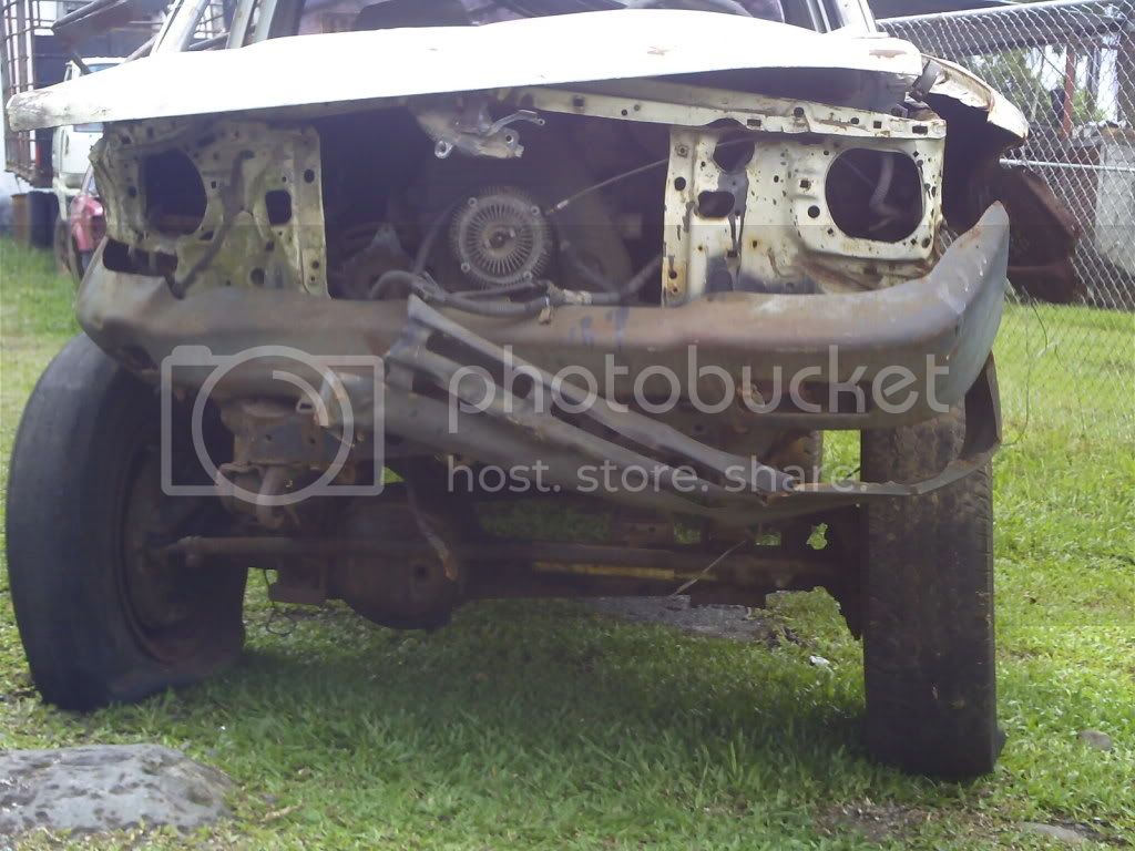

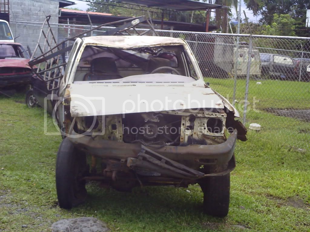

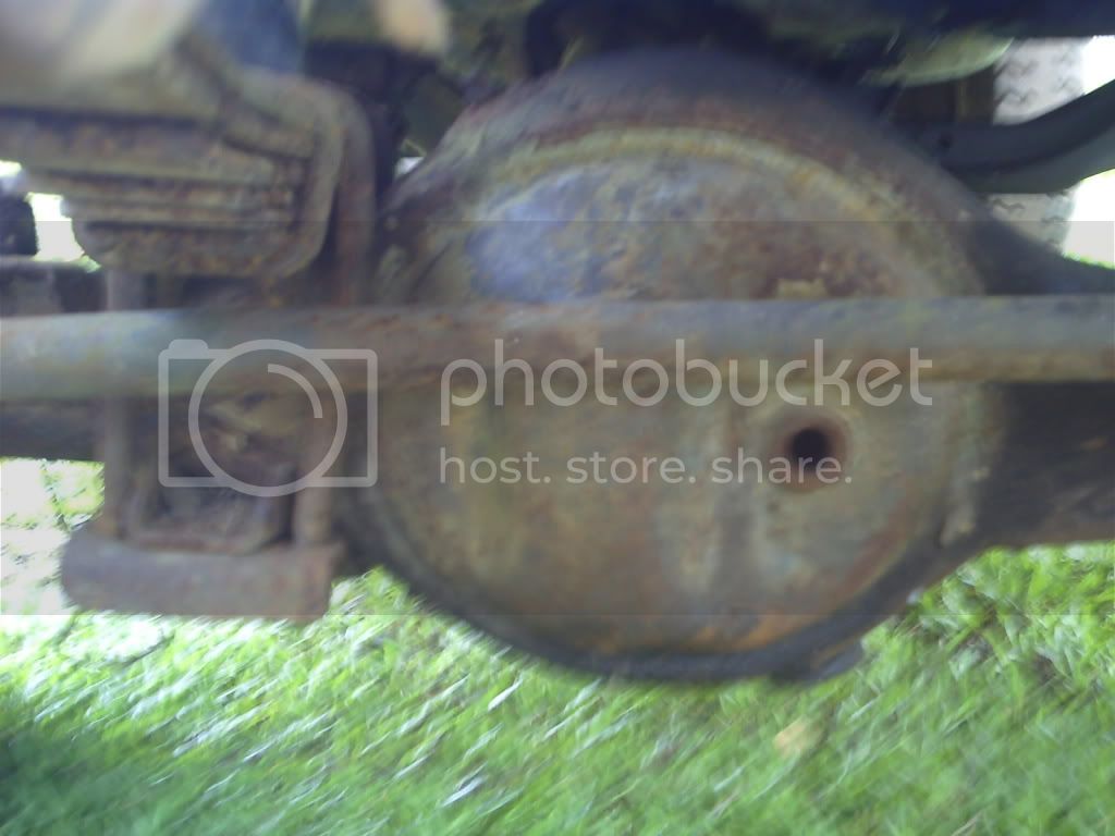

That 8" looks like its been through hell!
Id pull the 3rd, make sure its alrigt, but i dont think it will be given those pics! In that case, if this is your final for the two, id go 44, but you better do something about you ass end now!
