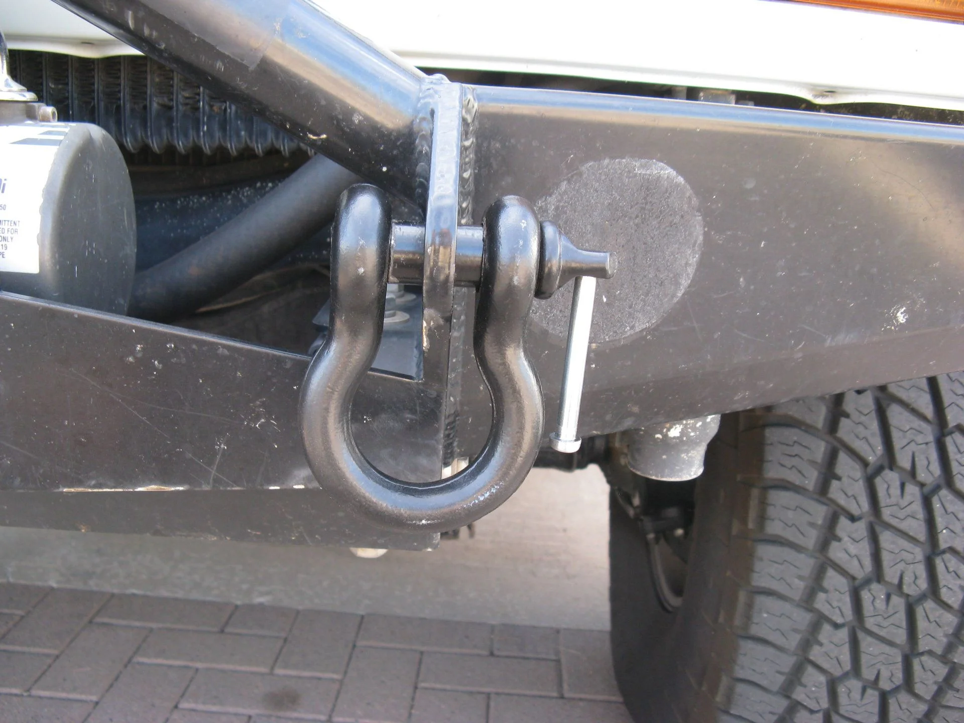

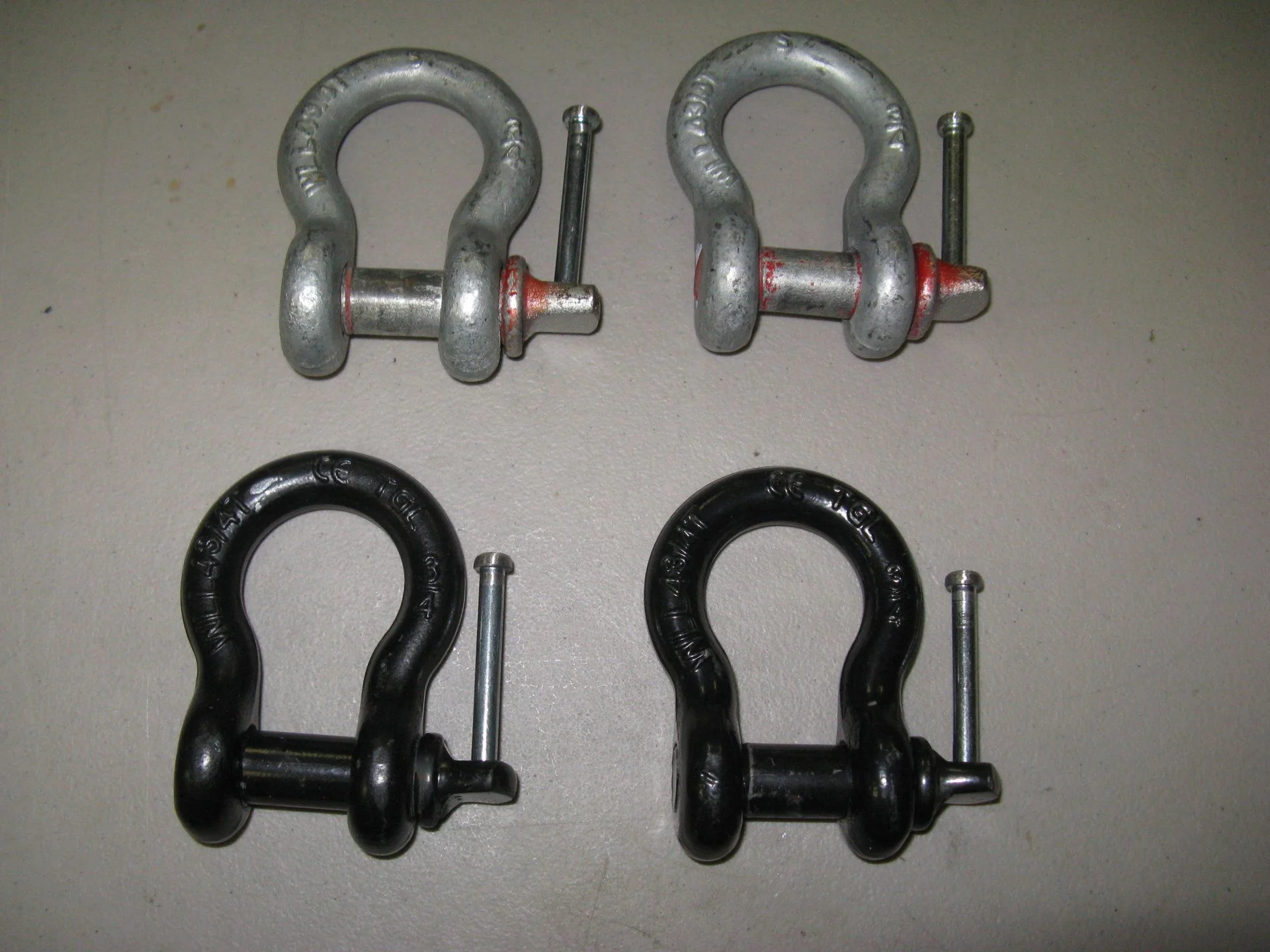

Just spent a couple weeks of winching and group I was with modified there D rings and I found it very nice so I decided to do the same. Just welding on a lever makes hook up and removal much easier when dealing with sand and mud.

10mm 15t rated
12mm 16.5t rated

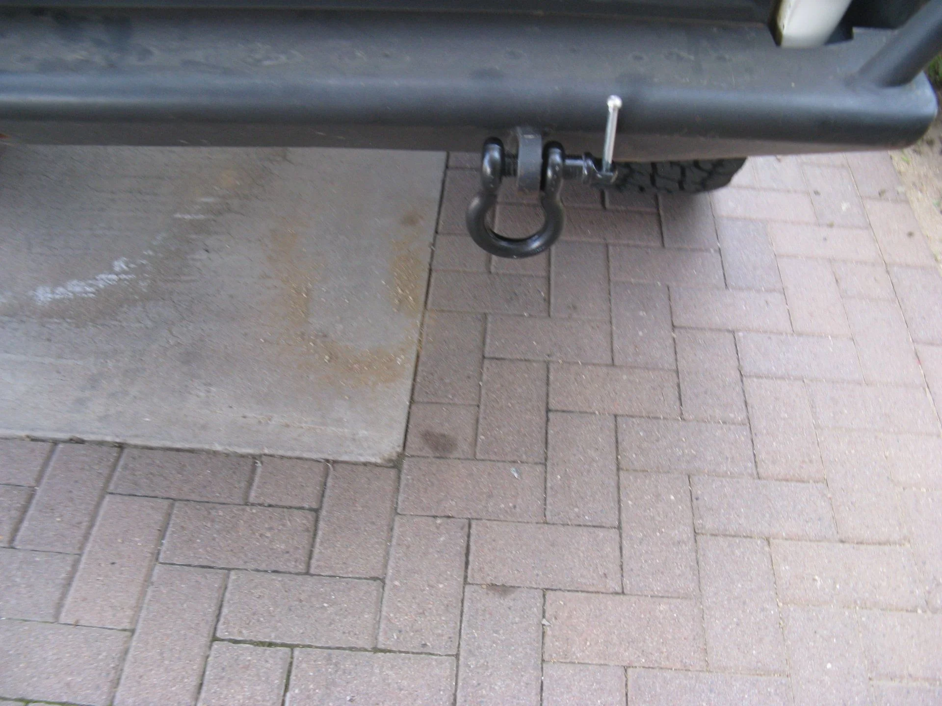

I like the idea of the little lever, I generally use a screw driver since a fixed lever like that would contact my bumper. Still haven't gone over to the soft shackle crowd, but I will be keeping an eye on those to see what you come up with.

Good point as I can now see the possible issue. Interesting with the 6+ vehicles I was with the lever was never an issue.:hmm: Now I need to check to see if I can attach the new levered D-rings to my recovery point on my Land Cruisers:eek: Soft shackles are looking better by the minute.

I'm confident it at least won't work on a Slee shortbus. Not sure if my labs rear would either.
Thank @half k cruiser for making me take another look and realizing my mistake.
Yes they will fit a shortbus without modification
No they will not work on a 4x4 labs without modification
No they would not fit the tie down points on the LX470 without modification
Now they fit everything
