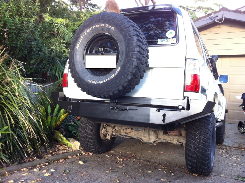

I made this rear bar over Christmas and figured some might like to read how I went about it and maybe inspire others to have a go. Like the front one I made earlier, this rear bar was a combination of what I wanted to achieve with the design regarding departure angle clearance, rear quarter protection and over all looks. I also took inspiration from other custom rear bars, many right here on IH8MUD :cheers:
As always, even the best laid plans can change as a project evolves and this rear bar was no different. Here's some build pics (lots) and a bit of a description along the way...

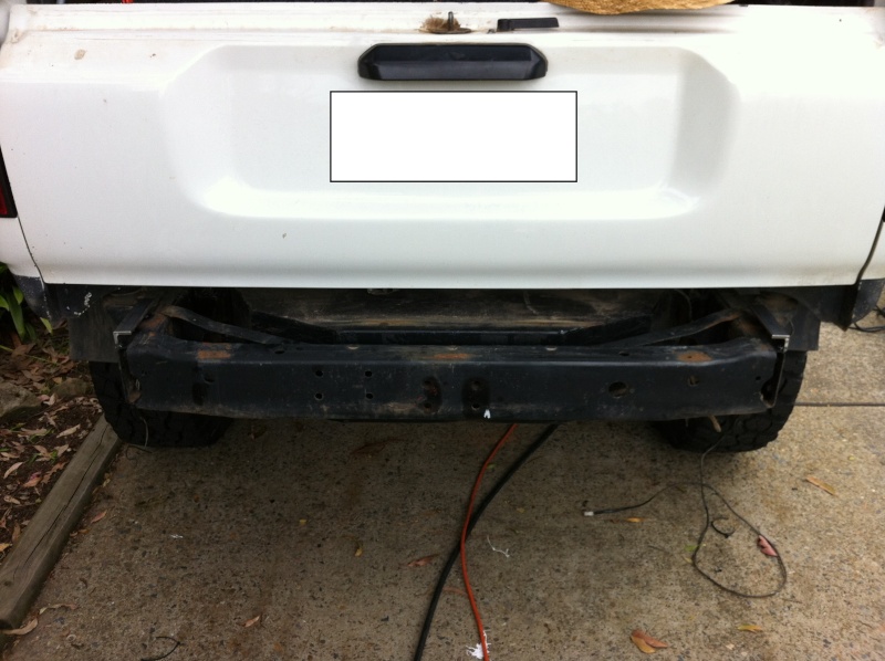

Starting with a blank canvas

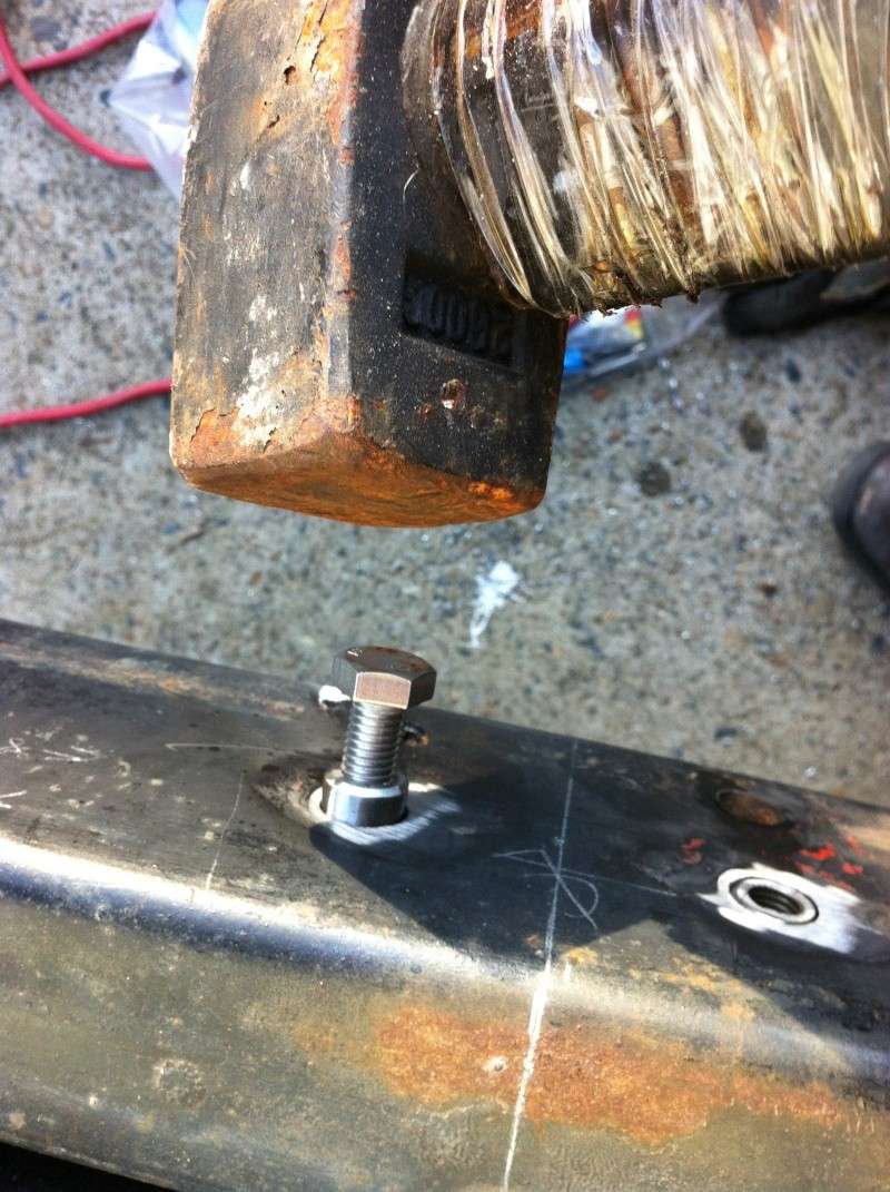

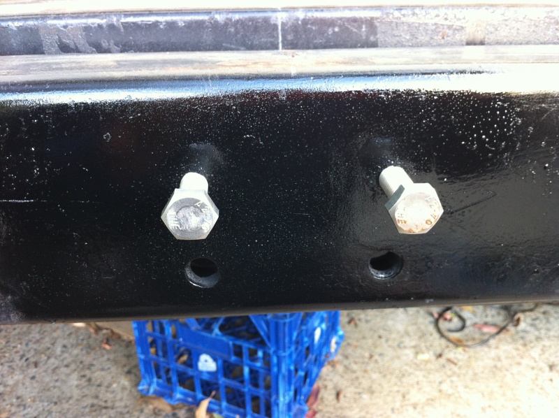

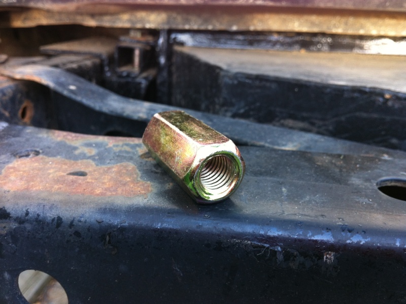

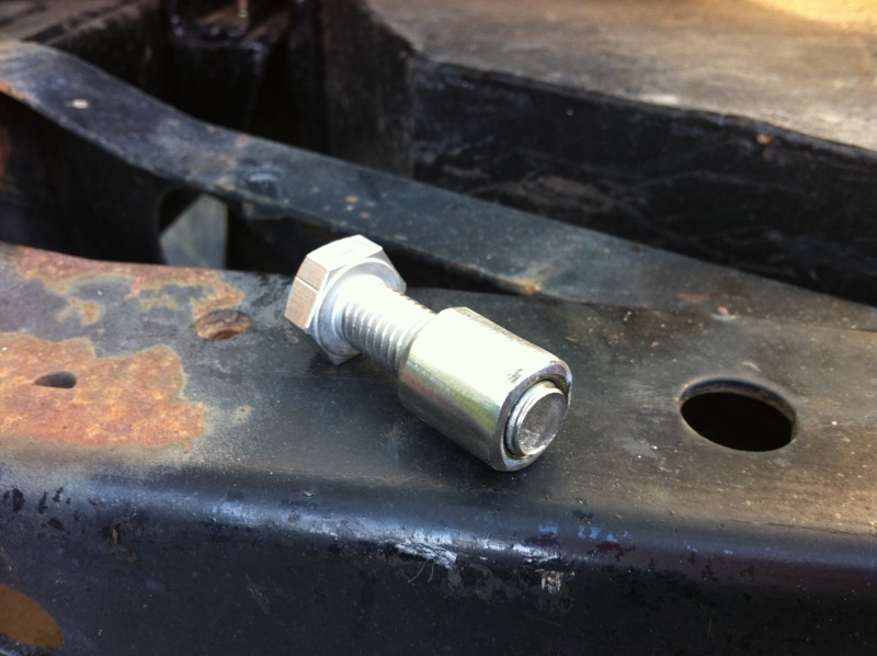

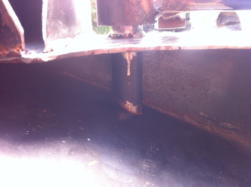

I also wanted to take advantage of the factory fixing points. Mine had rusted and the threads destroyed so I had to fix them. Cue two, 10x1.5mm x 40mm threaded rod couplers...
http://www.servimg.com/image_preview.php?i=422&u=14684539
Grind down for a friction fit onto the 20mm hole I drilled into the original fixing points...
http://www.servimg.com/image_preview.php?i=423&u=14684539
Bevel the outside edge for better weld performance and tap into position...
http://www.servimg.com/image_preview.php?i=424&u=14684539
Weld, grind and paint and you're good to go. Note: to protect the threads from weld splatter, I screwed in a old bolt covered in grease. The bolt got binned but the threads were as good as new. repeat process for all four holes.

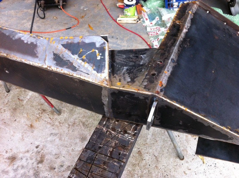

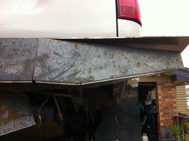

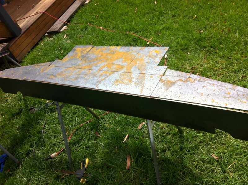

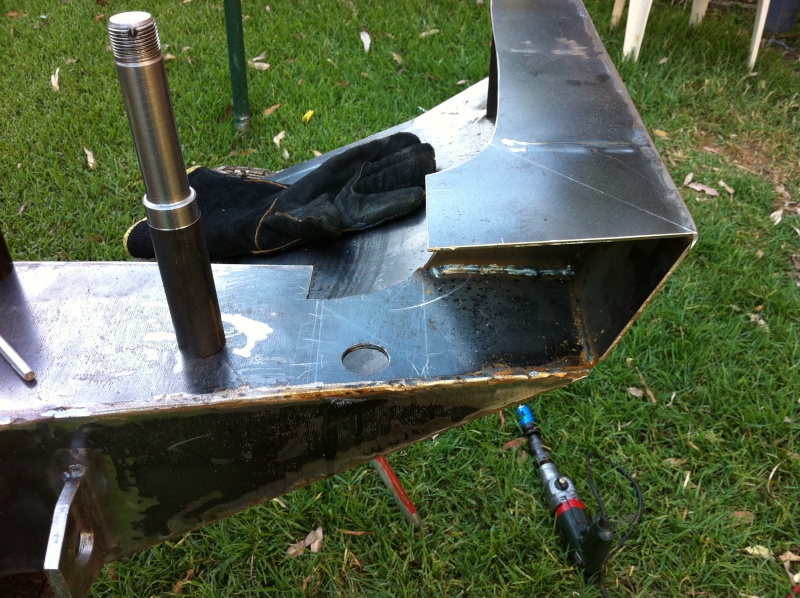

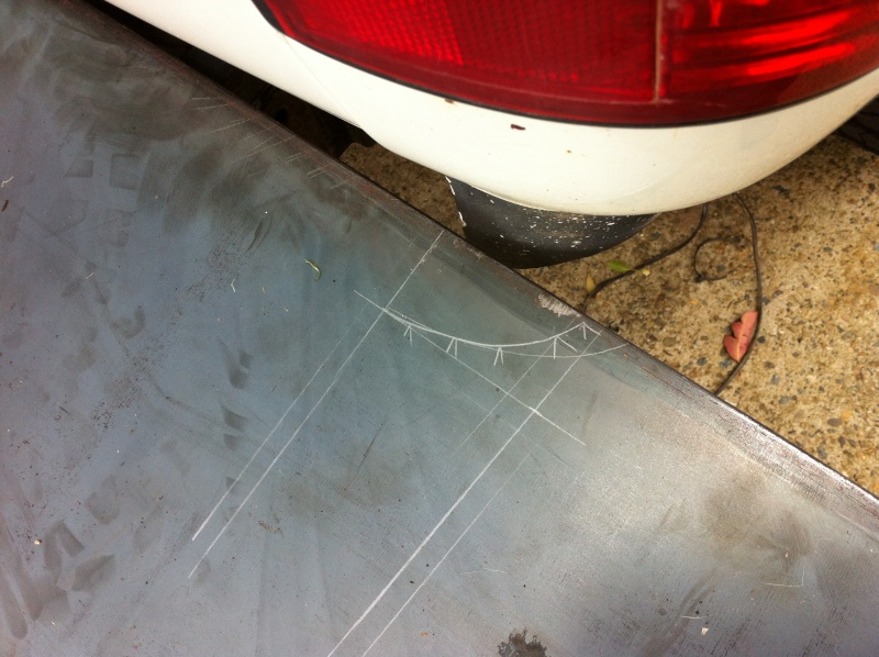

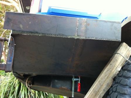

The plan was to fold as much as possible out of one sheet. For the main bar, I used 5mm sheet steel. Starting with the top rear, I began to scribe it into the body work
From there, with careful measurements ,I was able to mark out all the folds needed to make it up out of one piece. I may have checked my measurements more than once :hhmm:
I used the score, fold and weld method since I don't have a folding machine. It is a time consuming process but is accurate if you take your time with neat, straight cuts and consider for allowance like metal thickness lost when folding and cutting the right side depending which way you want to fold to go. Basically, always score along the outside of the bend.
A quick test fit showed it was mostly all going according to plan. The flaps shown here are turn downs that are intended to hang a bit lower than the sub tank for added protection. In the past, a few steep drop offs have tagged the back edge of the tank, denting it. I then trimmed them back so they protruded past the lower edge of the tank about 12mm.
Part of the plan was to keep it close to the body while still offering good protection. I was also chasing that custom form look so was willing to take a few chances with design. Here, I'm folding in the lower section toward the external corner so it doesn't have that boxy look.

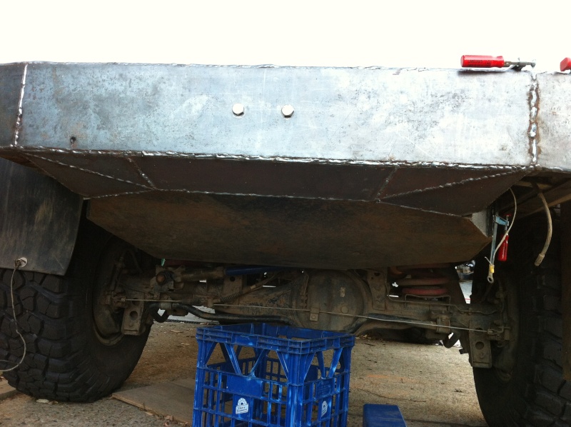

Here, I'm tacking into position the 3mm sheet to complete the sub tank protection. These go from the bottom edge of the turn town at the tank, back up to the lower, external corner of the bar. They act as reinforcement but also to give the rear of the bar clean, tapered lines.
Here it is in position ready for grinding.

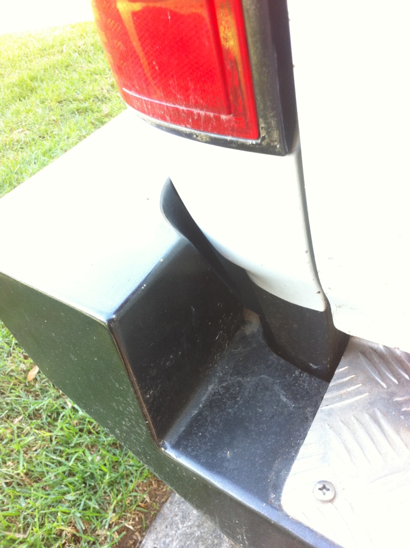

I didn't want the same old side wing setup most rear bars have and was intent on doing things differently. I was also sick to death of having mud caked up in the wheel arches and through the rear of the chassis. I really wasn't sure how it'd work out but decided to run with it. To begin, I needed something solid to build off, so I made a mounting plate that bolted to the 4 captive nuts in the lower part of the chassis.
Then, using some 3mm sheet, I got stuck into it...
Out of the one piece, the sides turn up. Here, I'm just playing with angles and aesthetics while keeping rear quarter protection in mind.

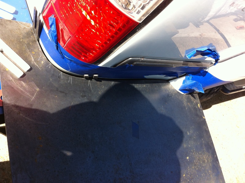

I then scribed another piece of 3mm sheet around the rear quarter panel. I made a cardboard template first but it still took a while to get spot on.
Trimmed to size and in position. A tip for young players is to leave things a little longer than you might need them. It's easier to cut it back 3 times than it is to join it. Also, sometimes things get overlooked and you realise you shouldn't have cut it where you did.

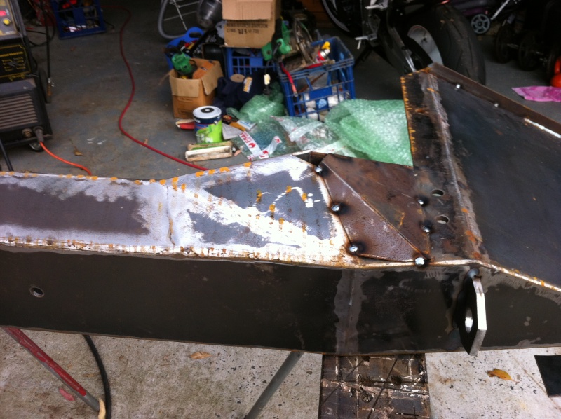

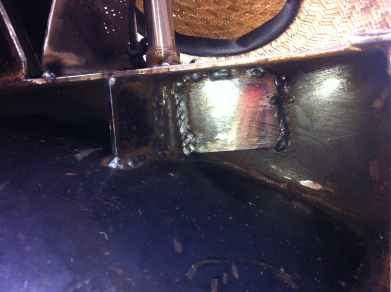

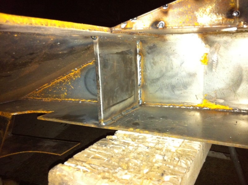

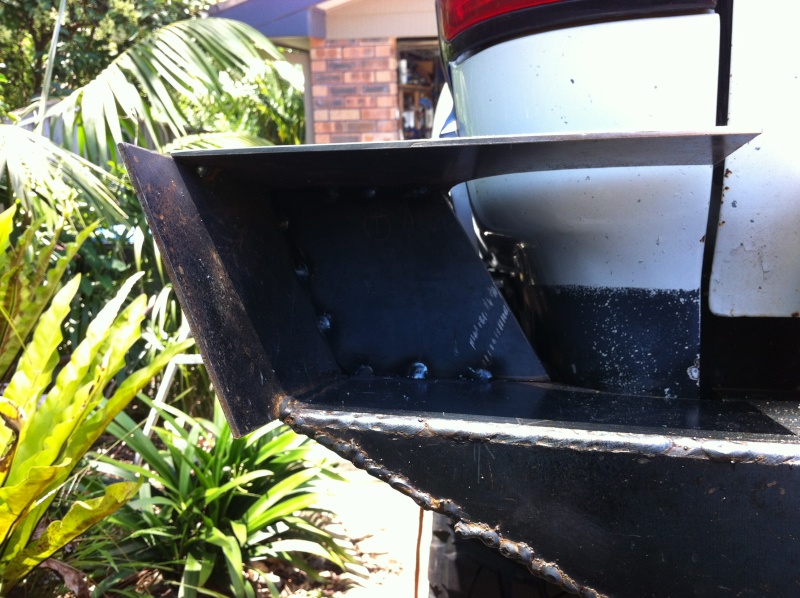

I then fitted some internal gussets. Small gussets and braces in the right positions allow you to use much lighter materials for the same, if not more strength. These were all fully welded later on.
I then removed the bar and did some more welding. I also decided to beef up the fuel tank protection which would also serve to tie in the lower section of the side wings where they bolted to the chassis. While it may not be shown. The 3mm plate was fully welded to the 5mm plate I made earlier to mount to.
And some more fancy metal work to blend it in. Note the angle tacked into position at the far end of the wing - this will be used to mount the mud flaps to. I've also checked in the recovery points.

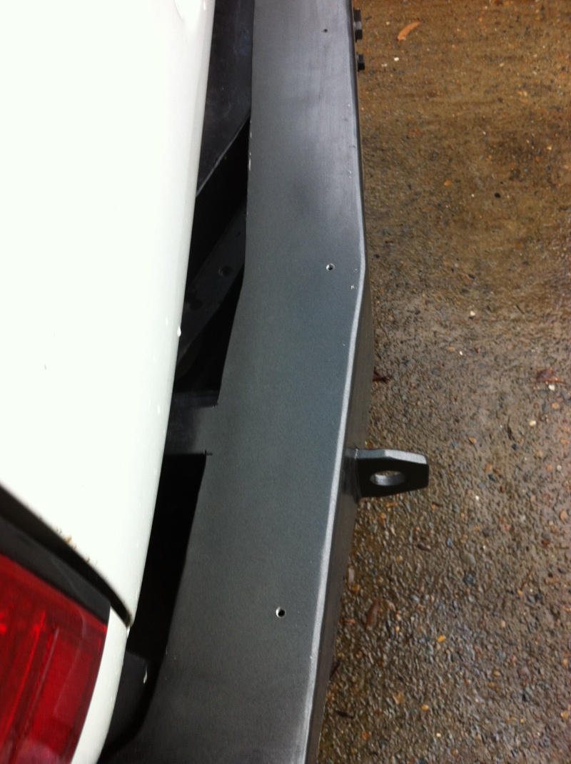

This shows the full size of the plate that forms the recovery point. 10mm plate IIRC.

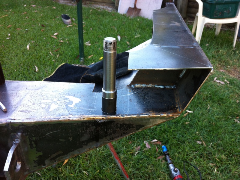

Next, it was time to start on the wheel carrier. I ordered a spindle, bare hub and bearings from here: Tire carrier hinge kit - Jeeptubes.com
Cut to length and in position...
Beveled the bottom...
Gusseted and welded for maximum stiffness.

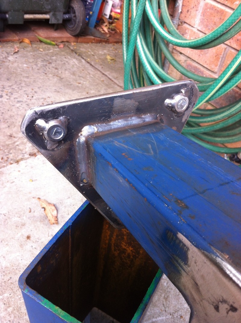

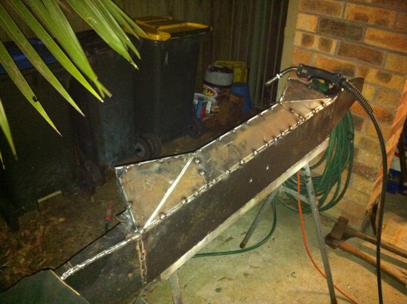

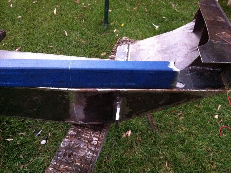

For the main swing arm, I used 75x50x4 RHS. Here, I've scribed the end for a neat fit to the hub. Ive also marked where it needs to be bent to follow the curve of the rear bar.
Here's the arm now bent. I ran several layers of weld over it to beef it up and blend it back in.
I also ran a heap of welds to beef up the join and also build it up for a neat finish. I'm about halfway here.

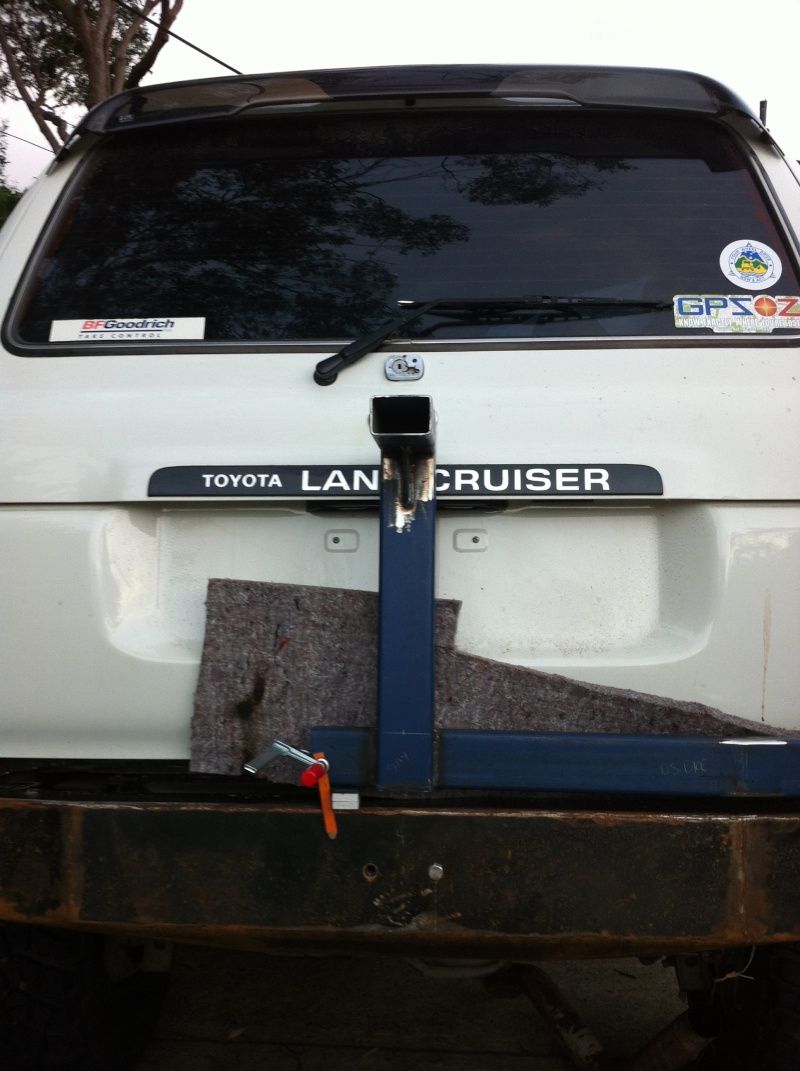

For the vertical arm, I half lapped it onto the horizontal for added strength and to avoid extra gusseting and to also give me added clearance to the tailgate. I welded in one gusset under the outrigger that supports the 35in tyre - just to be sure.

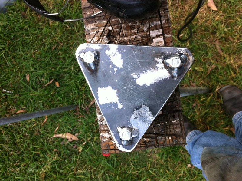

I had to mark out the spacings for the wheel studs. To say I struggled working out the spacings was an understatement but I got there in the end :doh:
See :bounce2:
One last test fit and tune before finishing the grinding and painting it.

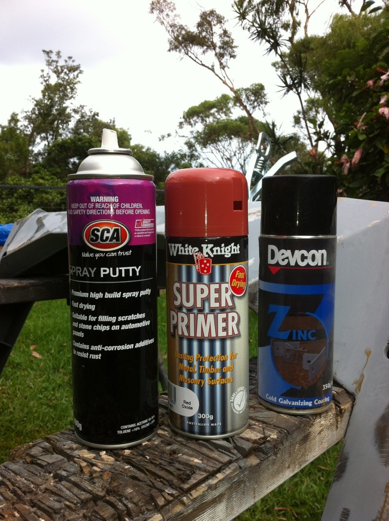

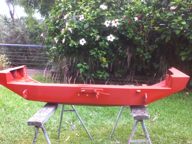

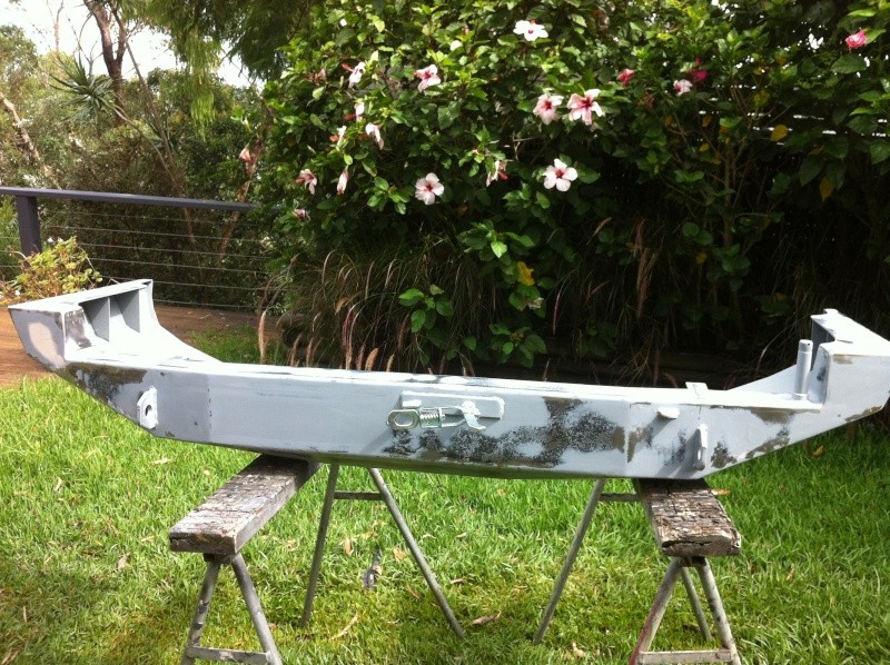

After a quick once over with some builders bog to fill in any remaining pinholes and minor imperfections, it was time for several layers of high build primer before blocking it back to a silky smooth finish. At this point, I lathered the inside areas with the zinc based paint for added rust protection. You can also see other bits and pieces that got fitted and weren't shown earlier.
The weld on, over centre latch is from Universal Engineering Supplies.

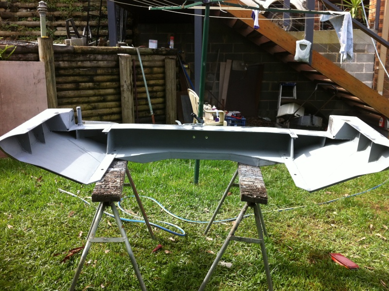

Here, you can see the extra gussets welded in. Fully bolted up, the whole bar is rock solid.
Then 2 coats of metal primer...

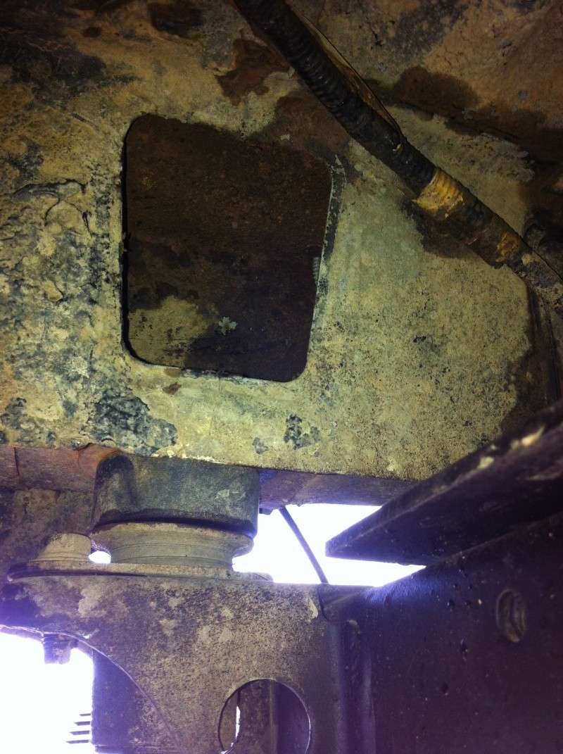

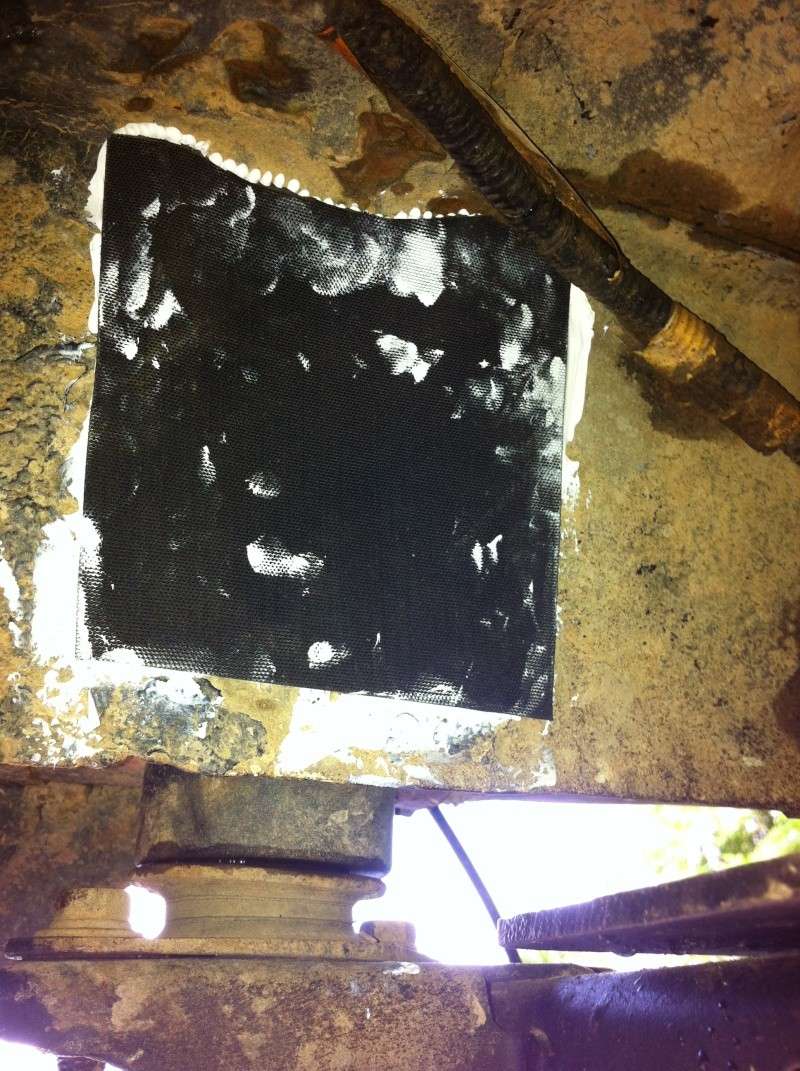

If you stick your hear right up in the rear quarters, you'll see a hole on each side about the 75mmx75mm. This area is prone to fill up with mud and water.
After a good wash out with the hose the day before, it was time to stop crap getting in there. With a bit of rubber cut to size and some FixIt sealant adhesive (very good stuff)
Done. I did leave a bit of a gap at the bottom to let any water drain out that might get in there. Once dried, I coated the whole area with several coats of body deadener.

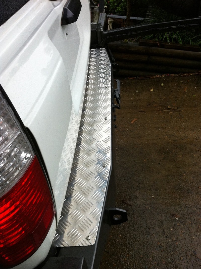

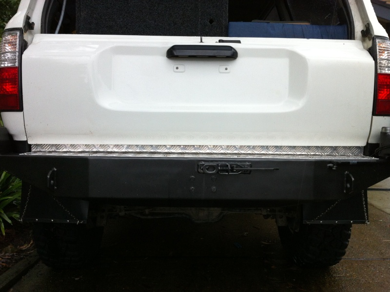

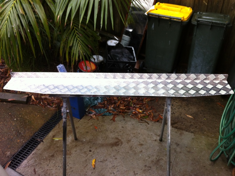

A mate bent up some 1.6mm alloy checker plate and I trimmed it to size
I drilled and tapped (M6) the top of the rear bar...
And screwed the alloy into position

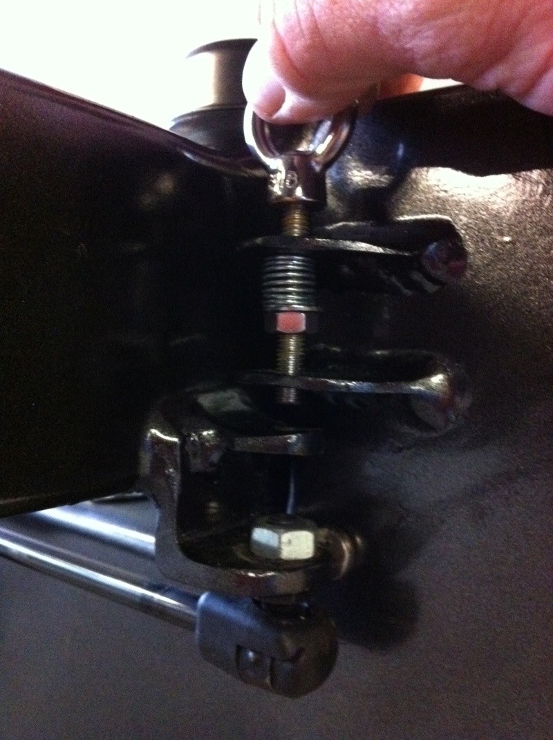

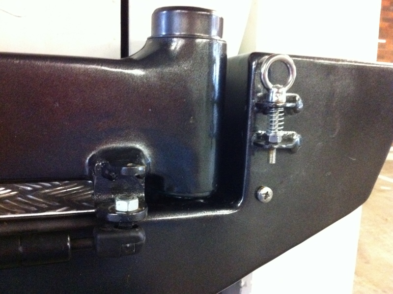

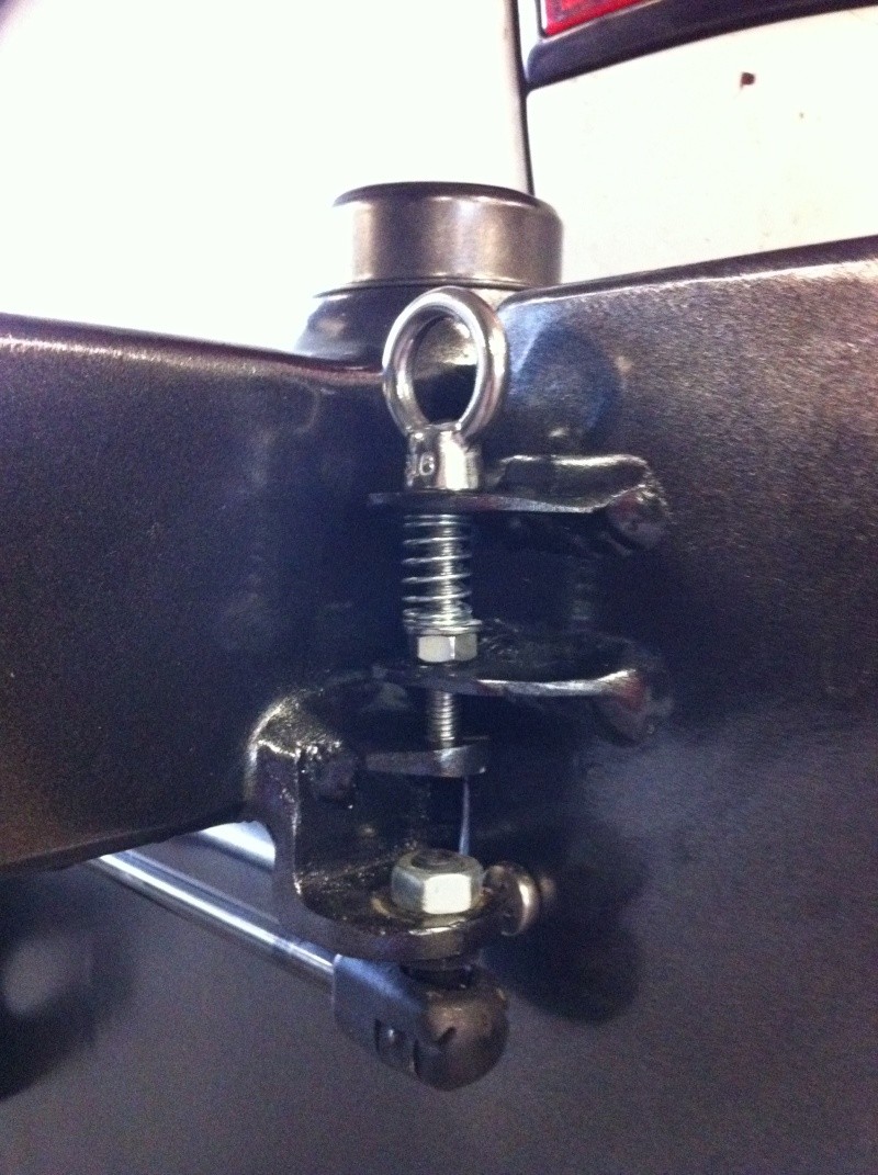

Next I had to come up with a neat way to keep the swing arm open. After a bit more head scratching, I came up with this - cheap and effective :idea:

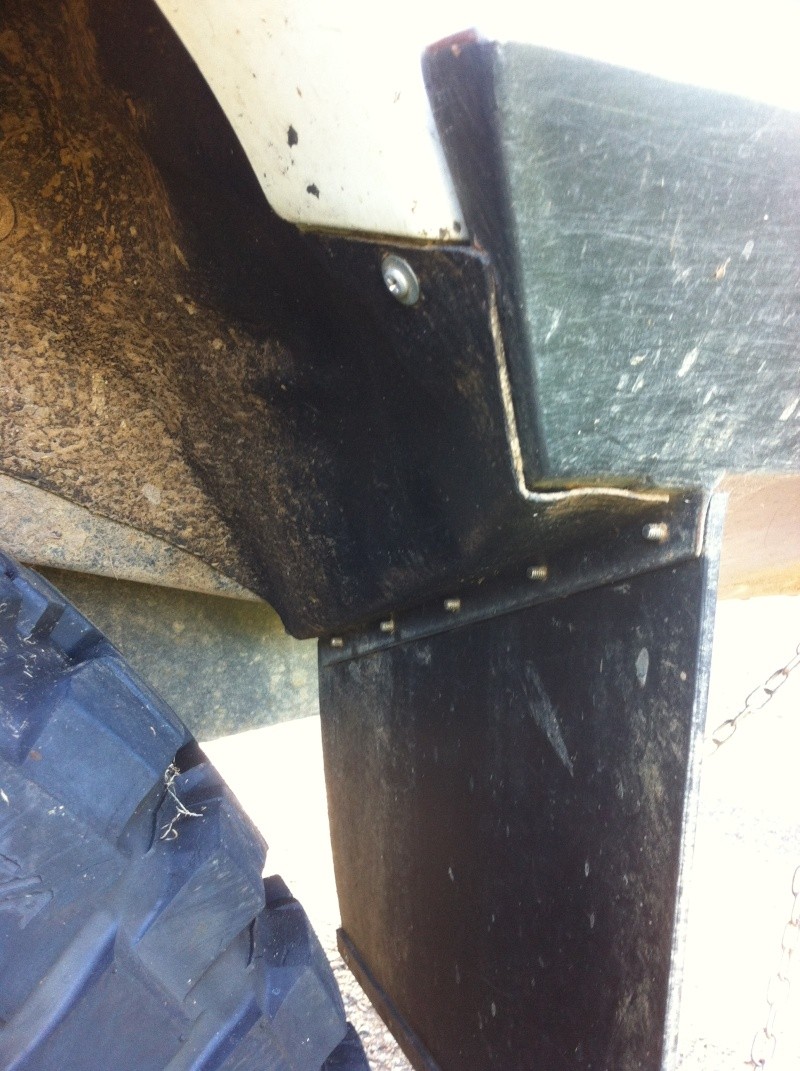

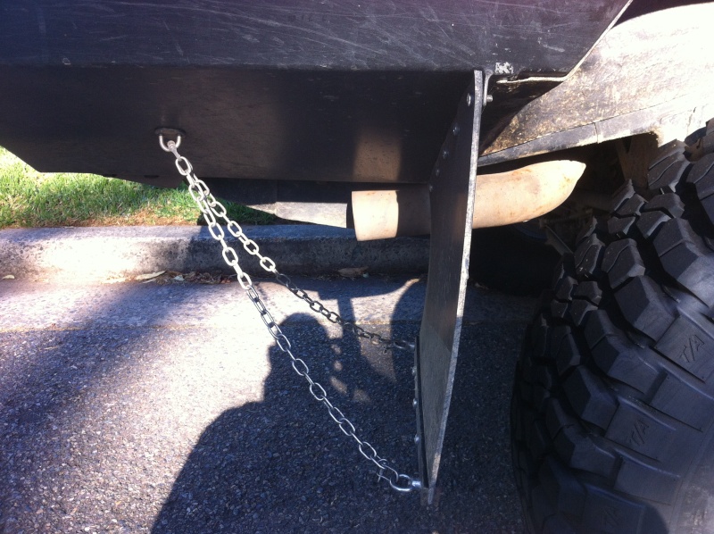

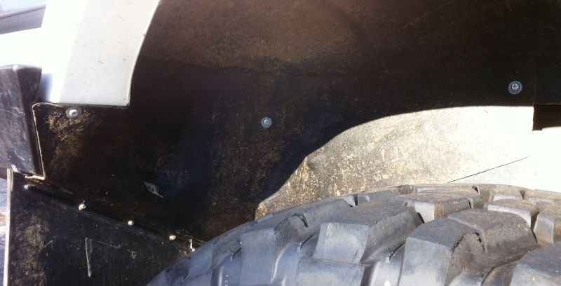

I wanted to do as much as possible in stopping the mud caking the wheel arches and getting into places that make cleaning / removal difficult. I considered screwing rubber sheeting in but that was going to look too untidy. I like the occasional fiberglass job and knew the finished product would be neat, strong and removable. I don't have any progress pics, but I just used several layers of masking tape to bridge the gaps between any voids. I then sprayed the whole lot in a mold release and applied 2 layers of matting. Once dry, I applied another 4-6 layers before leaving it to fully dry. I then carefully removed it, trimmed it to size (it's better to make it a little bigger and cut back after as it gives you a neater, thicker edge) and tidied up any irregularities and imperfections, before giving them a couple of coats of body deadener and reinstalling and fixing off with some self tappers.
This is the DS rear. I made it overlap under the side wings to keep as much crap out as possible. I also ran it out to the edge for the same reason.
This is the PS rear. Note how it also extends right up the top to protect the fuel filler as one piece. I left the factory plastic guard in place and taped over it before applying the fiberglass. Once complete, the OEM unit got binned and the fiberglass cover fixed into position. I will soon be making another fiberglass section to fill in the opening of the forward area of the rear wheel. This will overlap the rear panel just a little.
Here, you can see how I've wrapped the fiberglass under to but into the face of the mudflap.
This is the finished clearance around the rear quarters, about 12mm. Because the side wings are tied back to the chassis, they are super stiff and will require a fair belt before it hits the panel. If I drove like I use to, I'd have allowed a little more clearance :D You'll notice I also brought the side-wings outside and past the flare. Every rear flare I've torn off in the bush as been because it got hit on the inside edge. The intention is this will go some way to deflecting the offending branch or rock face.
The mudflaps are a fiber reinforced rubber - not cheap but it wont tear. I bought a 1m sheet, cut them slightly larger than needed, punched a series of holes in the top of the flap and fixed them by drilling and tapping the angle. (I am yet to make a sandwich plate to go over the face of the mudflap for better holding/clamping pressure) Once both were in position, I trimmed them to suit. They are held off the back of the tyre with stainless steel chain and a few eyelets. I used stainless so it wouldn't rust and it also doesn't rattle like mild steel chain does. I've made them so I can quickly tie them further back in really rough terrain.
